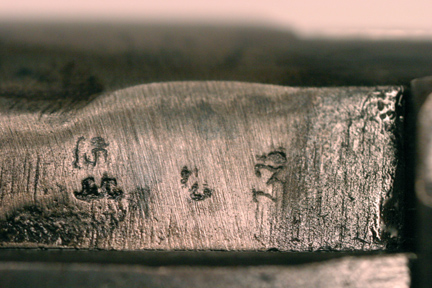

On further inspection the left side of the receiver has 3 ground out markings under the blue. I'll try to take some photo's of them.
Why would anyone grind out the acceptance stamps and proofs when the serial numbers are left 100% original?

Mark, The 3 ground down proofs on the LEFT receiver, would indicate to me that it once was a first issue (1908 or 9) DWM military. The 16b serial would place it in 1909, and the matching frame, if original, should be without stock lug. The Imperial accepted (Crown over a letter) sear and hold open, would suggest Erfurt production. The 2 digits ON the receiver lug, are serials during this period, not inspector marks. Sounds like a "Frankenluger" shooter to me, particularly the white Franzite (should be marked inside) bottom on the mag. TH

Here are the photos of the ground off stamps. Can you tell what they are? Does anyone have a theory as to why this was done?

The remnant of the proofs are what would be expected on a 1908 1st issue .The first proof (left) would be a 1908 Dwm eagle proof, the second would be a Crown over a letter, The third a Crown 3. I have these same proofs on a 1st issue. Bill
Unread 10-01-2006, 11:28 PM   #10
Actually, the third is a Crown/Z with a smaller crown overstamped and 100% correct for a 1908 First Issue. It is a shame that it was effaced. The removal is very crude and possibly an attempt to conceal it was a military weapon. Enjoy your "Frankenluger", it had a noble past.
