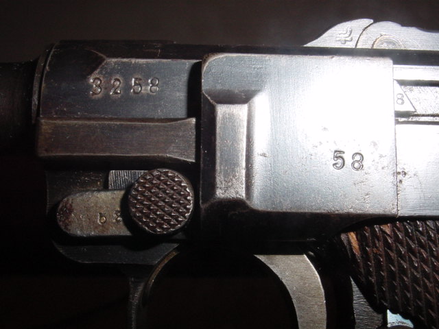

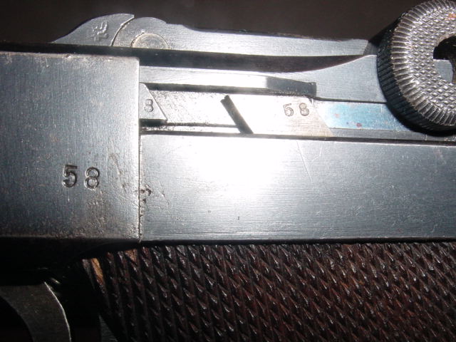

Can anyone help me with an I.D. For this. Thanks, Sean.....

Sean... can we see more of this gun. The number alone is not enough for a good judgement of the unit mark. It could be virtually any service... but the other marks should tell more of the story. BTW, are you gonna be around Winchester for lunch tomorrow?

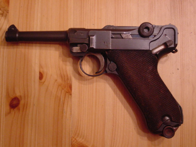

If you look in the "new collectors forum" in the "i need help" entry. All the pix of the gun are there. Thanks. Sean.....

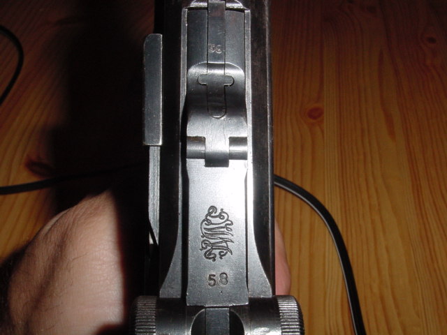

Sean,
Don't believe it's a unit mark, but rather a rack number. Unit marks are found on the front grip strap, back grip strap, once in a while the side panel or even the chamber top.

Ron, so you are saying that it does not have a unit mark. Why? Was that normal? So i guess I can tell very little history from these markings. Is this true?

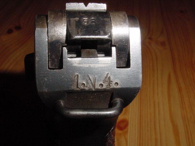

Sean,
I didn't see any marks in your photos other than the 1.N.4 on the rear of the frame. If this is the mark that you are referring to? Then no, it's not a unit mark. Possibly a Police or some other unit's rack number, I.D. number or inventory number.
I don't know of , nor can I find any plausible translation for this mark.
Unread 09-15-2006, 09:50 AM   #8
I would propose that the marking is located where it is and in the non standard form because it was applied as a provisional marking prior to the 1922 or 1923 Reichswehr directives. The meaning may be 1st Nachrichtenabteilung Waffen no. 4...First communications detachment, weapon four.

That's a possibility. Didn't think of a provisional marking. Good point.
Sean,
My apologies, I should have researched this a bit more thoroughly. Geo is correct. Getting drifty in my old age. I was looking for an Imperial unit mark. Didn't even consider Weimar markings.

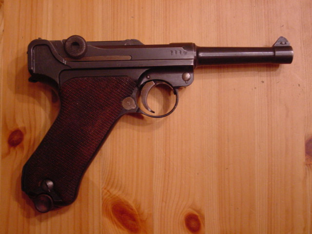

Sean, well I thought that the pistol's marking looked familiar, it's the pistol that you bought from Charlie Kaplan. A good buy.
