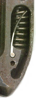

Here is a grip safety spring. Although it is pictured on a 1906 frame, it is my understanding that the spring itself is the same for a 1900.

Wayne, I did have some new repros made of these @$25 ea. TH

Dwight, correct me if I am wrong, but I was under the impression that the grip safety spring, in the model 1900 due to the flat recoil spring, was wider and didn't fit the later models with the coiled recoil spring.
Unread 09-08-2006, 10:50 AM   #8
Doc,
Don't have the experience to tell you that one, hope someone else can enlighten both of us.
