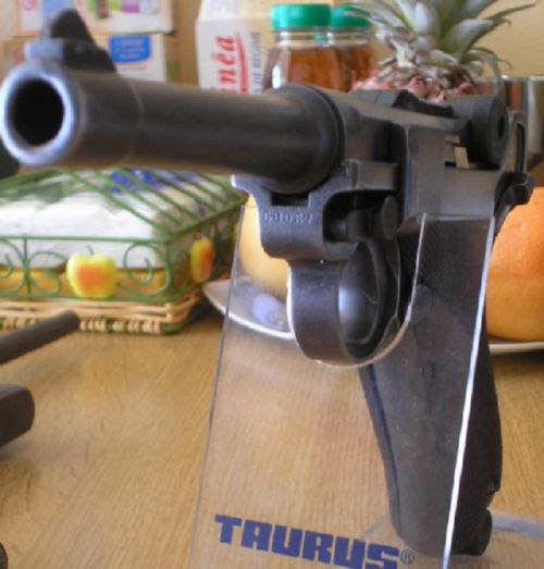

Hi guys,
Some bad pics of my 1908 commercial.
Yes, Dwight, you already know it
Never reblued - matte grey.
All number match but no # on grips, nor on wooden bottom mag.
Lazy crowned N
# 60067
German "geladen" and "gesichert"
Nothing else.
Fran�§ois

Fran�§ois, old ones are nice! Nice pineapple!

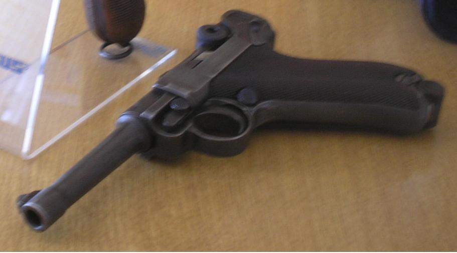

And what do you think about her sister?
Wartime commercial (1916).
All number match (even grips ) .
1920 rework mark.
oxi81 is offline   Reply With Quote

ahhh, I haven't seen very many 1920 Property marks on mausers, I assume it is because I don't collect them.

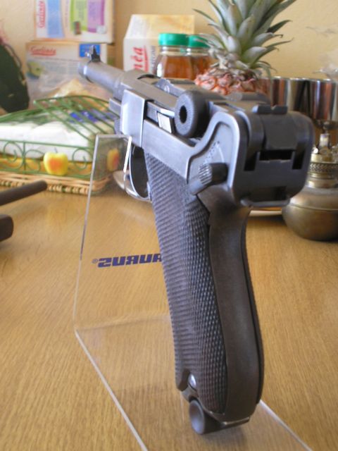

A better pic of my ol' soldier.
As you can see, no holdopen of this #60067 '08 commercial.
Fran�§ois

ahhhhh, nothing like seeing a nice luger, holster and tool against oak
