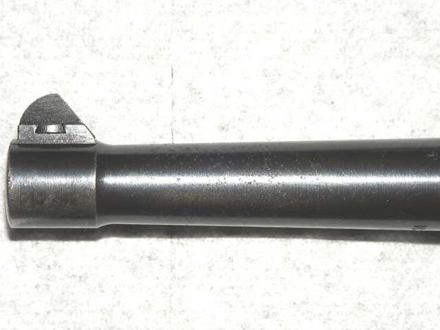

Default Severe Pitting on byf 42
The one Luger presently in my possession is marked; byf, 42, and i suffix. After field stripping and removing the grips, it appears to have matching serial numbers inside and out, except for the grips which have no markings on their inside. The only magazine is marked fxo.
The pistol had been kept, by the WW II veteran who brought it back, wrapped in an old t-shirt, not a trace of oil on the outside, but with quite a bit of dark brownish black grease on the inside. I have sprayed, soaked, and scrubbed it with a toothbrush using Birchwood/Casey gun solvent/degreaser. The bore has very clear lands and grooves, with some bluing still in the grooves. There are some traces of rust on the inside despite (or because?) of the grease that had been there. The outside of the weapon has some pitting present on just about every surface, especially on its left side (perhaps the side upon which it had laid for years) and has severe pitting on the left side and top of the barrel.
Without family permission or budget to allow anyone else to work on the pistol's restoration, I have to do what I can on my own. However, even after reading many past postings on this forum, I am uncertain as to what to do next. I do have permission to shoot the pistol, but now I'm uncertain if that is advisable.

WD40 and 0000 steel wool will clean up the rusting somewhat without harming the bluing.

Herb,
That is not really "severe pitting", more like advanced freckling, but Hugh is right that it should be addressed to avoid getting worse. If it is all over the gun I'm sure it is annoying, and it certainly affects this gun's value to a collector.
That being the case, be sure to take it to the range and shoot it. As you will see by the number of posts by those of us who shoot Lugers, they are accurate as heck and a great deal of fun.

Dwight,
I'm not use to having to deal with pitting or freckling on firearms in years. I always thought that if it was deep enough to stick a pin point into it, it's a pit. Many of these on this Luger are that deep. Perhaps in this digital photo they don't appear to be as deep into the surface as they are because I used a flash. But be they pits or freckles, the pistol has been rusting away for decades, and I have to do something.
If it was a weapon of less renown, value, and not a family heirloom, I might not hesitate to go at it with Flitz polish or 0000 steel wool with WD-40. I was hoping there might be some other, more conservative, path to take towards restoration.
Once restored, I would very much like to shoot this pistol if it would be safe (Wal-Mart Winchester white box 115 gr. fmj). Though quite honestly, the last time I regularly shot firearms that were in a similar condition, I was much younger, single, and military surplus weapons and ammunition were cheap and in great abundance.

It is pitting by your definition, but it is not severe by any measure. In fact it is almost in collectable condition as it is (lots of folks would love to have one in that good of condition). The use of 0000 steel wool and gun oil will not harm the finish (unless you bear down really hard and scrub in the same spot until the blue is gone). There is no means of "restoring" this gun short of professional refinishing. However, it is is quite acceptable as it is and only needs to have the active rust in the "pits" arrested and the metal protected from further oxidation. You can't turn back the clock, what is done is done. You do "have to do something", but nothing more aggessive than what has been suggested. Good luck and enjoy shooting it.

Ron,
OK, I guess I may be guilty of some hyperbole in my very first posting in this forum. I may also be guilty of wishful thinking too. I was hoping there was some little known special technique for removing rust, and especially for cleaning it out of pitting, without endangering the original finish. Obviously this is going to be a project that requires time, patience, and finesse.
As for restoration work short of professional refinishing, I was thinking about cleaning up the wooden grips and perhaps putting some kind of white pigment into the letters of GESICHERT. That was all I was ever considering. However, after doing several searches on these topics in the excellent knowledge base here, I have more questions, and doubts too.

It is a bit upsetting to find a nice old Luger so neglected, but it could be much worse. I just had a unit marked 1914 DWM completely restored that was in "much" worse condition. Very severly pitted.
It wasn't cheap to have it done, but I couldn't stand leaving it in that condition. My way of preserving a piece of history.
Yours, as Ron says, is acceptable and not all that bad, all things considered.

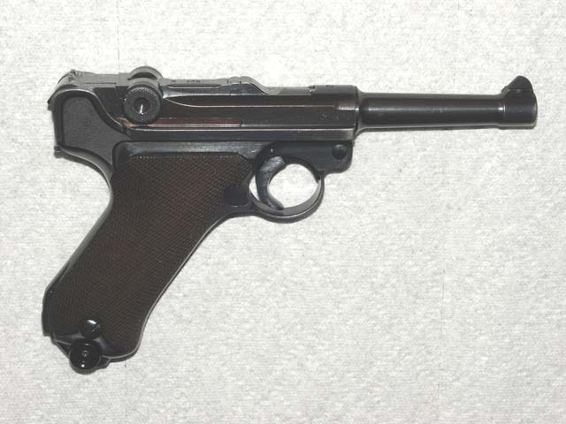

Thank you all for your comments. I've a better understanding now of what I have here for a Luger and what has to be done to it. I see it in a whole new perspective and am posting a photo of the entire pistol. Having posted its worst, here's its best side. (It shows up much darker in this photo than it is. I think it was a mistake to photographic on a white background; too much like backlighting.)

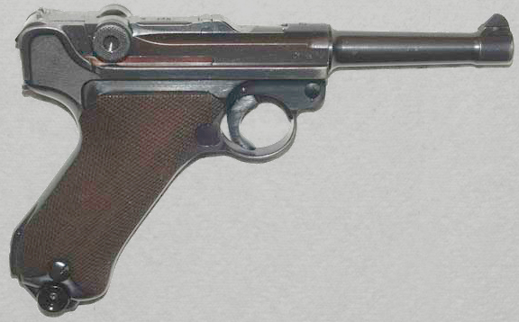

Photoshop is a marvellous thing.
And that is a rather nice Luger. Actually, I'm sure we'd all like to see the whole other side, as well.

A marvelous thing indeed! No wonder people are often asking if a photograph has been Photoshopped. You've made it look much more like it really is. The mill marks and everything seem clearer too. Here's the left side, with the action open.
