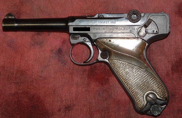

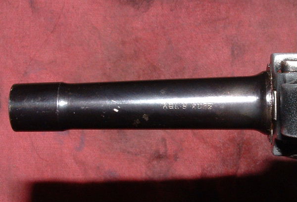

I got this from a guy and I dont know what iit is. It looks like a luger but maybe it isn't. On the left side ot has Kal 9 Kurz/.380. Then under that it has, ERMA-WERKE Mod KGP 68 A. On the right it has Excam INC, HIALEAH, FLORIDA. At least I know how to take it apart, but is it the real deal, or just a fake, worth nothing. Oh the handels are brass too. I'll try to post some pics as soon as I figure out how to on here. Ok guys thanks.

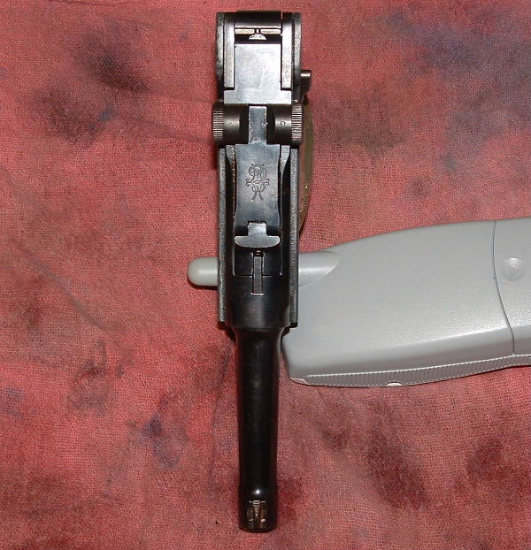

Heres some pix
I know you guys can help tell me what this is, and if its trash or not. Thanks.

Marl,
Welcome to the Lugerforum... the .380 Erma KGP 68 is a Luger look-a-like... not a Luger... but some folks like them. They haven't been made in a couple of decades... parts may be hard to come by if you break something... keep your eye on ebay for spares...
It is interesting to see the brass grips. If they are truely brass and not plastic, then those are not original, and are probably custom.

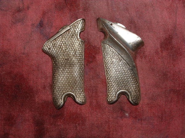

Hey thanks for the welcome. Thanks for the info too. Yea I thought the gripps were wood. They were all dull looking. So get this I kid you not. I stuck the gun in the fridge because I didnt want my wife to see it. When I went back to get it, I started whiping the frost off the gripps and they polished right up!! Brass! Learned 2 things last night. 1 the gripps are brass, 2 I didnt know you could polish brass by just freezing it for a while. Ill take some more pics and post. Even tough I havent finnished polishing them, at least you can see.

Ponyman
Join Date: Feb 2005
Location: Atlantic County, NJ, USA
Posts: 138
Hi marl, and welcome to the Forum!
It's not a Luger, although it's often mistakenly called a "baby Luger" because of the physical resemblance. But it's not a "fake", either. What it is: exactly how it is marked - an Erma KGP-68 in .380 Auto. The "A" indicates the modified model: it has a magazine safety - won't fire unless the lever in the cut-out for the left magazine knob is pushed up - required by GCA '68. It differs from the Luger in that it is not a locked-toggle action. The toggle knobs don't lift the middle axle of the toggle to release the breechblock: it's a straight blow-back action. The design was inspired by the Luger, and the original intent was to chamber it for 9mm Parabellum. But the recoil spring necessary for a blow-back in 9mm Luger makes it impossible to cycle the action by hand, so you can't chamber the first round. It won't de-**** the way a Luger will, and both the recoil and the firing pin springs get completely removed during a field-strip. The production run was 1968 to sometime in the '70s. With a 5-round mag, it's not the weapon of choice in a fire-fight - but it's a nice (and cheap) little shooter. It was also offered in 32 ACP with a 6-round mag. There is also a KGP-69 in .22 Long Rifle, with an 8-round mag - and slightly larger dimensions - which was introduced in 1969. If you'd like a pair of checkered brown plastic grips (with right-handed thumb rest) for your gun, see eBay item 7249303494 (not my item).

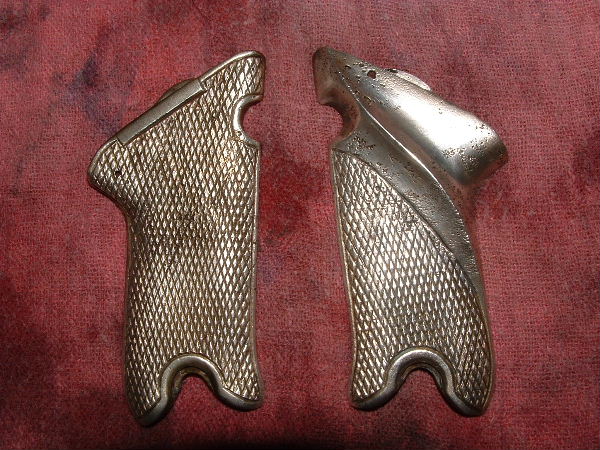

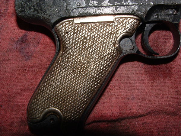

Default Brass Gripps
Here they are. Theyre going to look real nice when I polish them up.
