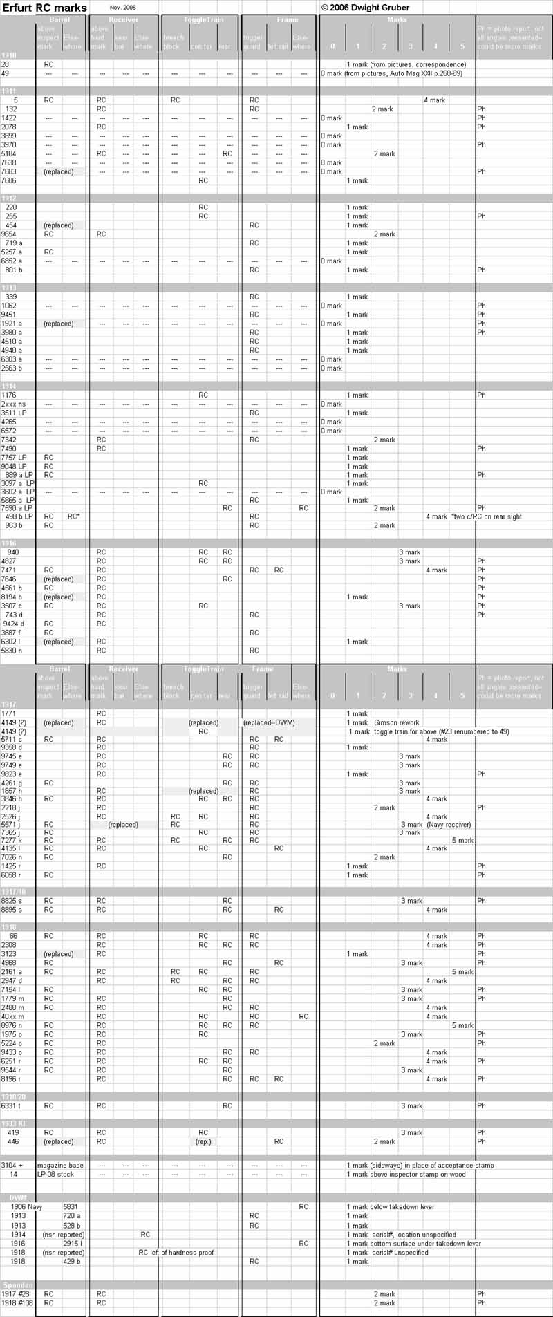

A very interesting and informative discussion about the WWI Revisions-Commission and c/RC markings on Erfurt Lugers () has reminded me of the brief attempt a year or so ago here on this Forum to survey the predominance of c/RC markings, by year, on Erfurt Lugers. The discussion has got my data juices flowing, so I am resurrecting the survey in hopes of doing a proper datbase.
There have been an number of good responses, and I have mined the Forums for data (there are a surprising number of good reports). The database is complex enough that it is easiest to snapshot the spreadsheet and present it here (current as of 6/15):
You can see the kind of data I am looking for:

I have posted the current database in a revised first post to this discussion. My thanks to everyone who has provided data so far.

There have been quite few posts and emails of c/RC details, and I have mined Imperial Lugers and Weimar Lugers for c/RC marks. This has more than doubled the data, so I have edited the top post to include the current spreadsheet. The photo notation indicates that all views were not always available for examination.
Continued thanks to everyone who has participated.

I've inserted the most current data from this survey into the first post, above. Sorry that the headers are hard to read, this is right at the limit of resolution for the maximum filesize.
Thanks again to everybody who has responded.
