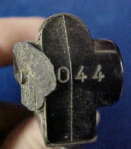

This one is running on e-Bay.
I did not know the BW magazines were numbered; but this one has a font style to the numbers that may look correct. Pantographed, perhaps ???

Default numbered BW mag
Hello to all, I'm pretty well convinced these are correct for Ku Lugers... Maybe someone has some evidence to support or discount my theory on these... Best to all, til...lat'r...GT BTW, Whoever did them, did them well!!

Also maybe police Lugers!!! I doubt they are proper for Military Mausers.

Thanks, Guys !
Too bad this one did not survive better. But it does give us a glimpse of what Bakelite looks like when cracked open...

Pete,
Pantographed for sure, note the rounded stroke ends and outside corners.

GT, I agree that the only BPB/FXO mags that were serialize were for the KU PO8s. Since this was not the normal procedure at either Mauser or KH, it again raises the question of who assembled these lugers for the LW? TH

Bakelite could never be stamped to this depth or possibly at all without cracking it... it would have to be pantographed or melted in with a hot number stamp, but this bottom shows no sign of a melt type stamping... I have to agree with Dwight... this was pantographed (rotary engraved for those than don't know the term).
