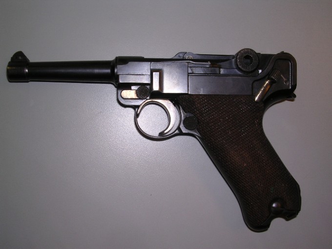

CAN ANY ONE TELL ME WHAT THIS GUN IS WORTH? MY GRANDFATHER GAVE IT TO ME. HE GOT IT IN W.W. 2 WHEN HE DROVE HITLERS TRAIN OUT OF BERLIN

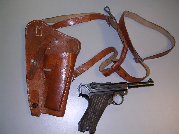

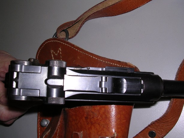

I hope these pictures work.

Serial # 4140 u
no #'s on toggle and reciever

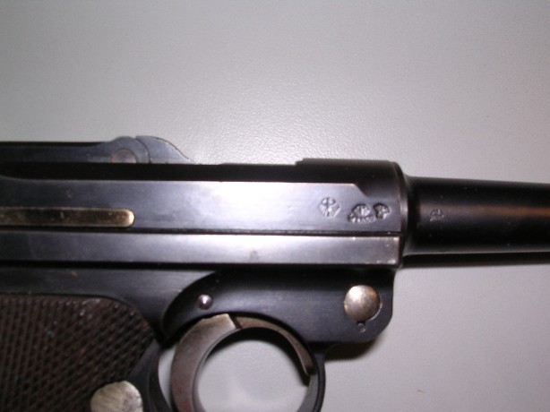

up side down eagle on barrel
part #'s 40

John, I can tell you a lot about your grandfathers luger!
It is a early mauser made in the early 1930's for the nazi's, but right at the end of the Weimar period. it has a "sear" safety added after 1932, sear safety's were only installed on "police" lugers.
It also appears to have the magazine safety, which was installed at the same time frame, but was found not to work correctly and were almost universally removed in 1937.
the blank receiver (no date) was correct for these guns. The toggle being blank, is commonly refered to as a "sneak", in the mistaken belief by collectors that the germans were hiding rearmenent from the allies, but that is likely untrue. it is better guessed that the toggle was not marked due to the switch over between DWM and Mauser...
The holster is a commercial one, or more likely a 1911A1 holster used for the luger, it is likely not one that was worn when the owner had the luger.
Value, to me is about $900-$1200.

This is a -very- nice Police Luger, congratulations on having an interesting example. Is there any chance of getting to see the marks under the barrel and the front of the frame? also a good sharp closeup of the right receiver marks?

Your Luger, sn 4140u, was manufactured by DWM (BKIW) in about 1929. Most went to the Prussian State Police. See link below for additional information.
