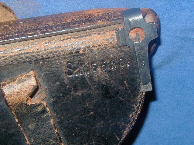

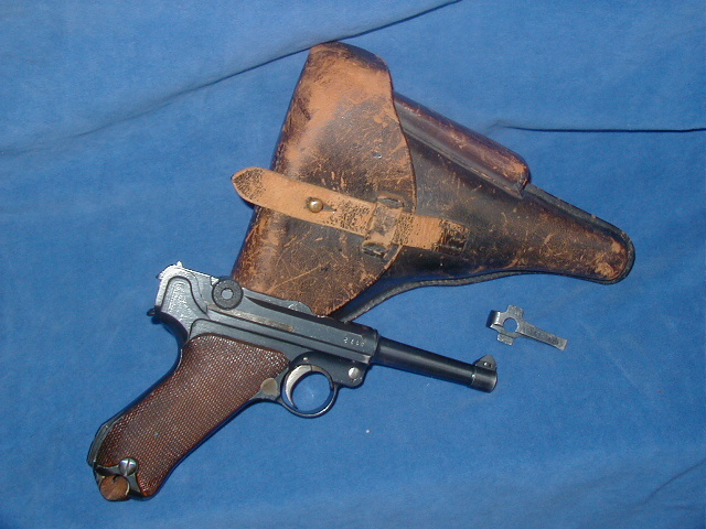

Will describe later. Trying to upload photos Well I got one photo to go, email me for holster markings and other photos. This 9mm Luger has 90% original finish and the checkering is so sharp it feels like it is going to cut your palm. It has a wings and head down eagle above 3114 which is above 8.83. All numbers match and 1920 is above 1918. In addition to matching serial number on all parts it also has S.B.W.I.R. 378 5528 on the inside frame with WIR378 being X'ed out. The takedown tool has 5528. The back of the holster has S.B.5528. in the back upper right cornor. Also on the upper back of the holster is FRANZ COBAU above 1933 above what resembles a mum with an L in the center. As you can see alot of the shinny black is off the holster showing the natural leather. Should I do anything to it or leave as is? What do the markings mean? I'm 68 and have had 5 or 6 Lugers from Vets and estates over the years, but due to large family had to sell them. This is the first time I've been in a position to keep one, as it took me 3 years to talk the old guy into selling it to me I'd like to know all about it. Thanking you all in advance.

Your pistol is a Berlin Police pistol. The markings on the gripstrap indicate that it was issued to the Schutzpolizei of Berlin, West...which is Charlottenberg. I am a retired policeman and I have been in that particular Charlottenberg police station in Berlin (not far from the Ku-damm). Your luger is stamped according to the 1922 Prussian Police regulations and the markings indicate the luger belonged to a reserve unit of the Ist Hundertschaft and the marking was subsequently changed when the reserve was eliminated (according to the Xed out characters). Your matching holster is also marked to the Berlin Polizei. A very nice rig.

Was made in 1918 by DWM, then in 1920 it was property amrked (not a date stamping) by the reichswehr to show it was gov't property. Then at some point it was turned over to the police and if it has a sear safety it was added in 1932.
The 8,83 is the land to land measurement of the bore btw.
NICE rig, being marked on the holster, weapon and tool is very nice, i have a couple like that, but it is not common to find.

I really appreciate the info. Was it a policemans during the 1920's, or does the Franz Cobau 1933 on the holster (I can send you other photos ) show the Police Dept got it in 1933? Thanks again Richard suwanneetrader@hotmail.com

That is hard to say. You are welcome to send as many and as large of photos as you want to weimar_lugers@comcast.net
My "feeling" is that the holster was mated up in that time frame, and as you said, at the same time frame, the pistol probably came out of storage as it was turned over to the police, was mated up and both marked.

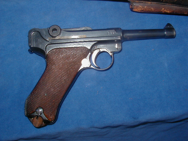

Here is the other side of the DWM 1918 shown in other post. Thanks for looking and telling me about it. From this view can you tell if a sear safety was added? Those are not pits but lint in the oil that I wiped it off. Also light places are for the most part from the camera flash.

Yes, it has a sear safety, you can just see the top of it in the photo.
See the photo where I made the arrows. It is the dog-leg piece of metal from right to left, to the top of the sideplate. It almost appears to have had a mag safety too...

I will try to download your info.later as I'm working today trying to kill chinchbugs in my yard, but as I'm so thankful for so many considerate answers I'll upload those markings now. Richard

When you read the article, you will see why I think your gun was marked in at least three stages: W.I.R.378.; S.B.W.I.R.378. and S.B.5528.

Since it's your holster, you can do whatever you want to it. I think, however, that most would advise leather treatment to keep it supple, but no color. Its condition is part of its history, and it's only original once.

Values are all over the place, but I would insure the kit (pistol, holster and tool) for at least $2,500. The holster and tool are important and they appear to be proper for the gun. I'm also assuming the magazine is not matching.
I went to a trusted gun smith to get my firearms appraised, recently, so that I could insure them. His values were conservative, but based on good research and some recent resales. He did not consider provenance or accessories.
Auctions are never good comparisons and they all have a lot of high handling fees on top of the sale price.
You can easily search for "dual date police luger" and find them from $2,000 - $3,000.

I'm making a lot of assumptions about your Luger - that it's in working order, that the internal parts are correct, that the barrel is clean and still has visible rifling, etc. But, in general, the gun alone in good condition would easily sell for $1,500. Most people add 20% for a matching holster and tool.
I would suggest that Luger prices have almost doubled in 15 years.
