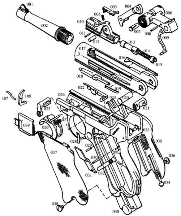

In the â??technical informationâ?, â??parts list and disassemblyâ? page, the numbering system on the parts list does not match the numbering system on the disassembly illustration. Is there any way we can get these to match? If nothing else it would make things easier for us Luger newbies.

not easily, they are taken from two different manuals.
Now, if someone blows them way up and manually marks over and then changes them, I am sure that John would post the updated chart...

I will give it a first attempt tonight. As a Luger newbie it will be interesting to see what I come up with.

I decided that it was easier to change the parts list to match the illustration since the parts list included small parts that are not illustrated, such as a magazine breakdown, and disconnecter parts. When I find time, I will attempt to add these sub assemblies to the illustration.
Here is the current list:
001 Front sight
002 Barrel
003 Extractor
004 Forward link of toggle joint
005 Extractor spring
006 Rear link of toggle joint
007 Connecting pin between forward and rear link
008 Coupling link for recoil spring pin
009 Coupling link for recoil spring
010 Breechblock
011 Extractor pin or rivet
012 Connecting pin between breechblock and forward link
013 Firing pin
014 Firing pin spring
015 Breechblock end piece
016 Ejector
017 Receiver or barrel extension
018 Trigger bar or sear
019 Trigger bar or sear spring
020 Connecting pin between rear link and receiver
021 Magazine holder catch
022 Breechblock catch link or holdopen
023 Recoil spring lever
024 Frame
025 Locking bolt
026 Trigger
027 Trigger spring
028 Magazine holder catch spring
029 Safety catch or thumb safety lever pin
030 Recoil spring lever pin
031 Safety sear
032 Safety catch or thumb safety lever
033 Recoil spring
034 Recoil spring lever bar
035 right grip
036 grip screw right
037 left grip
038 grip screw left
039 Trigger plate, trigger cover plate or side plate
040 Magazine
107 Trigger lever pin
108 Trigger lever
I did increased the resolution of the exploded view, increased the size by 30%, then changed the contrast to sharpen the image so that it looks better at the size presented on the site.
Here is the image.
http://forum.lugerforum.com/lfupload/luger_copy3.jpg
