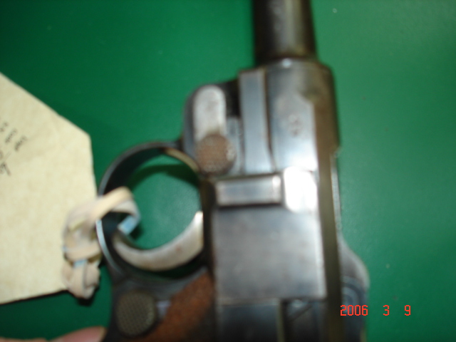

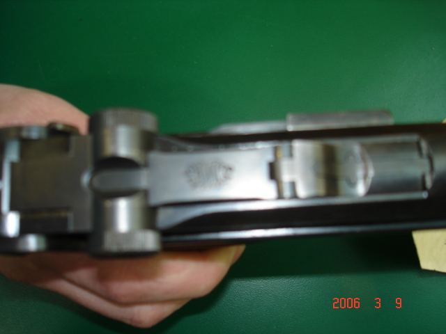

I'm looking at a DWM and what appears to be a crown over an M or N stamped on the left side of the receiver( laying down). There is no date on the receiver. All numbers match except the magazine. Safety is marked "Geischert". Some light pitting on grip, one side has a gouge out of wood, not deep but obvious. Some pitting on left side of receiver, excellent on the right side. Knowing a picture is worth a K of words, what is even a ball park price? Oh, 9mm ,rifling is fair.

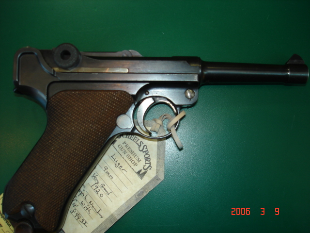

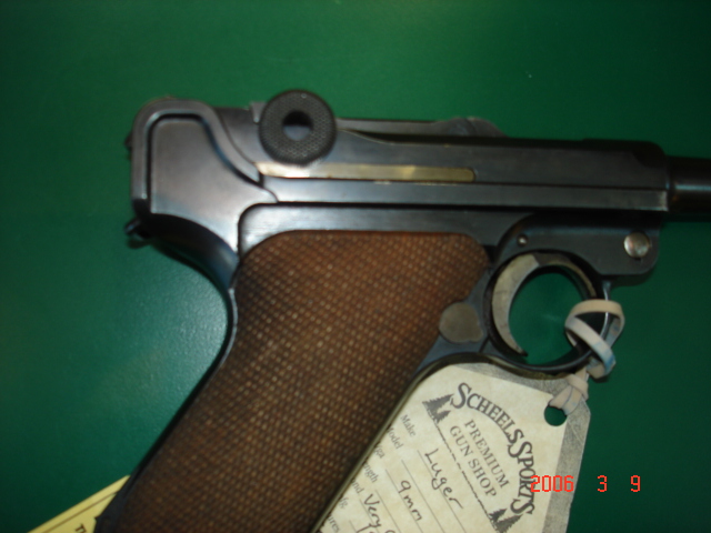

Does yours look like this one...this is a 1908 DWM commercial :

Yes, but overall, not quite as nice as the one in picture.. Well the one I'm looking at, right side is wow, excellent, left side not bad, just ok.

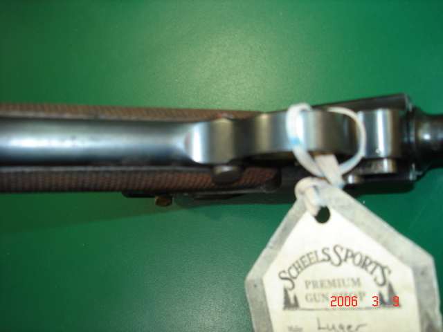

It would be useful to know if your Luger has a stock lug and a holdopen, in order to determine whether it is a 1908 or a 1914 Commercial model. Also, for the database I am keeping on the DWM commercial number series, could you please let us know the full serial number? Thanks much.

There is a stock lug. The sn is 5 digits. I now have pix but the quality is poor except for some distant shots. Right now, pix don't show sn good enough to read.

The seller states this luger is a 1920 commercial. They rate it as "very good".
Assuming the info is correct, what would you value the pistol at?

Seller's price tag of $ 849 seems like a fair price.
Is it 9 mm or 7.65 mm ? Tag says 9 mm and barrel profile looks like it as well...

The horizontal ("lazy") c/N, stock lug, and 5-digit serial number identifies this gun as a 1914 Commercial (I -really- wish you had provided the serial number).
DWM made these guns from 1914 to approximately the end of WWI in 1918. They are found in the commercial serial number range from approximately 70491 to approximately 76071. There are several different commercial variations salted into this range, so there are not nearly as many of these guns as the numbers suggest.
Bill Reupke (Auto Mag, 11/05) has suggested the existence of a sub-variation he has named 1916 Commercial, which has the relieved sear bar this pistol shows, characteristic of Lugers made after the middle of 1916 when the sear modification went into effect. Serial numbers of this variation begin about 74900 (Reupke, ibid.) It would be interesting to know if there is a small P stamped on the frame between the trigger guard and serial number; it is -crucial- to know the serial number itself.
This is a very uncommon and desirable Luger. The only mediating factor to its value (if the finish is original) is that not many collectors specialize in commercial Lugers, and so there is not much demand for the supply.
This gun offers the potential to help better understand the late-war commercial production of Lugers, and if you buy it I hope you will post high-quality, detailed photos of its characteristics.

It's not a reblued pistol. There are no other markings by the sn. I will try to get better pictures.
