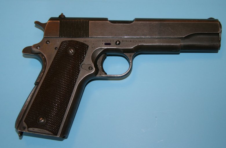

No, its gone forever, this morning this was in the trash;

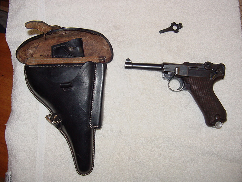

I finally got the pictures done.
Please let me know what you guys think of the Luger.
I hope I didn't attach too many pictures
