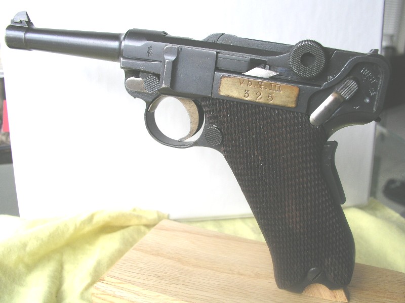

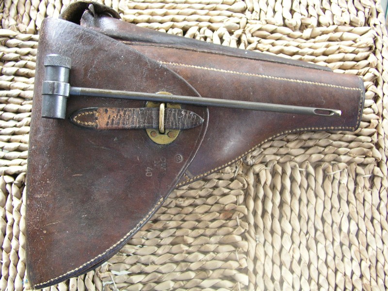

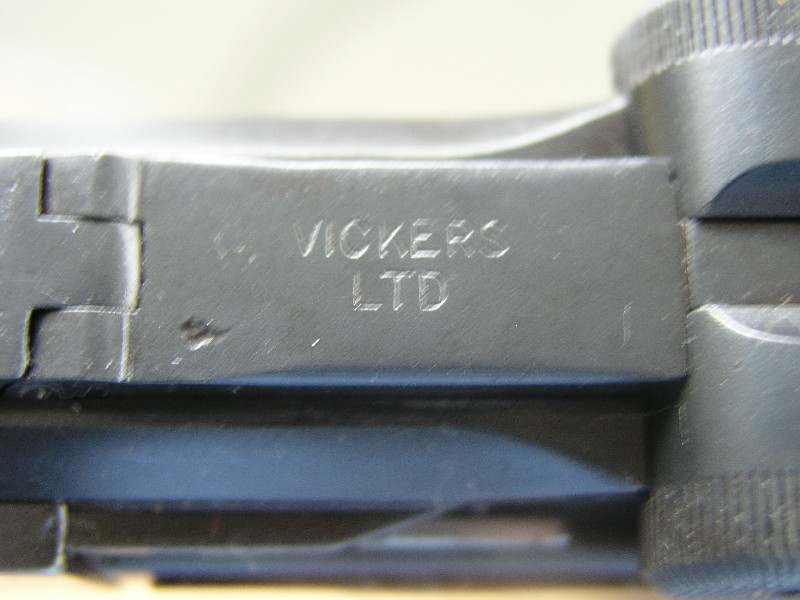

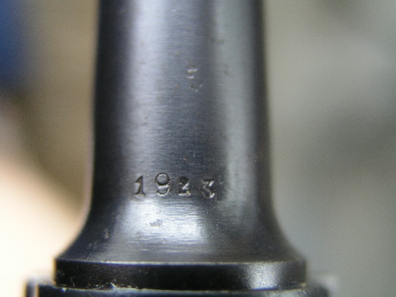

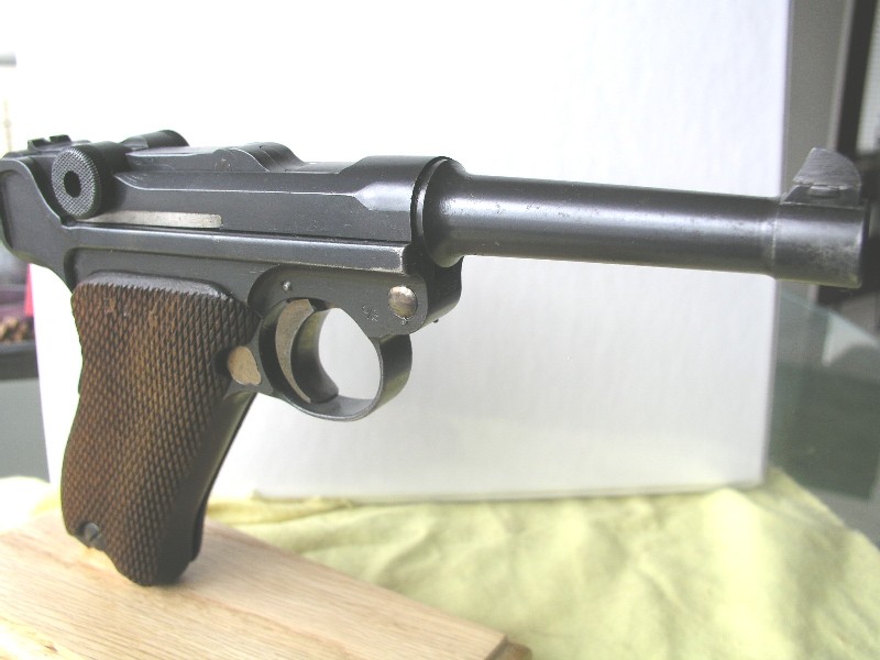

I just purchased this completely matching Dutch Luger Rig last weekend at the Houston Gun Collectors Show. It came from a WWII vet that had the gun the entire time. When I got the gun, it was full of cosmoline (spell?) and it even had sand inside the gun and between the parts. After a good cleaning with biodegradable oil, the gun looked fantastic. The holster is in pretty good shape and it comes with the oiler/cleaning rod. How would you price this rig? I included pics for your review.

Tony This is the best Vickers I have ever seen. Generally they are in pretty bad shape from long useage in a terrible climate. I am assuming this is all matching and in original condition . At least the bluing looks original and the grips are the correct course type made in the Indies. As to value I shouldn't even guess but I would say in excess of $3000. I am sure others will have differing opinions. Very very nice Vickers. A keeper. Bill
Old 01-28-2006, 09:53 PM   #5
Thanks: 1,119

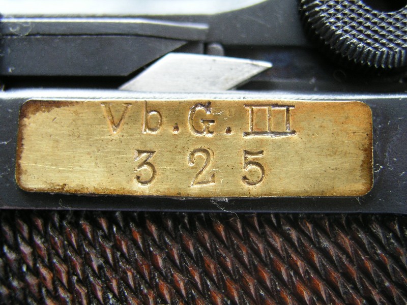

Nice find Tony! Vickers are tough Lugers to find in decent condition and yours appears to be a well preserved arsenal rework (1923). The holster is also difficult to find and is a great acquisition. The unit is the Communications Company, 3rd Battalion Engineers.

Tony, I echo Bill's and Ron's accolades. Fantastic Vickers! Did the vet who brought it back get it from the South Pacific theater? I would presume so. Would like to see the bottom of the magazine to ascertain if it is the Dutch type with the tab to remove the mag bottom. Also, I think Bill is conservative with his estimate. This high end Vickers is worth $3.5-$4K, in my opinion. One recently sold on Simpson's site in this range. The holster alone is worth $1K. I hope you got this great rig for a good price.

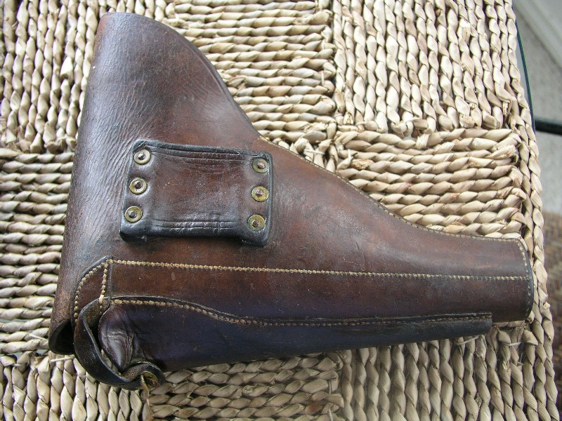

The magazine it had does not have the tab, it is a commercial wood bottom magazine with Germany written on the bottom. The gun is completely matching in and out. The grips are properly numbered with a mark (a couple of letters inside an oval). I would have to check them again to make sure. Thanks for the accolades and quick responses.

Hi Tony,

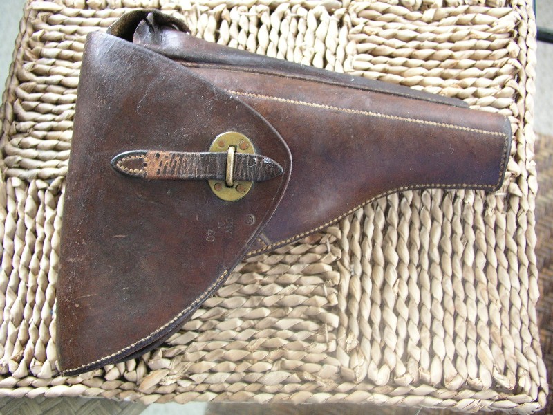

Really nice score...that holster alone would bring $ 1200 or more. Also the Dutch cleaning rod is very rare and desirable...
The letters inside the oval on your grips are probably "GS"...
Congratulations !

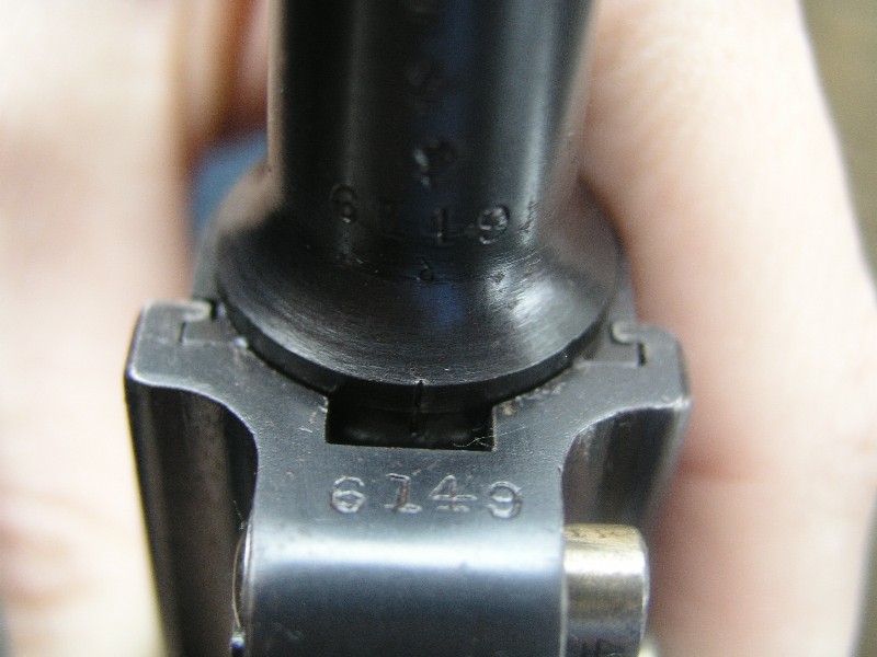

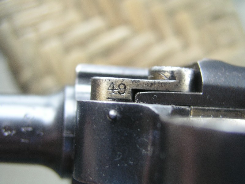

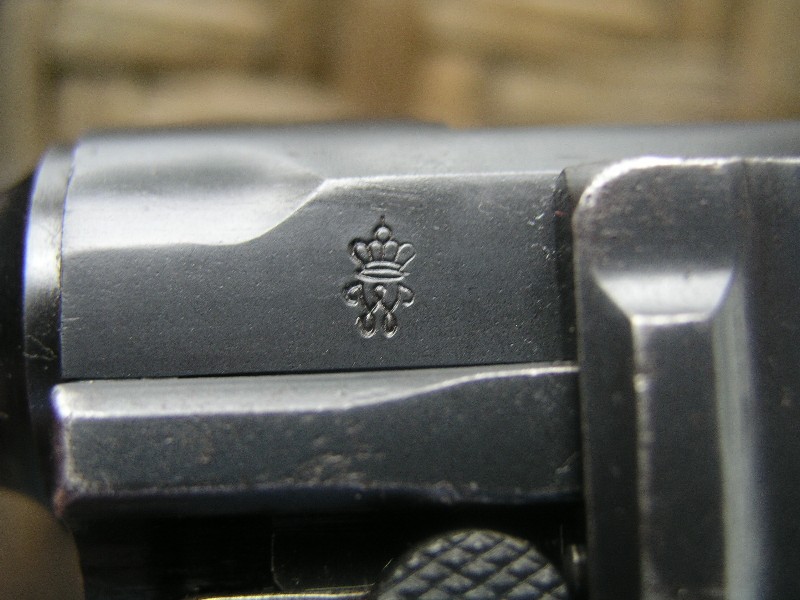

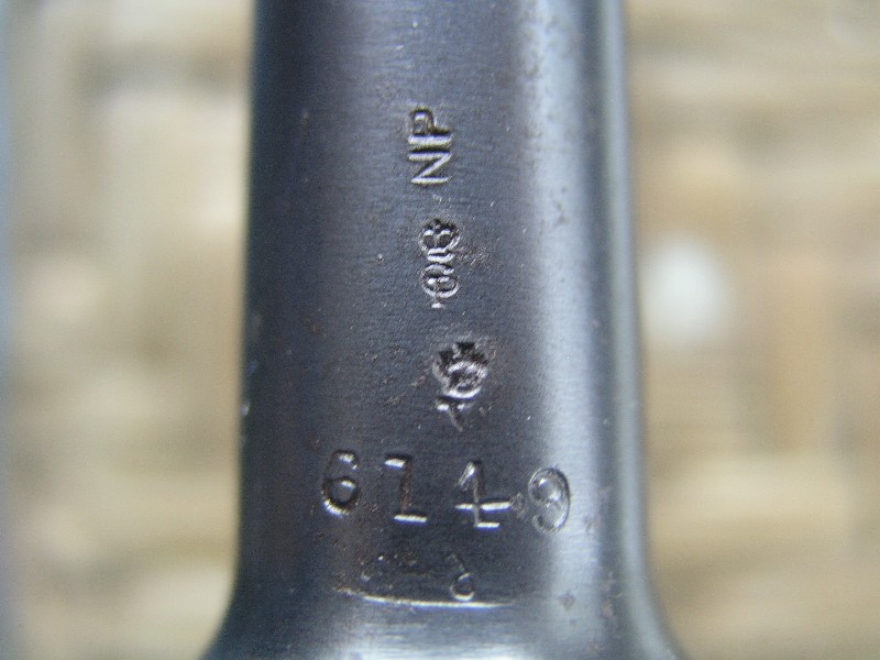

I can only repeat others' comments here that a nicer Vickers will not be found. I will suggest that this is likely to be the gun's original finish. Bas Martens (correspondence) has mentioned his belief that the barrel date is not necessarily a rebarrel date (as in The Dutch Luger) or a rework date, but was stamped the year the Luger entered service. I believe I detect halo around the barrel date, indicating stamping after blue; there also appears to be halo around the British barrel proofs.
I think you will find it well worth your while to track down a Dutch magazine for this ensemble. As far as value is concerned, I have little argument with the highest numbers suggested upscreen, except that they may be a bit too low.

The pistol was issued to the 3rd Engineers batallion of the communications company. 'Verbindingscompagnie 3e bataljon genietroepen'. Coming from a US veteran, I expect that some Japanese soldier laid his hands on this pistol first.
I sincerely doubt that the barrel date signifies a service date, as I have seen a number of Dutch lugers without the date, including my own which was delivered in 1928, barrel has crown/N proof and serial number, and no barrel date. The pistol was probably just fixed or overhauled in 1923.

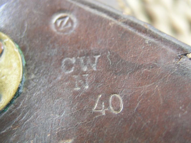

Tony,
Indeed a superb Vickers... It must have been kept in a drawer most of its live, and I probably know why. During my military service (1962-63) I was enlisted in the Dutch Signal Corps (Verbindingsdienst). We were supposed to take care of the connections between the staff and the field. Day and night sitting in a big cabin, mounted on a truck, with a noisy generator outside. I belonged to the last shift to use morse. The big transmitter was a BCC625 - we used it also to heat our coffee on.
Practising shooting? No sir, no time. Just the obligatory 20 rounds a month. So the signal corps in the Indies, 25 years earlier, might have 'enjoyed' the same monotone deskwork. Your Vickers is the proof of that.
The holster is very rare indeed. Stamps show that is was made in 1940 by the 'Centrale Winkel' (central workshop) in Batavia, the 'z' stamp means it was newly made then, not a repair job. The value is more than 1K - with the cleaning rod / oiler it would go here at 1.5K...
One of the best Dutch rigs I ever saw.
