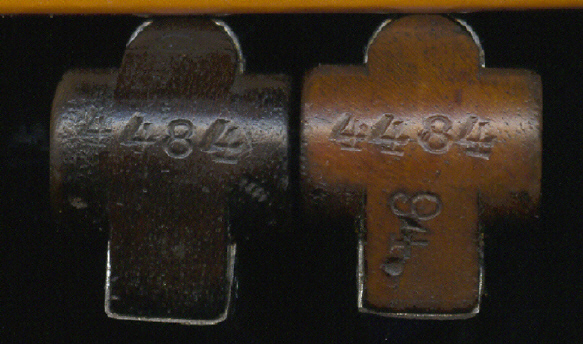

Hello,
I purchased this Luger a couple of months ago here in Finland. It is 1920 commercial Finnish contract model with original blue at 97%. The caliber is 7,65 mm and the S/N of this all-matching pistol is 4484s. Please advice if the two magazines supplied with the gun numbered 4484 are correct for this era (1929)? Thank you for your help !

Hello Juhani -
Very nice Luger . . . . . . . and all matching! Congratulations.
I believe all, or almost all, of the Finnish contract Parabellums were originally the variation that Jan Still refers to as "Alphabet Commercials" having a 4 digit + alpha character as a serial number. You can do a search on this forum for "Alpahbet Commercial" for additional information on this version.
Dwight is probably the expert on this type of Luger, but I believe that they left Germany with unmarked wood-bottom magazines. The size and shape of the numbers on your mag bottoms are not consistent with markings on earlier Imperial Lugers. It would be my guess that the magazines were numbered in Finland.

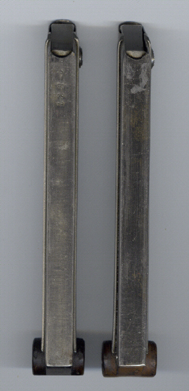

Juhani,
Luke's judgement is kind but questionable in my case, however he is right about the magazines. The extra 9-something on the base of one of them is interesting, as is the spine marking. Neither of these features are expected on a Luger magazine.

Hello,
I bought the pistol as a complete rig. Attached are some more photos.
The number in the spine of the other magazine in the rig is 1521 (crossed over).

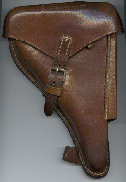

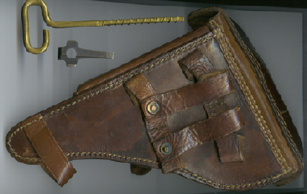

Juhani,
The holster is very interesting, too. Are the loops in the back for slipping over a shoulder stock?
Unread 01-20-2006, 07:52 PM   #6
pursihei
Join Date: Dec 2004
Location: Helsinki, Finland
Posts: 26
Thanked 3 Times in 2 Posts
Dwight,
Yes, I believe the loops are for a shoulder stock. Unfortunately it did not come with the rig.
All, the holster, the rod and the tool (German style), are without any markings.
Thank you for the interest and the rapid replies,
- Juhani

Unread 01-20-2006, 08:31 PM   #7
Luke
Luke's Avatar
Location: NC - USA
Posts: 1,239
Thanked 19 Times in 7 Posts
Juhani -
The holster appears longer than the normal German Luger holster. Could this holster have been used for a Finnish Parabellum with the 120mm Tikkakoski barrel?
Thanks,
Luke

Unread 01-21-2006, 06:17 AM   #8
pursihei
Join Date: Dec 2004
Posts: 26
Luke,
It is actually the same lenght as my other holsters for 4" barrelled Lugers. The picture may be slightly distorted, I took it with my scanner and the holster was a close fit.
But actually I do own a Luger holster which is about 2 cm longer than normally and was used by the Finnish Army. It is marked "Frost & J�¤hnel Breslau 1938 WaA182", so it is German made before WWII.
- Juhani

Unread 01-22-2006, 11:58 AM   #9
Juhani, The numbering on your mags is typical of that used by the German police during the Weimar era. The same style holster, but a bit longer, was also used by the Finns for the Lahti and/or the Tikka 5" rebarreled 9mm PO8s. TH
