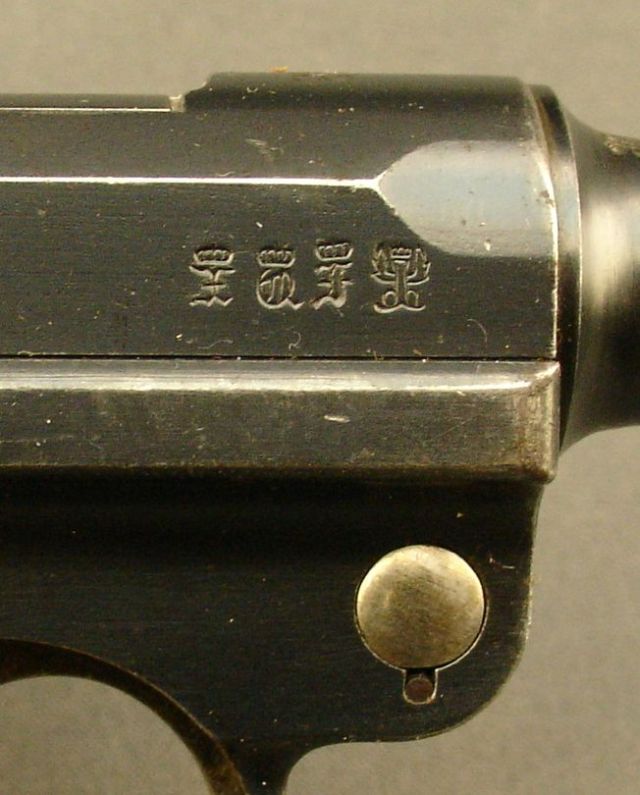

Received several questions from beginning luger nuts about what is meant by "patina under the bluing"...
Here is a good photo from Joe Salter's web site showing this feature that old lugers should display (to some extent) :

Pete, I would call the example in your photo "light scattered pitting" or in some cases "dings" rather than patina. When I think of patina (microscopic pitting) I think more of the typical "frosted" grip strap. TH

Depending on the monitor that your computer system has, photos such as the one that Pete posted do not always display the effect that it is intended to illustrate. True â??patinaâ? is difficult to photograph and more difficult to show on a computer screen. I have a high resolution graphics monitor, so many times I will be able to observe markings or features on Lugers that are posted that other Forum members say they cannot see.
Peteâ??s photo comes pretty close to illustrating patina accurately but not entirely. Patina is the brown undertone that shows up in an old rust blue finish.

As Ron notes, the effect of this "after rusting" can be brought out when doing an in person investigation by using a small maglight flashlight held at a low angle to the surface. Always take a double A maglight with you to gunshows. You can get educated pretty quickly. Also be aware that although the absence of patina can be strong evidence that a pistol is not old, the presence of patina beneath the blue is NOT proof that the bluing is original. It can be produced.
