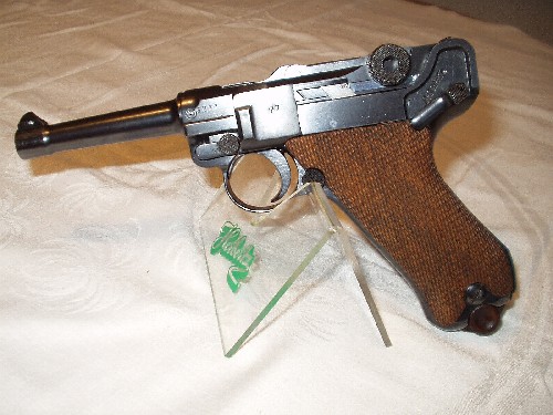

Hello Mr. Gruber. I bought last week another Luger ( a Double Date 1917/1920 DWM in mint condition, all numbers matching incl. mag ) and ir has a circle-s. Do you have a clue, what it means? Please take a look at the pic. Greetings from Germany, Thomas

Unread 02-02-2007, 03:24 PM   #15
In addition to the discussion in this topic, folks over on Jan Still's Gun Boards have been running a similar discussion with a few more ideas there as well :
http://luger.gunboards.com/topic.asp?TOPIC_ID=2763
Unread 02-02-2007, 03:50 PM   #16
Thomas,
Greetings from the US, and thanks for the picture. No, at this point the c-S meaning is obscure. It does seem to be limited to before 1922, it does not appear to have any connection with Simson, and it has a strong correlation with back-frame numbered Lugers. Keep looking here, around the end of the month I will have an article to post about this topic which will have more details, if not an actual answer to the mystery.
In the meantime, for my research, could you please look at the first post in this discussion, and provide the information which you did not mention in your post? I will be very appreciative.

Dwight,
here are the informations about my c-s Luger:
Toggle Mark (logo): DWM
Chamber Date: 1917 / 1920
1920 proberty Mark: Yes
SN with suffix: 5977 h
Right Receiver Marks: 3 x Imperial Marks 1 x Weimar Mark
Left Receiver Marks if diff.: No
C-S Position: In front of SN
Rear frame number: None
Barrel Marks: SN 5977, Imperial Mark, 8,82
PT/PTV stamp on barrel: No
Sear Safety: No
Magazine Safety: Yes
Grip Markings: Imperial Mark and 77 on both Grips
Unit Marks: None
Any other stamps: No
Magazin: Is matching, Imperial Mark and 5977
So, I hope that will help. If you need further informations, no problem.
By the way, Prize was 680 Euro.
Kind regards, Thomas

Unread 02-03-2007, 01:58 PM   #18
Thomas,
Thanks very much for your information, and I appreciate the offer of more.
Could you please confirm that this gun has a magazine safety? It does not appear so from your picture, and it would be very unusual for a Luger to have a mag safety but no sear safety. Is it possible that the receiver was drilled and the trigger plate was cut for the sear safety, but the safety itself was removed?
Also, is it possible for you to post a closeup picture of the left side of the receiver for the c-S mark, and the right side fot the Weimar mark?
Thanks for the additional help. I don't know what Luger prices are like in Germany, but equivalent $880 USD for a matching Luger with original grips and matching mag, even if reblued, is a pretty good deal here.

you are right, it was my fault. It has NO MAGAZINE SAFETY!!!! Iam sorry for the confusion, but Iam at work, doing three things at the same time and answering an e-mail. I send you the pics as soon as possible.
Thomas
