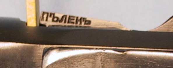

The extractor is Bulgarian, not Russian. Still scarce, but not as rare as a Russian extractor.

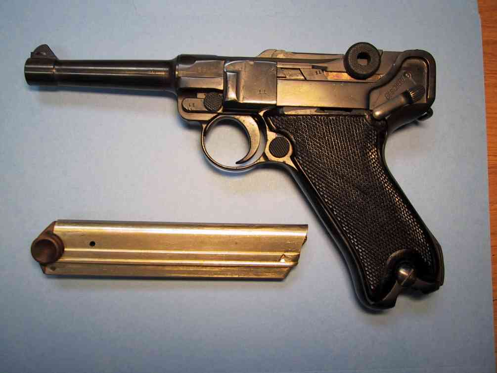

Looks like a very nice clip and with pictures of other siide and bottom would help here, but looks to be in the $125 range due to such nice condition, grips need a better look at...what color are they, looks a bit red to me and may just turn out to be better then expected, extractor is right on and needs to go on ebay for best price, simply put a little down ward pressure on the extractor top, on side take a small pin punch and drift out, may need to turn on side on a soft wood working block and drift out that way....you have got a diamond here, and what proof marks are on the inside of the grips, thanks for pic.

Thanks for the look at the pictures, I really appreciate an informed opinion.
The Mag:
The pictured side above indicates the condition of the other sides and edges. I will take more pics. The entire clip has no signs of pitting, rust or gouges. The follower is machined and is plated (Nickel?) The spring is clean and shiny, the checkered thumb slide button has some small signs of rust. The inside looks clean and shiny - not polished clean, but well kept over years. 9911 is lightly etched by hand with possibly one of those vibrating scribe tools. The wooden plug is in very good shape, and has a stamp mark on the bottom surface towards the end with the pin. It looks very similar to the first (most rearward) stamp on the side of the receiver. The crown has two "tufts" and the tilde ~ under it are almost the same, but the symbol under the tilde looks more like a C with a trapezoid on the bottom. I know it's hard to explain, but I can only see it well with a 10X loupe, I will try to photograph it but I doubt it will come clear...The stamp is the same size as the ones on the receiver.

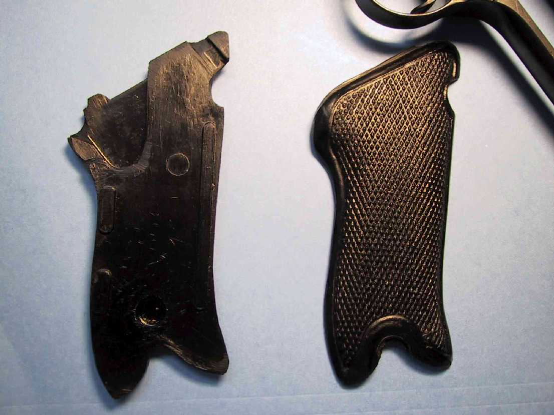

The Grips:
They are black - almost a glossy black. The outer outer rim/edge around the checkering is smooth and glossy, but seems crudely hand-molded.
They are not a fine plastic mold as one would see made today. There is also a threaded counterbore in each grip, about 3/16" deep and 3/8" diameter on the inside (see picture) . Like something is supposed to thread into these holes?
I can't find anything that looks like a stamp or proof mark. They seem very sturdy, with many sanded areas around the edges and flat inside.
There is a small chip (1/8") on the inside of the right hand grip that leads me to think Bakelight. It looks is a "true" chip, like a chip made on a rock, it is jagged and rough, not what I would expect from plastic.
The Extractor:
The extractor is Russian?
This may be good news. Is there any web info on these?

You really need a WW2 era collector to make a call on the grips, I can only caution you that they may be worth a lot more then I can appraise them at, not an area I deal in, and the extractor is way out of anything I have ever worked with, take your time with it, you got a real dandy there, and if you eBay it, open up your sales to Europen countrys, do not limit it to US sales only......I wish you the best and let me know if I can help!

I do not understand why you are asking again; "The extractor is Russian?" The extractor is not Russian, it is Bulgarian. A Russian extractor is quite rare and worth a fair amount of money. Your Bulgarian extractor is also not common and may be worth nearly 1/3 of what you paid for the whole gun, but it isn't Russian.

you have me confused by calling this a Bulgarian extractor and not a Russian extractor. While Russian characters are different from Bugarian characters, I always thought that the Germans didn't realise it either that the characters were different, so they used the same characters on the Russian extractors as they used on the Bulgarian extractors.
Wait a minute...I just looked at two extactors that I thought were Russian/Bugarian and the characters are different from Andys picture of his extractor. My extractors look something like a reverse '3', 'AP', reverse 'R', an 'unknown' symbol and a weird looking small 'b' character (just like Andys small, weird 'b'). But still, both my extractors are different from Andy's. So which is the Russian and which is the Bugarian?

This extractor is for me an Bulgarian extractor. I send you a picture from a french book. On the book you can see a bulgarian extractor, note that the caracters are the same as the extractor on the forum.

I don't think that these are original black widow grips, but another forum member has done a detailed study of them and may be able to offer a more informed opinion.
