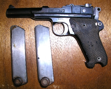

Question Help identifying this gun.
What is this gun? Looks like a cross between a M-96 and a Luger. Gun reportedly has Mauser banner markings. I am trying to help someone identify it. A rather odd looking gun.

Looks like a Chinese or Kiber Pass copy to me. The give away would be the Quality of the machine work and polish which wouldn't be very high. Bob Benson

Doug...thanks for posting the pic I sent you! Here is some detailed information on this weird duck.......
A neighbor gave me a very old Mauser pistol several days ago and for the life of me I cannot identify exactly what it is. Overall, it looks like a cross between a Luger (the frame) and a C96/Bergmann (the slide). Here are the specifics:
1. It appears to be .30 Luger caliber...but there are no caliber markings on it. I need to make a chamber cast to be sure.
2. The barrel is fully enclosed by the barrel sleeve. Also, the barrel is in the white and not blued.
3. The grip frame is very similar to a P08 Luger. Machining cuts, design, etc. are fairly close.
4. The serial number is 914xx...there is no suffix letter. Also, there is no date on it anywhere. Neither are there any proof marks, waffenamt stamps, inspection stamps, etc. However, most all of the parts are numbered with the last two digits of the serial number. Finally, all numbers - including the wood grips - match.
5. There are no import marks on it, nor is "Germany" stamped on it anywhere.
6. The two mags which come with it look similar to Luger mags, including the circular wood piece on the bottom. They are not numbered, however.
7. The front sight is adjustable for windage via drifting.
8. The rear sight is a tangent ladder style and unusually has increments in both yards (800 yds) and meters (700 m) engraved into it.
9. The two piece wood grips are also very similar to a Luger's.
10. The operating system appears to be some kind of simple blowback while the trigger system appears to be single action. I cannot detect any cam/ramp/link unlocking as the slide is retracted.
11. The standard "Mauser" name is stamped over the chamber. It appears inside an sunburst oval and is not a "banner" like I have seen on Lugers
12. The magazines appear to hold about 8 rounds.
13. The bluing on it is in excellent shape and is typical of pre-WWI type finishes...it looks first class indeed! When held at an angle to a light source you can easily detect a light reddish tint in the bluing. The numbers are perfectly clean and indicate no "dishing, dragging, etc.", which could indicate a reblue sometime in the past.
14. The firing pin is removed by pushing out a cross bolt pin from right to left. The firing pin looks similar to a Luger's and is spring loaded. However, the pin itself is much longer and thinner than the stubbier Luger pin. Also, the spring is noticeably flimsier of thinner gage wire.
Overall, after going through a number of my reference books, this pistol looks like it came from the 1898-1910 timeframe and could have been some type of early competitor to the DWM Luger (or perhaps Borchardt Luger) being produced then.
Some friends have said this could be a Chinese clone of the combined key attributes of the Luger, C96 and Bergmann, but, the workmanship and finish is simply way too fine for that theory (to me at least). If it is a Chinese clone made at the turn of the century they must have had designers and machine shops which fully equaled anything in Europe at that time.
Thanks!

The pistol is now (in my mind at least) almost certainly an Asiatic original design which took features from a number of weapons which were current at that time. The reason I say this is because it finally came apart late last night after soaking it in Kroil for two days. Old grease/oil and congealed funk had literally glued the barrel, bolt and slide together.
The insides are not near as finely finished as the outside. The internals have a lot more machine marks and rough edges (cut the heck out of one of my fingers on the slide rails) and the method of the barrel being retained is unusual....a projecting stud on the bottom of the barrel simply drops into a hole in the lower. I would imagine it would not be as desireable a lockup as needed. Yes, it is sturdy...but it will still allow the barrel to ramdomly move a slight amount with each firing. Accuracy will clearly fall off a bit.
The key indicator was a close examination of the word "Mauser" in the oval which is stamped on the chamber. It was spelled "WAUSER". Yes, you could now say I own the world's only known example of a Wauser pistol. Whoever made the stamp had inverted the "M" and converted it to a "W". This leads me to believe it was either done deliberately in order to try and avoid patent infringement (doubtful) or, whoever made the stamp was simply unfamiliar with the Western/Roman alphabet and did not realize the artwork they were given to copy was in error.

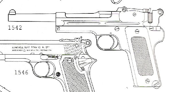

Thanks: 1,120
Here is TAC's photo he found in Zhuk's book.

The photo from the book (#1542) shows a slide which has a very close similarity to mine. In fact, other than mine having a barrel shroud to enclose the large recoil spring (which makes it look like a "fat barrel'), it is almost a duplicate. The key thing which caught my eye were the two long "gripping grooves" which show up on the bottom portion of 1542's slide assembly. Mine has precisely those same two grooves in the same exact location. This has to be more than coincidence. Perhaps maybe from the same factory?
I could not find any locking machanism as the bottom of the bolt is smooth (no ramps, cams, links, etc.) and there is no indication the barrel locks to the bolt or slide, either. It simply has its stud resting in a mating hole in the frame. The recoil spring is fairly heavy to operate and I suspect the builder simply used a very stiff spring to make up for a lack of locking mechanism.

The spring contained inside the barrel shroud is like that of a Walther PP. It telescopes over the barrel and presses against a shoulder at the front end of the shroud. Thus, when the pistol is fired the entire slide moves to the rear and is restrained by the increasing compression within the spring. The barrel is fixed by the stud/mating hole and just sits there.
Now, if you look at the color photo of the pistol you will see a silver cross bolt towards the rear of the slide. In addition to retaining the firing pin, it also fixes the bolt itself to the upper slide. So, when the pistol is shot, the entire slide moves rearward...including the bolt. The silver "wings" at the extreme rear of the slide (same place as the Mauser C/96) are only to provide a grasping surface to **** the weapon. They are part of the bolt and do not move at all.
The cartridge it uses is definitely a bottle-necked round. You can look into the chamber of the barrel and clearly see where the shoulder is at. Since the cartridge must overcome the mass of the entire bolt/slide assembly - along with the heavy recoil spring - I am now leaning towards a 7.63 Mauser cartridge. Of course, nothing will be fired until I get a good chamber cast and figure out exactly what I have. Since I recently bought a very nice New Hermes pantograph engraver it will be used to properly engrave the caliber on the barrel.
