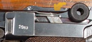

A police sear safety was a requirement in 1933 (also a magazine safety), the mag was discontinued and taken off of most guns, while the sear remained.
Here is a picture of one;

Hi Ed T.,
What is the scoope on the odd "2983" numbering on the photo you posted...???
Unread 08-17-2005, 04:23 PM   #13
Posts: 15,979
Thanks: 2,077
ahhhhh, that one Pete... Unsure, but this one also has a "rack" number on the rear. Although only the dutch guns truely have a 3rd or 4th number to differentiate it, my feeling is that another gun in the unit had a serial number almost matching, thus the four digits on the side-plate.

Also, note that "boosting" Lugers by adding sear safeties has been occurring to fake rare, Nazi-era Police pistols. Make sure that the serial number is in the proper range, that the rivet attaching the sear safety is white steel (not brass or blued), and that the cutout at the top of the sideplate is rough-edged and not blued.
