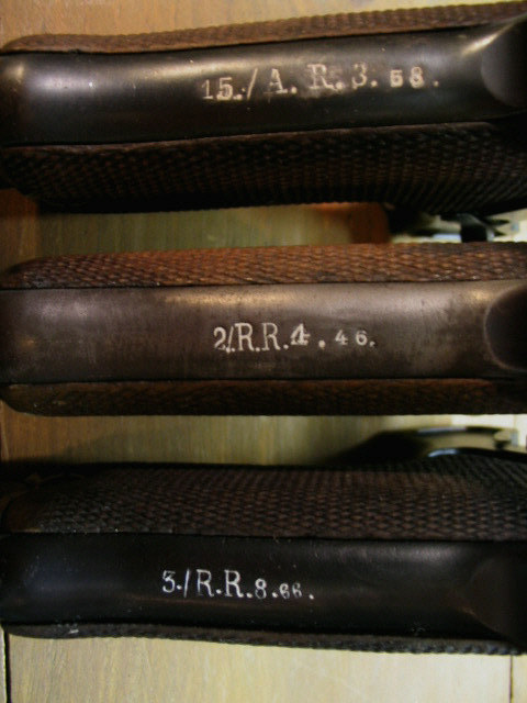

Hi Mark, I can't see your photo very clearly. The mark that you believe to be a 7 is possibly a " / ". The photo below is of 3 Weimar Reichswehr unit marked lugers. Note the slashes. When the Germany Army was reorganized after WWI. They change their unit marking methods or 'codes ', for lack of a better term.
Almost all (not all) Reichswehr[post WWI] unit marks have a "/ "incorporated. As the three below.
These translate as~
1. 15th Batterie / Artillery Regiment 3 weapon #58
2. 2nd Eskadron(Squadron) / Reiter (cavalry) Regiment 1 weapon #46
3. 3rd Eskadron / Reiter Regiment 8 weapon #66

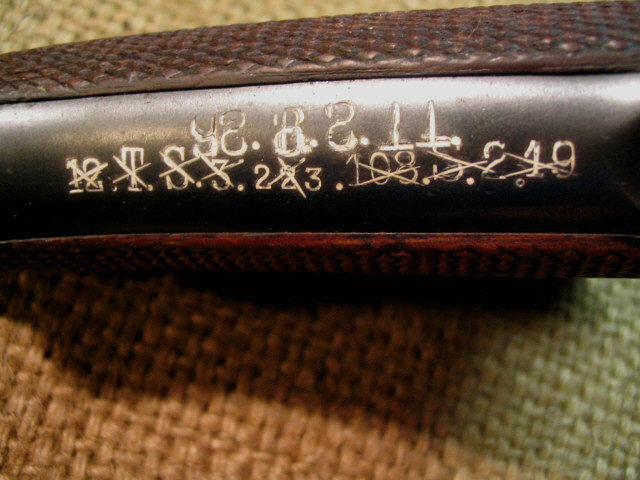

This is an Imerial or WWI marking. Actually three. The pistol went through three different regiments
102nd Regiment Train Sanit�¤ts( Medical train) 3rd Company weapon #223
108th Schutzen Regiment ("Sharpshooter Infantry" more or less) 2nd Company weapon #19
98th Infantry Regiment 8th Company weapon #11
And you can see that the armorer flubbed and had to overstamp the 8 with an R. The 108th unit marking is also an error possibly. It should have been 108.R.2.19. So you can tell that these can be difficult to translate sometimes.

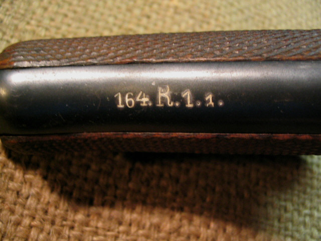

This is 164th Infantry Regiment 1st Company weapon #1
