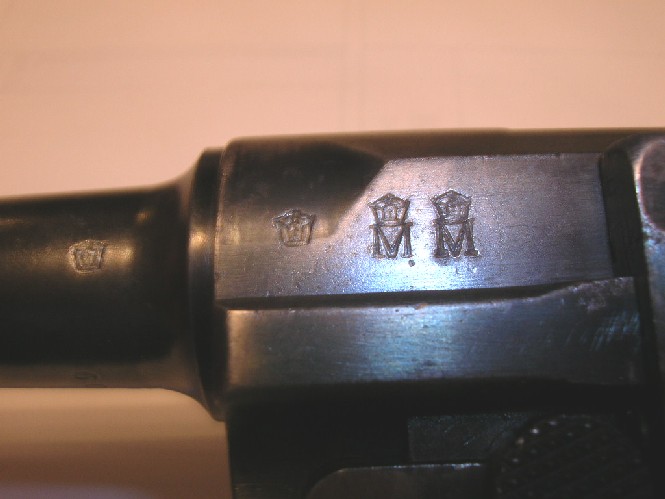

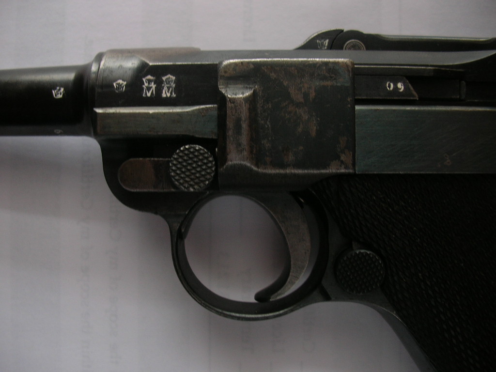

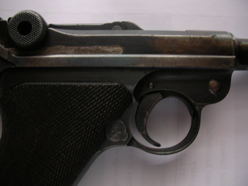

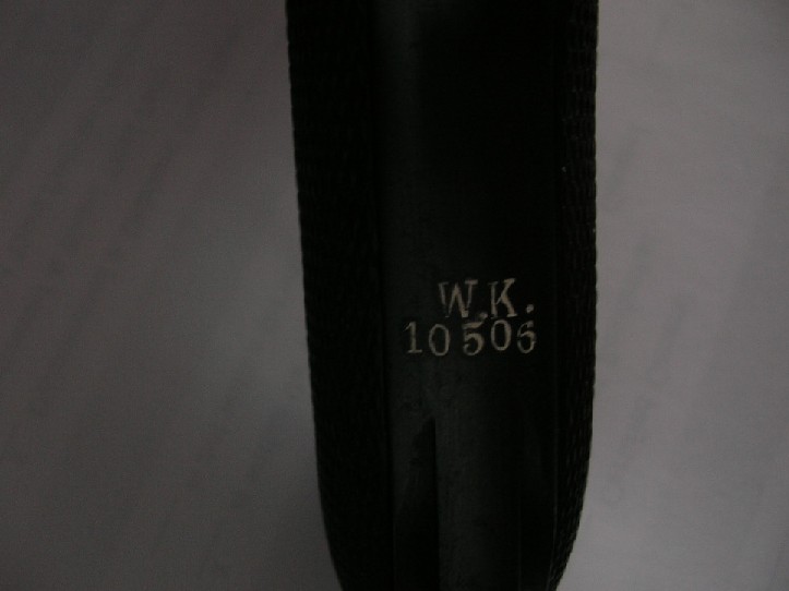

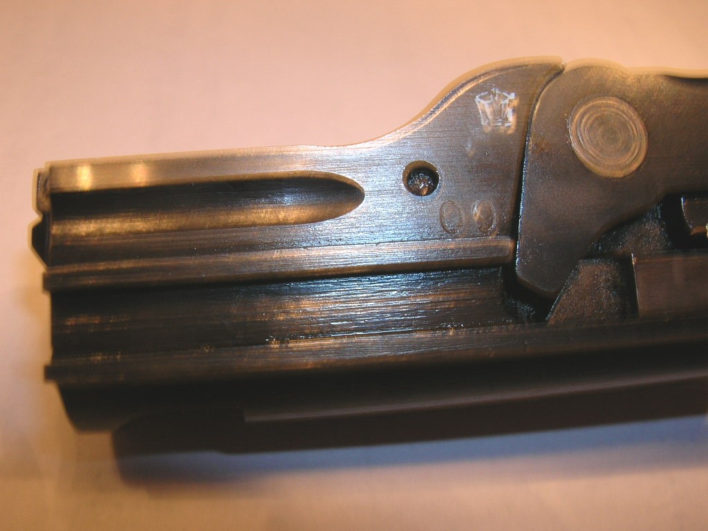

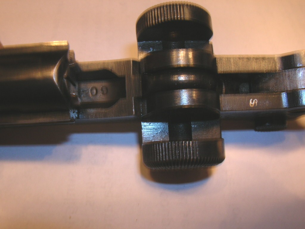

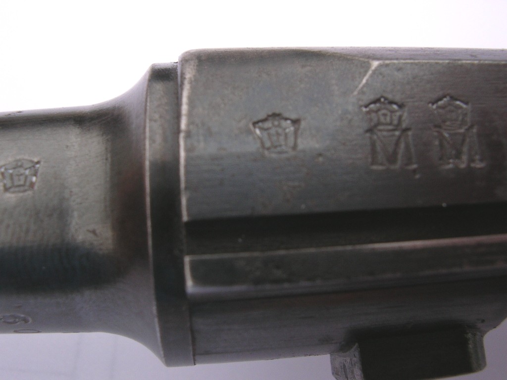

I had a fellow walk into my office and offer me what turned out to be a 1908 Navy Luger, no grip safety, 100/200 rear site, s/n 3509b is all matching and the last 2 digits on the bottom of the take down lever and sideplate and other normal places. Unit marking of W.K.10506 on the rear grip strap. This was the first time I'd seen one other then in photos and needless to say I'm very pleased to have it. The only part of the pistol that gives me some concern is the sideplate. I tried some WD40 on it to see if it was touched up but no change occured to the finish. Did I read somewhere that Acetone could be used to remove suspected reblue? I also lucked out in going thru my extra mags and found an original navy mag (s/n not matching) but with the correct markings. Very little straw remains and the finish is thinning on the left side of the chamber and a couple of areas on the barrel. Any thoughts on the WD40 or Acetone?

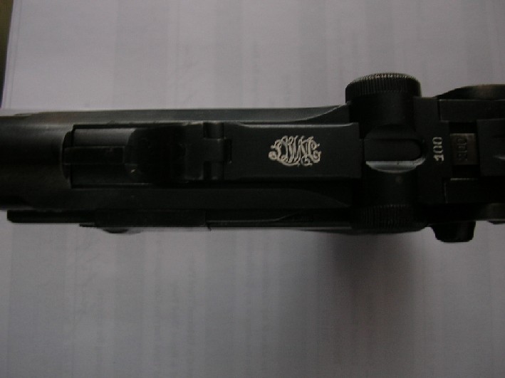

I don't know what you paid for it Brent, but cold-blue or not, it would be a treat to own a Navy Luger...
Please post clear closeup photos when you get the chance... if you need help doing that, ask...
acetone or wd-40 will not harm the finish (and should remove most traces of cold blue) on your gun (but keep it away from the grips) and don't leave it on the gun... use a good lube like Breakfree once your cleaning is finished.

Posts: 176
John: Thanks for getting back with me. I paid $1,000 for it and was thinking that even if it had some reblue on it I could at least get my money back if/when I would sell it.

John: Would it be a steal at $1,000 if there's some reblue on it? I'm getting some Acetone shortly and the photos will hopefully be arriving this afternoon. THanks, Brent

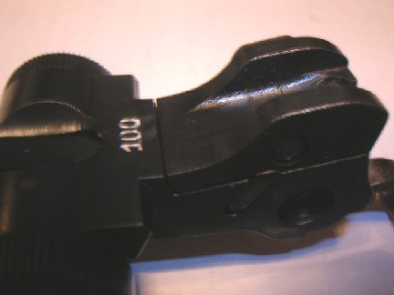

Brent, a new REPRODUCTION (not original) navy rear sight toggle sells for about $400... If you got a WHOLE authentic Navy Luger for $1000... you did better than all right... the photos will tell the story...
If what you bought is a "faked" Navy Luger... the price is still not outrageous unless it was presented as an original Navy, considering the cost of the rear sight/ barrel modifications and a 'donor' 1920's commercial 9mm Luger that it was built out of...
regardless, it will be a GREAT shooter even if it isn't a "collectable"...
If you can't post photos soon, at least describe all markings and locations...

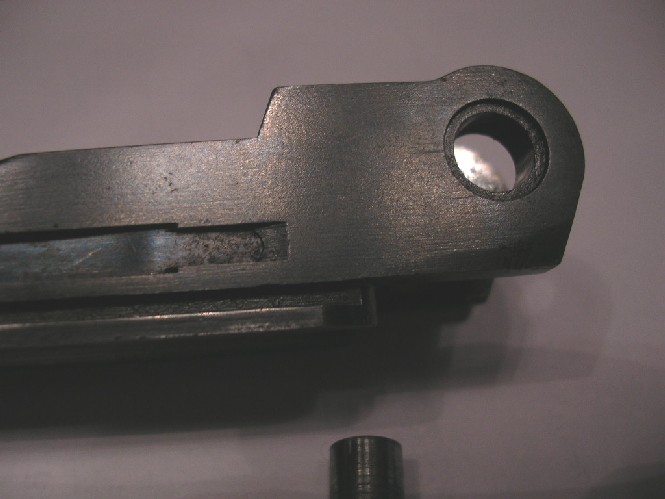

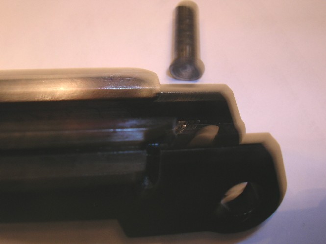

Brent, check your PM's for some suggestions on photos...

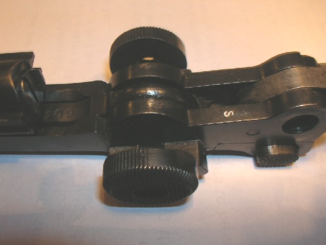

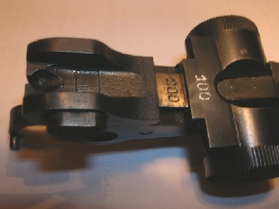

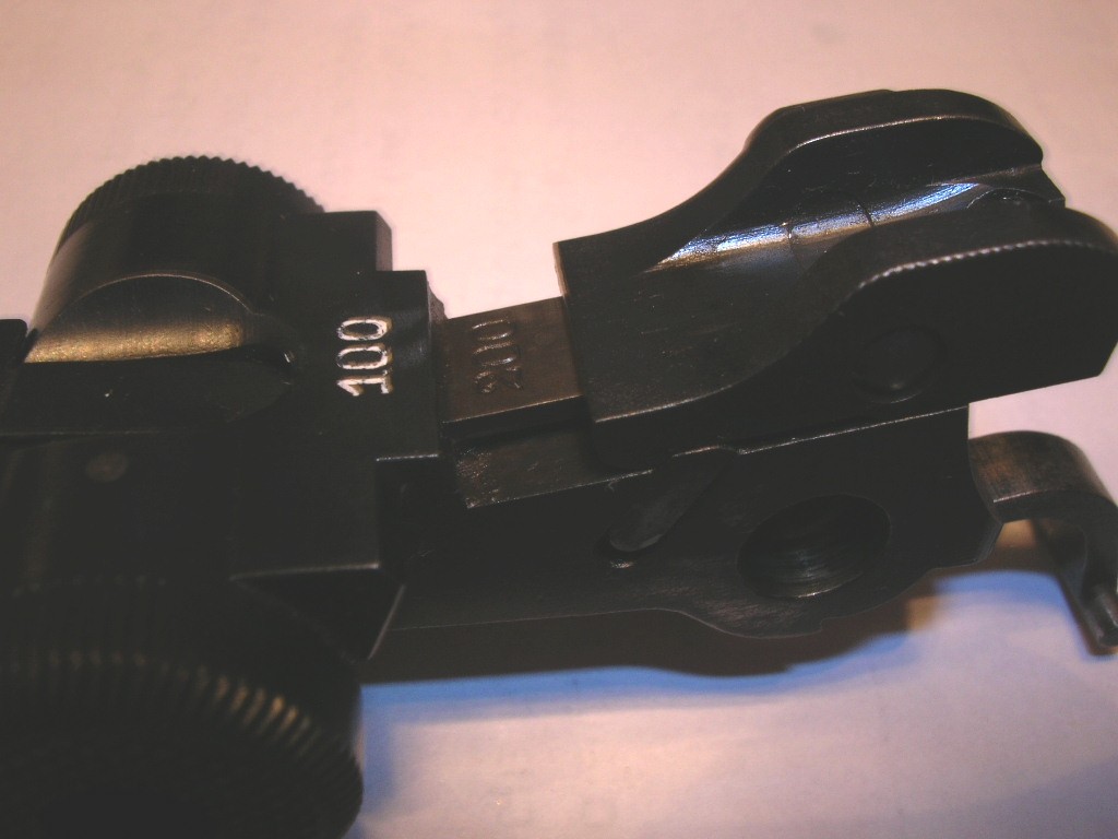

Please show the dismantled upper receiver and the rear toggle axle... and also need to see the front and rear sights and the underside of the barrel/receiver as well.

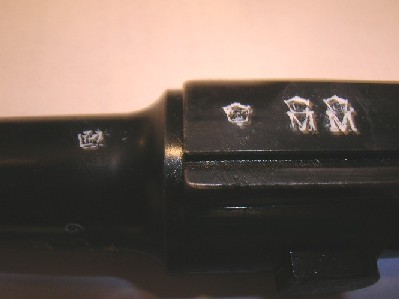

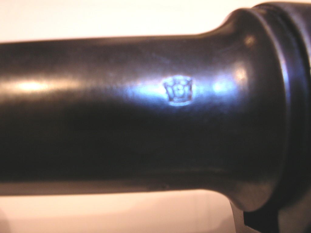

The Crown M (Kriegsmarine) stamps have given me some concern that the Luger may not be a genuine Navy... but further photos should help out in making that determination. We need Tom A and Leo to chime in and give you an evaluation...

Pending better pix, my inclination is that the proofs are legit. Congrats on a very good find at an excellent price.

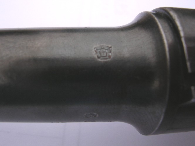

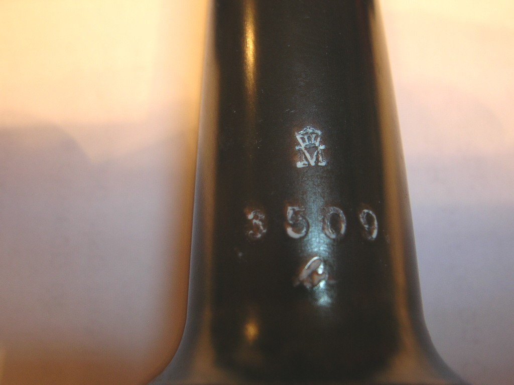

Brent,

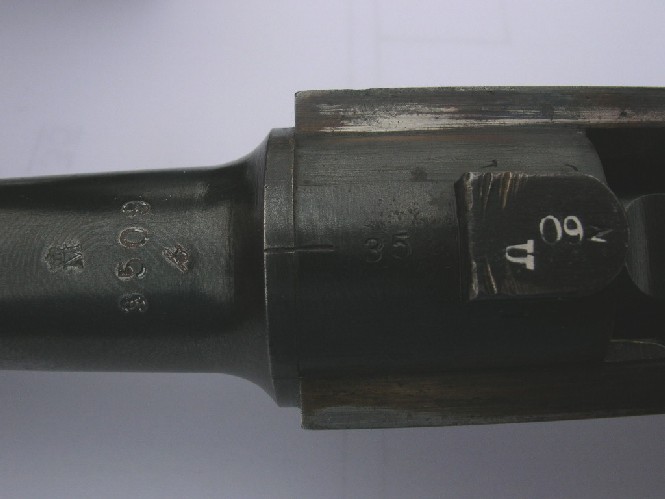

At first glance I don't share John Sabato's reservations about the c/M markings, but he is right that better--closer--sharper--photos will be useful. It would be a good idea if you removed the 'whitening' in the marks, this can obscure determining detail. The acetone with which you are willing to subject your Luger should suffice for this.
I am intrigued by the appearance that the breechblock proof is an Erfurt Imperial eagle.

I got out "Imperial Lugers" and the proof marks are:
crown on the left side of the barrel
crown, crownM & crownM on the left side of the Receiver
crown on the breech block

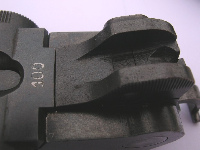

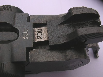

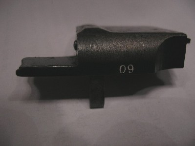

The s/n of 3509B and a smaller crownM is under the barrel and the 3509B on the front of the receiver, there's the 09 on the bottom of the take down lever, on the bottom of the sideplate, safety and, I'm not sure if it's called the sear bar?
There's the "100" in front of the rear site and when extended has the "200" on the metal colored area.
The unit mark is on the back grip strap.
The breechblock has an 09 under the crown and I see an 09 when it's turned upside down.

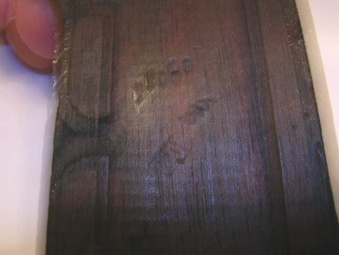

The inside of the grips are marked.

Thank you Tom A, and Dwight for weighing in on this evaluation... the obscurity created by the heavy application of white in the stamps was my basis for concern... I look forward to the next set of photos without the white enhancement... (But if Tom A, thinks from what he has already seen that your Navy is righteous, I wouldn't be too concerned...) We shall wait for your son to do the photo magic with anticipation...

With the caveat that nothing can be 100% assured via photos, I stand behind my original assement. This is a correct gun which may or may not have been back through a navy arsenal during it's service life.
Congrats; you have a keeper at a third of it's value.
