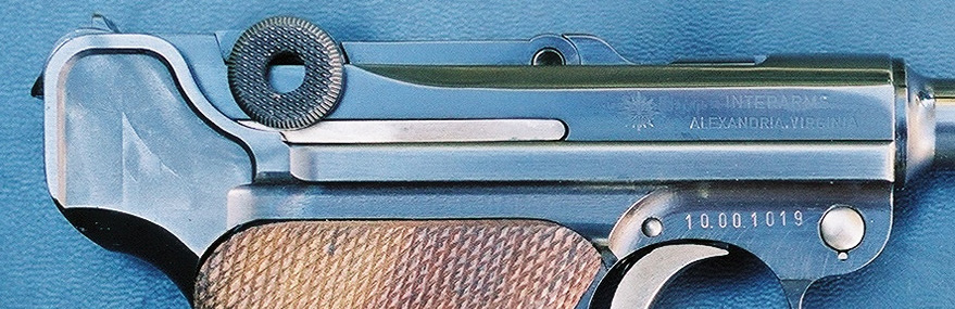

Hereafter my prototype number 19:

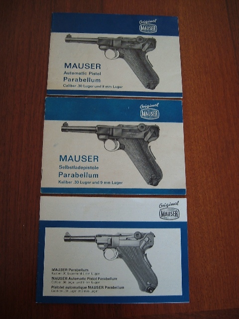

The complete set of User manual. The first two, in German and English, depict the first production (prototype) the last one was sold with the last production and it is written in German, English and French.

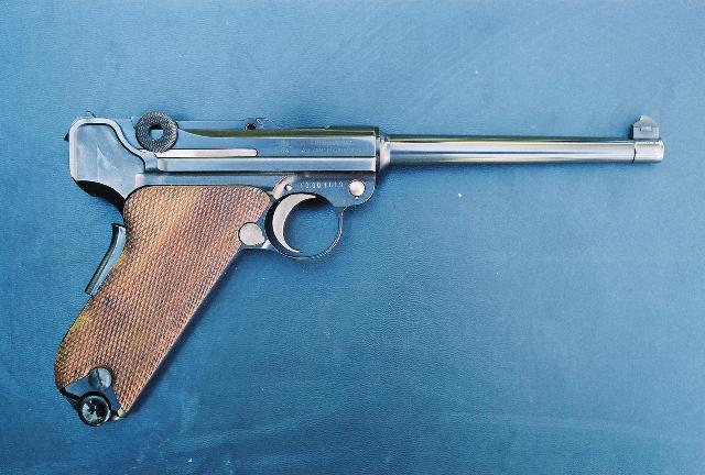

I have prepared here some pictures to better explain the differences between the early production and the â??normalâ? production.
I am sure that the first 50 pistols sold to Interarms have the configuration of mine 19. These pistols were mainly used for presentation purposes. I have two articles date 1971 were these pistols have been presented. In these articles the differences between these 50 pistols and the usual production is underlined.
The question now is: when Mauser started the production with the definitive configuration. It seems, according to Tom, that the number 67 had not reached the final configuration.
Do you have any idea about this interesting matter?
Ciao
Mauro
Prototype number 19
Prototype number 19 (top) vs normal production (bottom)
