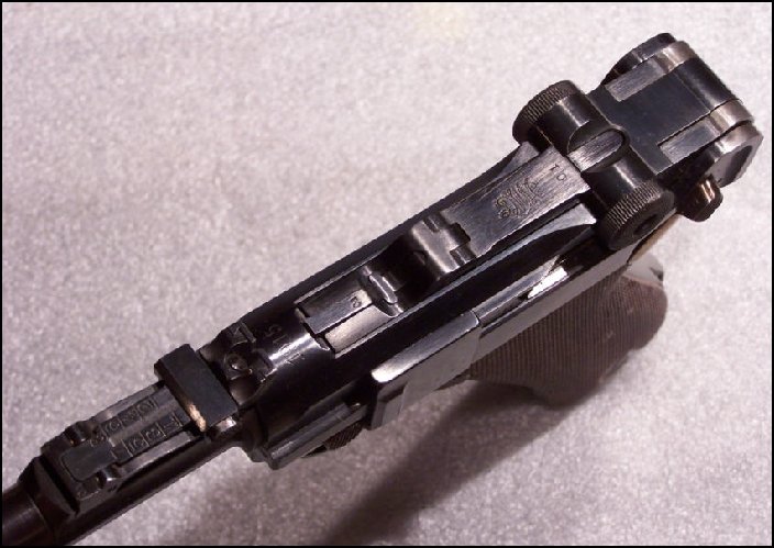

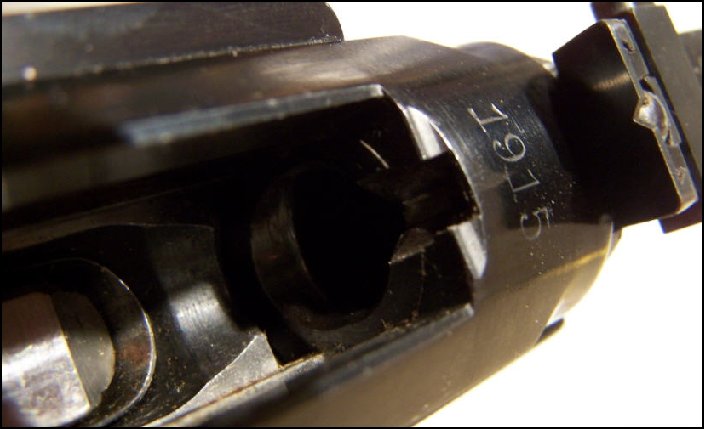

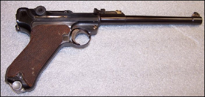

Just checking over a very expensive impulse buy, which is my first artillery. DWM 1915 ser # 4501 a. Matching #'s but the refinish wiped out the proofs and most of the sideplate number
I was hoping for some advice on the following; the rear sight ladder only requires very modest pressure to lift, does this indicate a worn out spring ? Does the securing pin on the sight ladder need to be drifted out in a specific direction ?

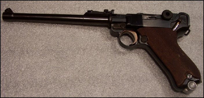

The repro grips have to go, but a pair from a 41 byf are simply the wrong shape. Is the frame shape between Mauser, DWM and Erfurt different ? I'd like to find out what period / make I need to search for.
The magazine that came with it is a nice condition rolled blued se/63 ser # 3124 s. I'd like to trade this for some repro wood bottomed mags or better grips but I've no idea of the relative values; any advice ?

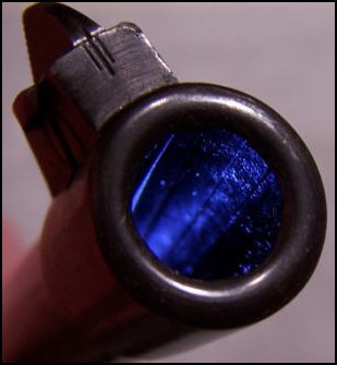

I'm also looking for a fine tune screw for the front site, I don't think Mr Heller has one, any ideas where else to look, (gunparts, sarco etc don't have them listed).
I have to confess I really like this gun, but have to resist the urge at these prices
Thanks in advance for any help, Stu
ADDENDUM: Well, I worked out what was wrong with the rear sight; I believe there should be two projections on the underside of the adjustable slider that run under the rails formed on the top of each side of the base. These would prevent the sight from rising away from the base.
Could anyone confirm this diagnosis please ? I suspect I'll have to return the gun, most unfortunate.

Stuart, it's a shame that your 1915 has been boogered. It aint worth much now so I would not invest any big money in grips etc. Simpson has fine tune screws for the rear sight for $40 but none for the front. I am negotiating to buy a barrel in order to get the front sight adjusting screw now. Should my efforts prove adequate, I will have a screw that I might sell but it will cost a hell of alot more than $40.

Thanks George. I think I've found a slider for $20, repro I suspect, but I think it can be made to work. There is a screw on the front site which works, just slotted rather than the pin type.

The refinish is actually quite well done. The surfaces have been kept sharp and the blue quality is quite good, (but not rust blued). Thor has reworked an Erfurt for me in the past, and this doesn't match that quality, but is much better than many I've seen that looked as though someone had at them with a rotary buffer !

Well I shudder to confess I put down $900 on this. If the sight wasn't broken I could just about rationalise it; the refinish is to a reasonable standard and all the parts match, notwithstanding the loss of the proofs.

In my opinion, $900 is not an unreasonable price for an all-matching 1915 DWM LP-08 in such condition as yours. Even though the finish is all wrong and some of the markings have been dimished, it appears that in the metal work some care was taken to retain proper surfaces--note particularly the work on the side plate--and not buff the corners round.
Also, keep in mind that estimated production for this year's Artilleries is only 15,000 pieces, the lowest production figure for all LPs except for the 1914 DWM, so they are not exactly the most common Lugers around.

Quick update for anyone interested. The replacement slider arrived and is in good condition, but is Erfurt proofed ! I'm going to test with this one and have ordered another just to see what arrives.
One the sight is functional I'll be trying to get the original repaired using the second replacement as a pattern for the repairer, (some delicate work in there).
