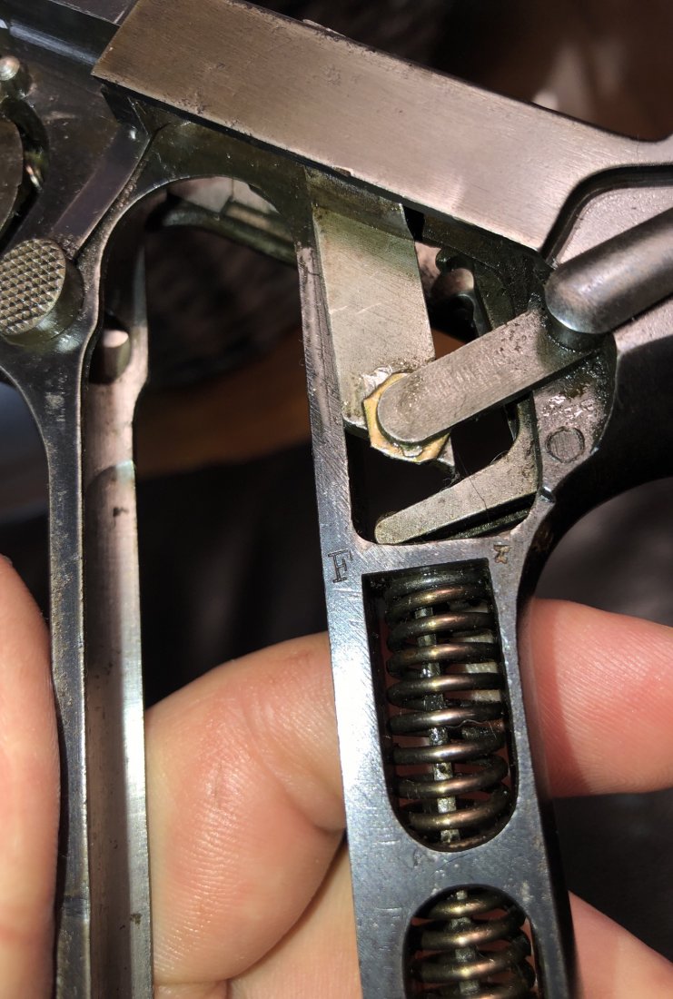

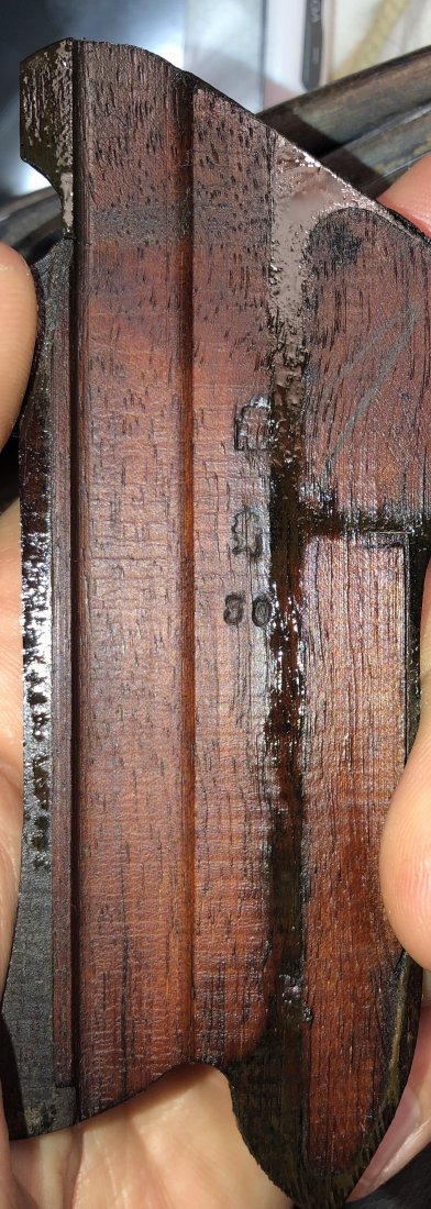

Here are pics of the one I mentioned, not quite nearly as nice as what was shown earlier

If you look closely at your third and fourth pictures you'll see that there is a groove where the frame's serial number is normally placed.
Compare this to the flat and square appearance of this surface on the ser no. 3 pistol.
It's unusual. Is that seen on other Erfurts of this period?

I believe the front of the frame was "faced off" and a new number applied to create a "forced" match. The "130" is offset, and that is also not "normal". JMHO.

Interesting I wonder if this was done at the factory? Reworked maybe after the war? This came from a descendant of the vet who brought it back.
I will post clearer pictures of the frame Serial this evening. Are their any other areas I should focus on?

Attached are more pics.
Was this factory reworked?

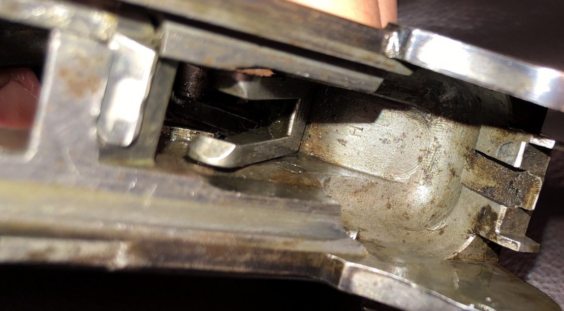

Final pics.....

The Germany is almost certainly a post war marking; as Ed says- Erfurt made no lugers before 1910 or dated after 1918- so it was marked for export post WWI. The Germany stamping also indicates at least the frame was not "captured",
though:
I could make up a story, that could be true, that the original frame was de-lugged in the US sometime after import, and the pistol subsequently "restored" by renumbering another Erfurt frame. The only number on the frame is on the front.
No question in my mind that the frame was altered and re-numbered.

I tried to show all markings on the lower receiver as well as the circles which I haven’t seen before in pic 2, I presume lanyard loop
Seems it could have been reworked

Correct, the 2 circles below and on each side of "Germany" are the remnants of the lanyard loop. No legal reason to remove it.

Why anyone would cut off the lanyard loop is beyond me, so whether it was done in Europe or in the USA is anyone's guess.
There have been enough questions raised that personally I would proceed very cautiously. What are you planning to spend?

I would pass, due to the monkey business with the numbers on the front of the frame and only fair condition; unless it is priced as a shooter. JMHO.
