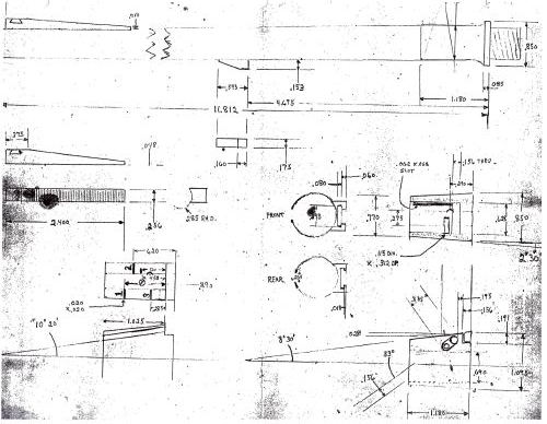

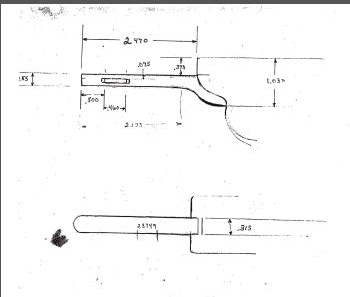

I never received the prints let me check with Don and find out if they're still available.
You must have piqued Don H's interest...He hasn't posted since 2005, but he was on-site today...
Hello Don!
Unread 01-09-2014, 02:44 PM   #22
Don H.
Location: Albuquerque,NM.
Posts: 96
Thanked 7 Times in 2 Posts
I just finished scanning the prints. It took me awhile to find them, after looking at the old posts it's only been ten years. Nothing like putting things off! My problem now is how to post them on this Forum. If I can send them to someone's email and they post them that would be great. I was going to highlight some of the faded lines with a straight edge before scanning them but I just don't have the time. I figured who ever needs them can do that. My email is dhamilton09@comcast.net so who ever wants them just email me. Thanks

Thanks Don. Email is on the way. I will get back in touch with Neil and tell him he won't have to snail mail them!
I did get in touch with Neil, and here is his reply:
John,
I did get some prints of the carbine from someone on the Lugerforum years ago, but after looking in my computer save area I do not see them. I will copy the paper of what I have and send them to you. They are not really that specific but good enough to make the parts. I did finish the one I was working on and will send you some of what I have of it. If you would you can put them on the forum.
I’ll try to gather what I have and send them but it may be in a week or 10 days as we are going to the shot show next week.
Neil Keller

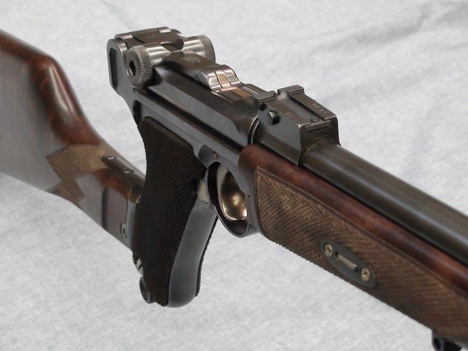

Unread 01-09-2014, 02:56 PM   #24
Hub
Location: Decatur, IN
Posts: 61
Thanked 3 Times in 3 Posts
Smile Carbine

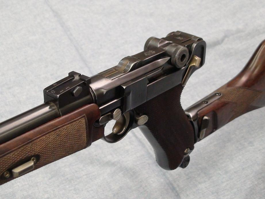

I sent John the pictures of the finished carbine to post for me.

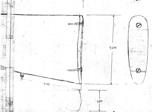

Don H. is offline   Reply With Quote
Unread 01-09-2014, 03:43 PM   #27

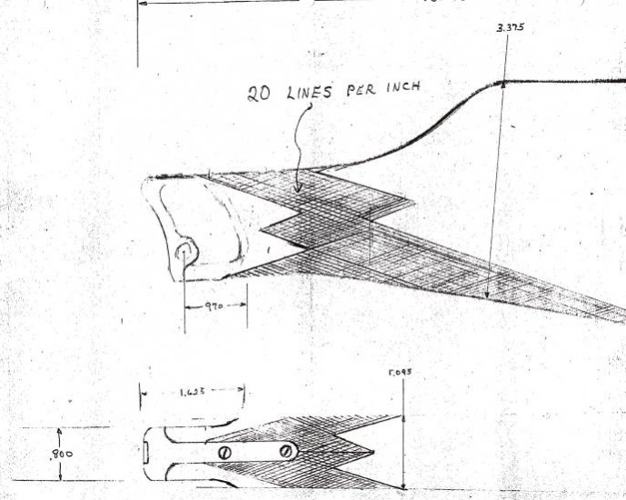

Perhaps one of the members can download what you sent, formalize and upgrade them using AutoSketch or some other CAD program and send them back to me to upgrade the download.
Surely one of the members who has nothing else to do (like *coff* Sheepherder *coff*) can accomplish this!

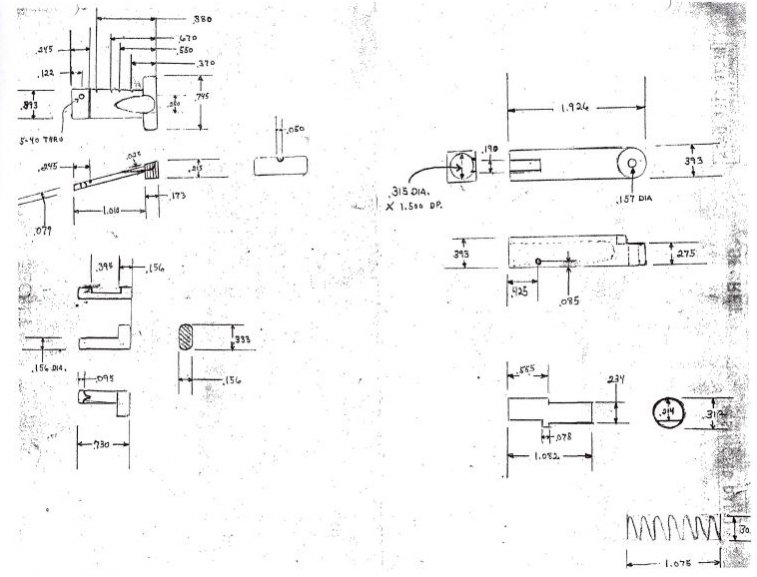

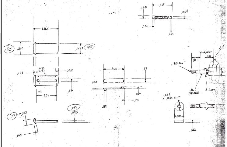

Unread 01-09-2014, 03:54 PM   #28

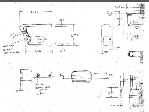

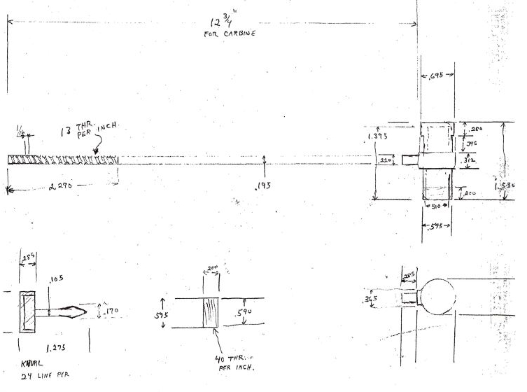

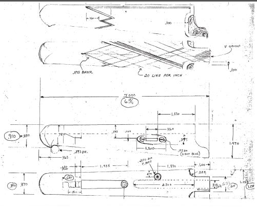

I transferred the files to JPG, as it was too big to post; I am sure I lost resolution, if anyone wants them at how I received them, send me an email to ed_tinker@hotmail.com
they are around 5 mb's for the pdf file

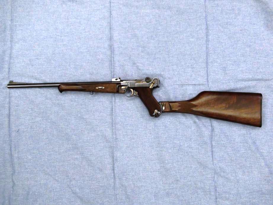

Unread 01-09-2014, 03:55 PM   #29

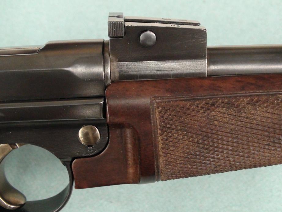

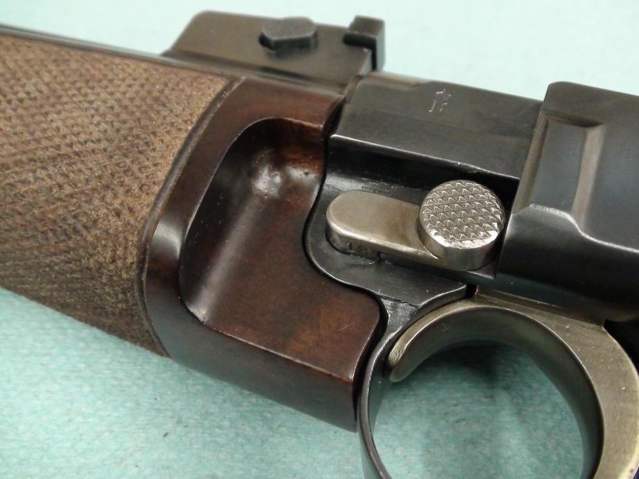

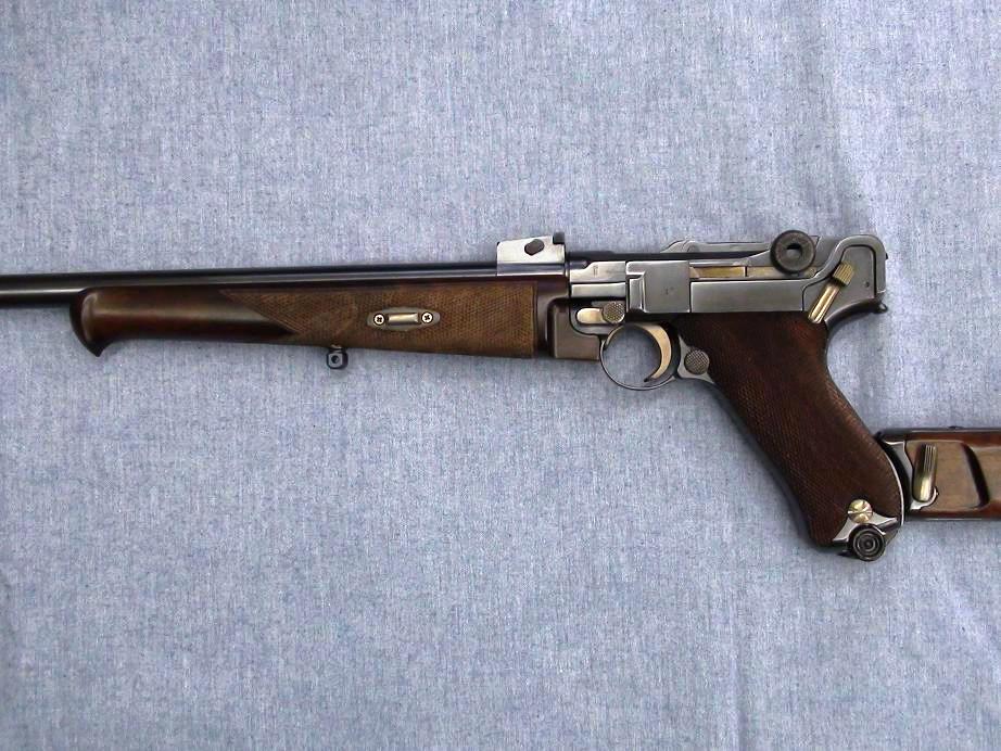

Default Finished Photos of Hub's Carbine... just received!
Enjoy!
The following 8 members says Thank You to John Sabato for your post:

A big Thank You! to Don H, Hub, Ed, & John for resurrecting these treasures!!!
I would suggest that they be 'stickied' with appropriate thanks to the creators!
Edit: Hubs carbine is bee-yoo-tee-full!!! Hub seems to have mastered 'strawing'!!!

Unread 01-18-2014, 04:09 PM   #38
I can provide exact measurements if need! ~~Eric

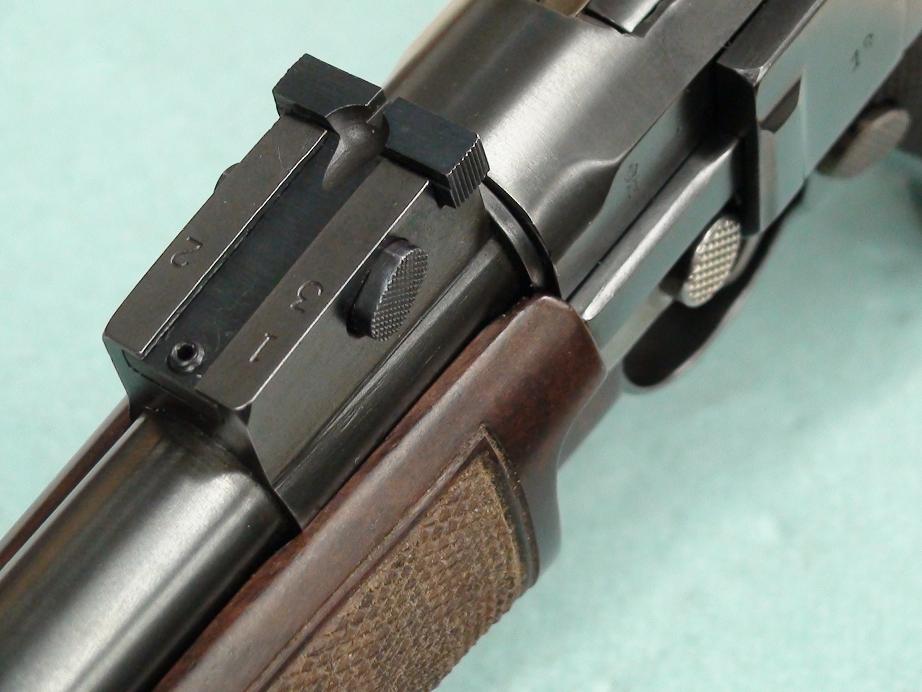

Unread 01-18-2014, 04:13 PM   #39
flytrout
Join Date: Apr 2013
Posts: 25
Hi I need the measurements if the rear sight ass. Thanks
flytrout is offline   Reply With Quote

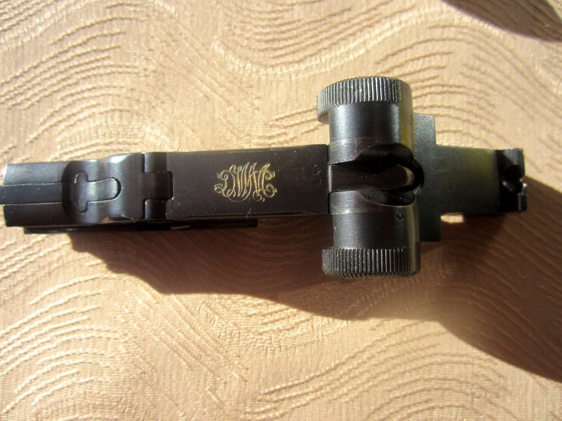

Unread 01-18-2014, 04:29 PM   #40
Total toggle length is 4.5 inches! If you need more just ask! ~Eric
