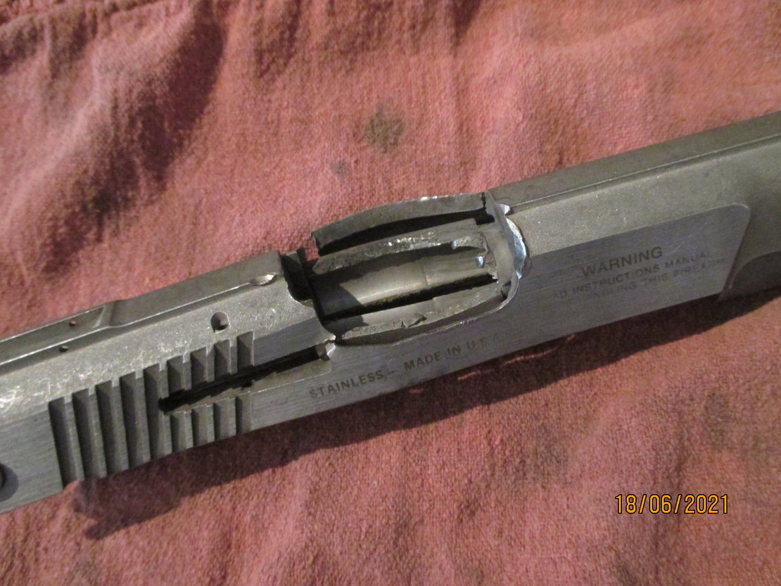

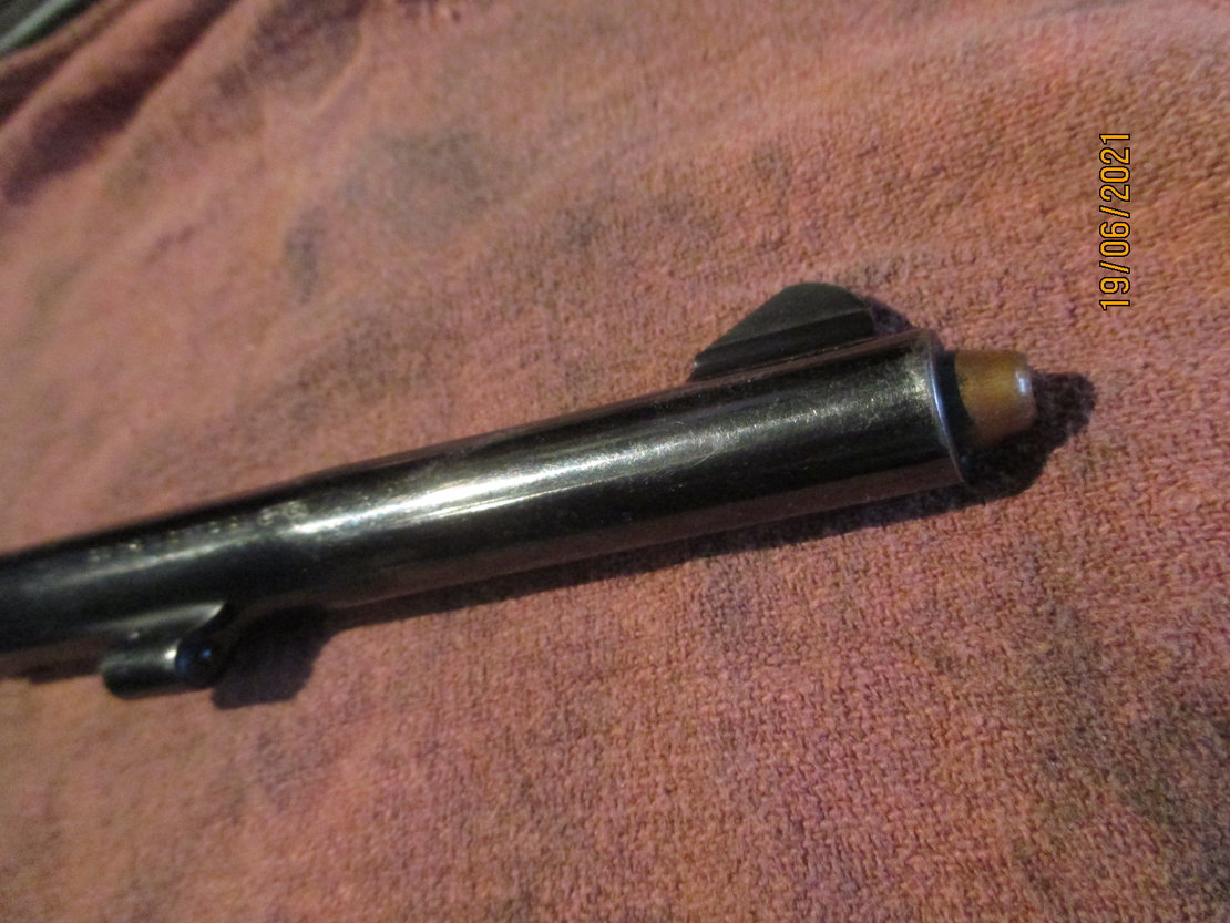

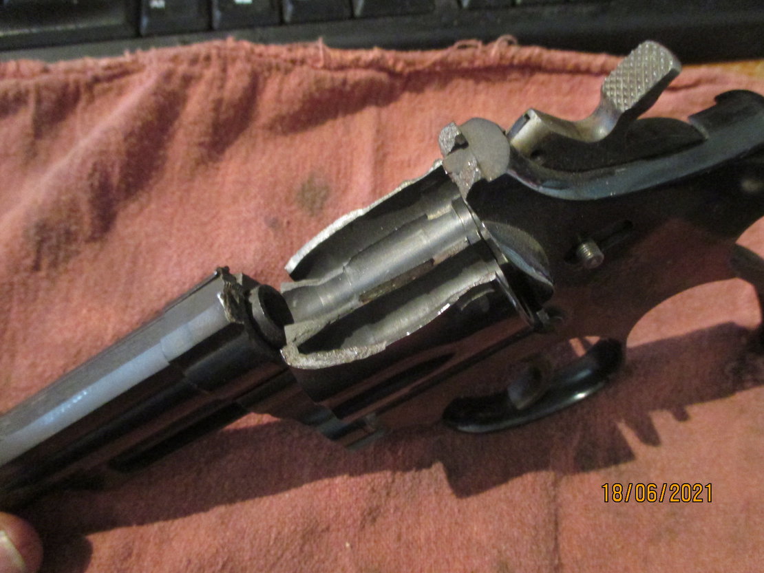

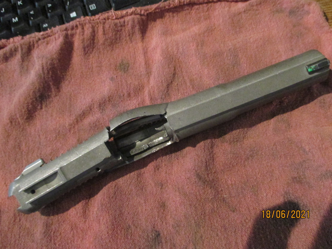

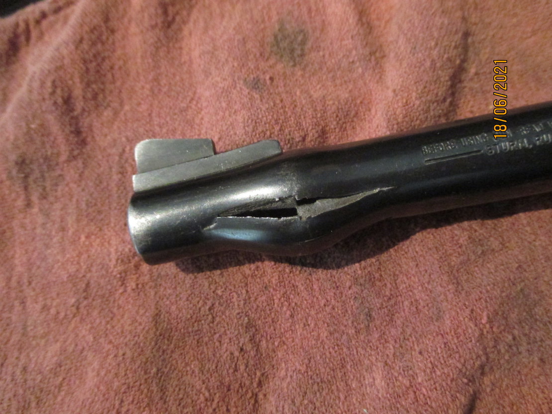

I've got a box full of this blown up stuff. I've accumulated it over the years when I worked at a full time gunshop, and at my own 'smithing business. The AMT slide is a 45 win mag. The owner thought he had Win 296 in the powder hopper...He had 231 in it instead. Probably about 4 times as much powder as would have been safe. The S&W 19 357 mag was a load of Unique. He didn't have his glasses on, and didn't see he had the "10 ' block over a notch, so he threw 15.5 grains, instead of 5.5 grains, a triple load. Took the top of the gun off. The 1911 barrel was a stuck bullet, with another one fired on top of it. The Ruger barrel is the same story.http://forum.lugerforum.com/attachmh...1&d=1624074634

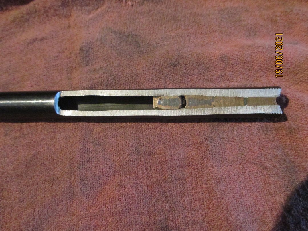

I have read that the German MP5 barrels were designed to survive squib loads, where a bullet is stuck in the barrel and hit by another. Squib loads are a problem with full auto's because if there is enough pressure from the squib to work the action and feed a new round, there is no pause for you to recognize the squib shot and not send the next bullet down the barrel. I personally experienced this with an MP5. The barrel swelled just behind the front sight post and actually shot out the squib with the following round. The MP5 continued to function for numerous rounds after that, with no change of point of impact and no burst barrel! Good old German engineering!
During a course here I was shown a picture of a MP5 barrel, with 6 bullets stuck into each other, at which point the barrel said enough and swelled up.

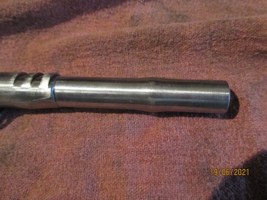

You can certainly stick a bullet in a barrel, and fire another on top of it, and get away with it. But you will most assuredly want a new barrel after that, because it will bulge the barrel where the first bullet stuck. The first is a Dan Wesson 357 barrel, 4 bullets stuck near the muzzle. Next is a S&W M&P Model 10 38spl barrel, all 6 in there, with the first one almost out of the muzzle. Last, a 1911 45acp barrel with a nice bulge. That will usually stick the slide partially to the rear when the barrel bushing comes up tight against the bulge.http://forum.lugerforum.com/attachme...1&d=1624169208
