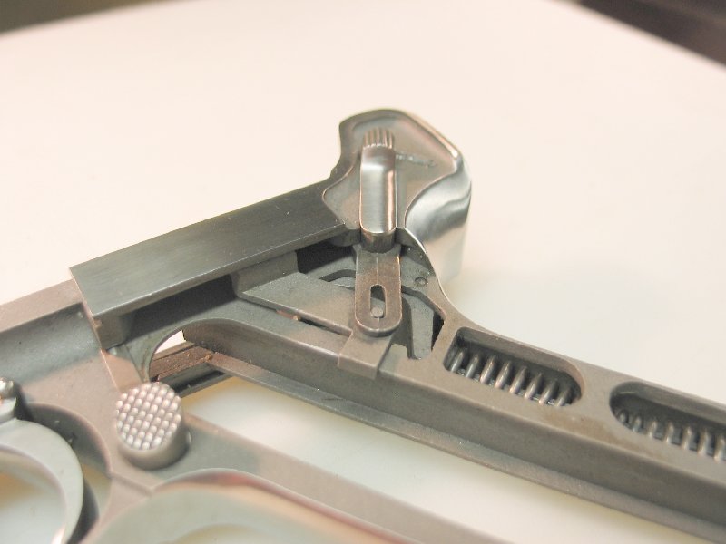

I have a piece of .035" steel sheet, I'll try to make it to size and contact cement it to the lug. I noticed the takedown lever is loose in its hole, but I stuck a shim in front of it to restrict movement and it had no effect on the barrel extension...er...extension...

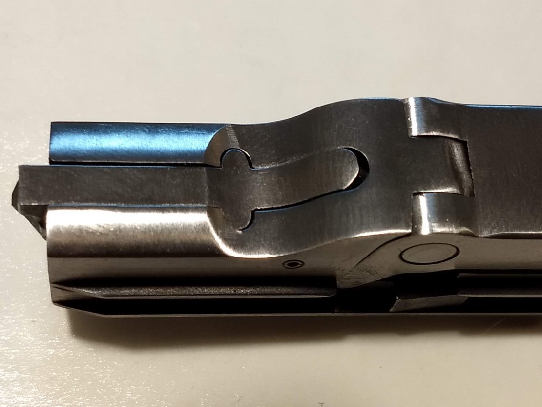

Unread 09-20-2018, 01:23 PM   #24
As David suggested, I contact cemented a piece of .035" steel shim to the front of the barrel extension lug, where it would contact the rear of takedown lever (first pic). I assembled the parts and checked it for proper function. Everything works like it should, so this modification [repair?] should be do-able. Second pic shows the barrel extension almost level with the front of the frame. I think .040" would be just about right on.

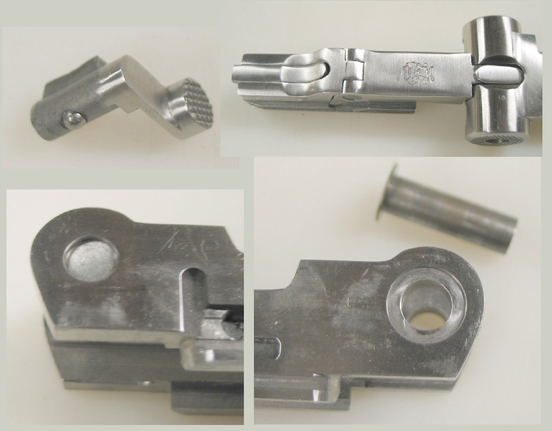

Here's pics of some of the differences [improvements?] that Aimco made. First pic shows the captive ball and coil spring that replaces the takedown lever hairpin spring. The extractor has lost its 'wings', the toggle knobs have no grooves on the outer diameter, and the toggle axle pin has a wide thin head. Oddly, the axle pin is not full-width; it is about ~.083" short...
Second pic shows the firing pin - it has only two flutes, 180º apart. The sear bar is not cut out; the frame has a removable pin to retain the sear bar.

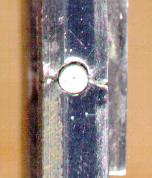

My first stainless Luger was purchased some years ago, just bought it, as was new to the Luger procurement methods. Looked fairly ok, had some wear on the toggle ramps, but otherwise to me.........ok. So it came home with me.
The sear pin area showed this anomaly. So I ended up with a set of fairly expensive parts that I have to admit came in handy over the years for fixing some vintage Lugers.
One can see where the metal around the hole yielded gradually over time, probably somewhat to design, or probably moreso, overly hot loads.

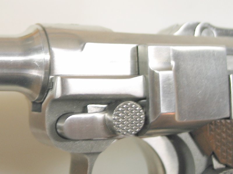

Just going over David's notes on this stainless Luger...I forgot about the sideplate...
They replaced the 'Z' spring/axle for the trigger lever with a roll pin...

Interesting, the extractor on mine is similar to the original design. The sear pin on mine is driven into a blind hole.

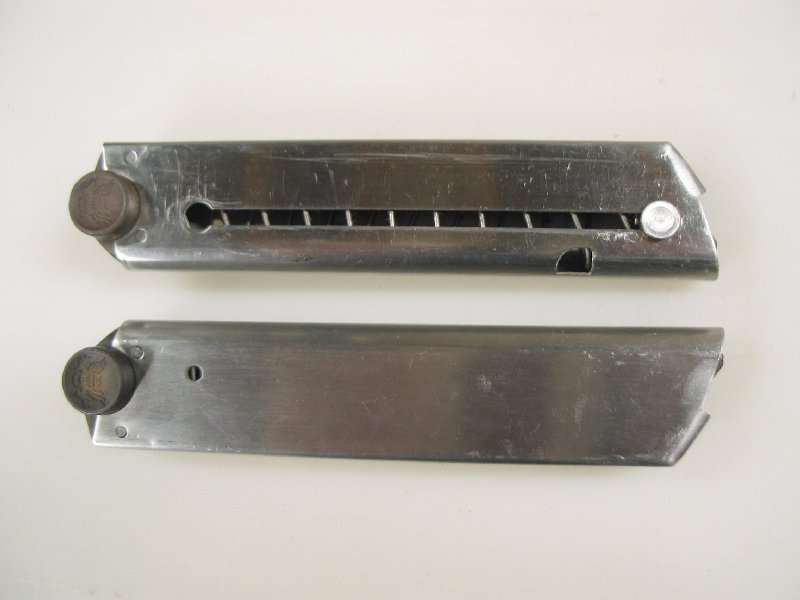

Does your pistol use the Luger style magazine or the oddball magazine?

Unread 09-20-2018, 11:38 PM   #31
I don't know. The stainless magazines don't go all the way in my 1900AE or Mauser Luger.
Brown plastic base and follower.
That's the later oddball magazine. From what I've heard, made in preparation for a .40 cal. version which was never made. Or maybe just to simplify manufacturing.

Also the mag catch or notch in the magazine is in a slightly different place(vertically), so some or most original original magazines won't function correctly when trying to use in one of these reproductions.

When I saw the picture of the frame and barrel extension mismatch, I wondered about the vintage Lugers over the years with long and short components worked out? Just a curiosity that I probably will never learn about; poor rabbit here.
Since the pistol is an early stainless firearm(remember how many first line stainless pistols failed?) adding to the recoil lug might take some pondering. I thought it was odd to see tolerancing that far out, something I have not noticed in my stainless Lugers; maybe two different ones?, but even that seems far fetched.
The shim of course shows the solution which is fairly obvious I think, but how to attach said shim. I like adhesives, the specialty ones today anyway; the Loctite Black Max that is used to attach vent ribs to barrels might be a candidate to ponder. This adhesive as special materials that can move under stress, elastomers(sp?) I think they are called. One would suspect the recoil would be under shock ever so often.
All in all, a good TIG man might be the best solution with machining afterwards if so inclined. Heat is always of concern when working on firearms, so that too comes into the mix for the homeguy.

The later stainless Lugers were of course revamped some, one area was the magazine. Twas lots boxier than the original clip. One can insert the early Mitchell type in a vintage or newer stainless usually, but the converse, is that the wider mag will not enter the smaller earlier mag wells, whether stainless or blue. I believe that some early vintage Luger mag will function in the later stainless Lugers fwiw; another one of those use what you got if you gotta.

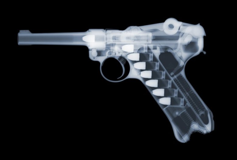

Unread 09-22-2018, 04:53 PM   #37
Another~ https://search.aol.com/aol/image?p=l...g&action=click
Unread 09-22-2018, 08:21 PM   #38
Another~
Cool! There's a round in the chamber but the toggle is open...
That shows what I was looking for...That only half of the takedown lever/barrel extension lug is engaged...

I would have thought two measurements would have told you the amount of engagement?
Since you are only "worried" about the alignment to allow easier cocking of the toggle; why not a piece of deldrin or nylon cut to size and placed in front of the lug? or just a metal shim cut the size of the opening? Would not have to be attached to anything, would it?
Just thinking in writing.
I know this is not an "elegant" solution, but how much are you going to fire that piece ?
Unread 09-22-2018, 11:00 PM   #40
I could even cut a piece of wood and wedge it in there...Half a spring clothespin fits just right.
Or a wad of solder, heated up and poured in to hold it 'just right'.
Or polyester resin...
Lots of ways to 'fix' it. Drill & tap a hole to let a screw hit agonist the front of the takedown lever, forcing it and the lug back.
Or just leave it be...It ain't hurtin' nuthin'...
