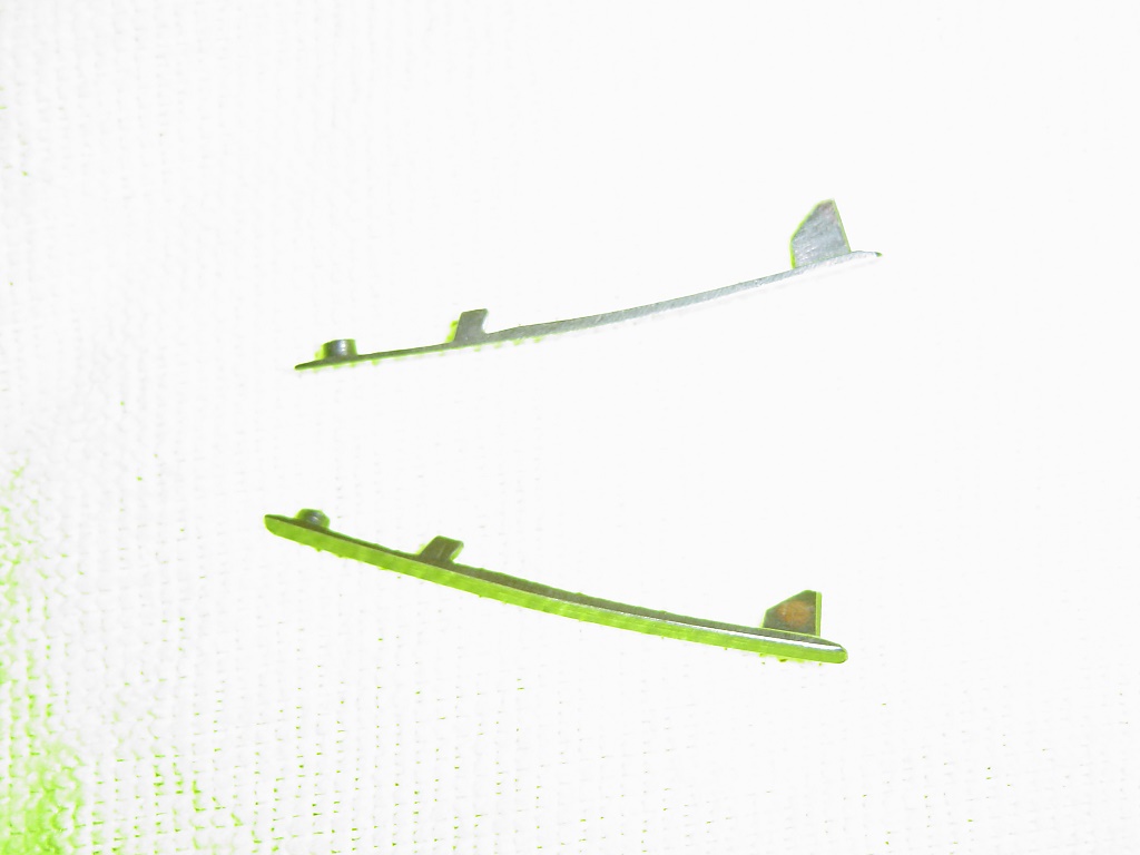

The ejector is one piece, it is itself the spring and has the right angle protrusion that strikes the cartridge.
Like DonVoigt said the ejector is a spring. If allowed it bents inwards, it's the tip working in it's proper channel in the breech that forces it straight. An image (even a lousy one hopefully) is worth a thousand words:
2 ejectors.

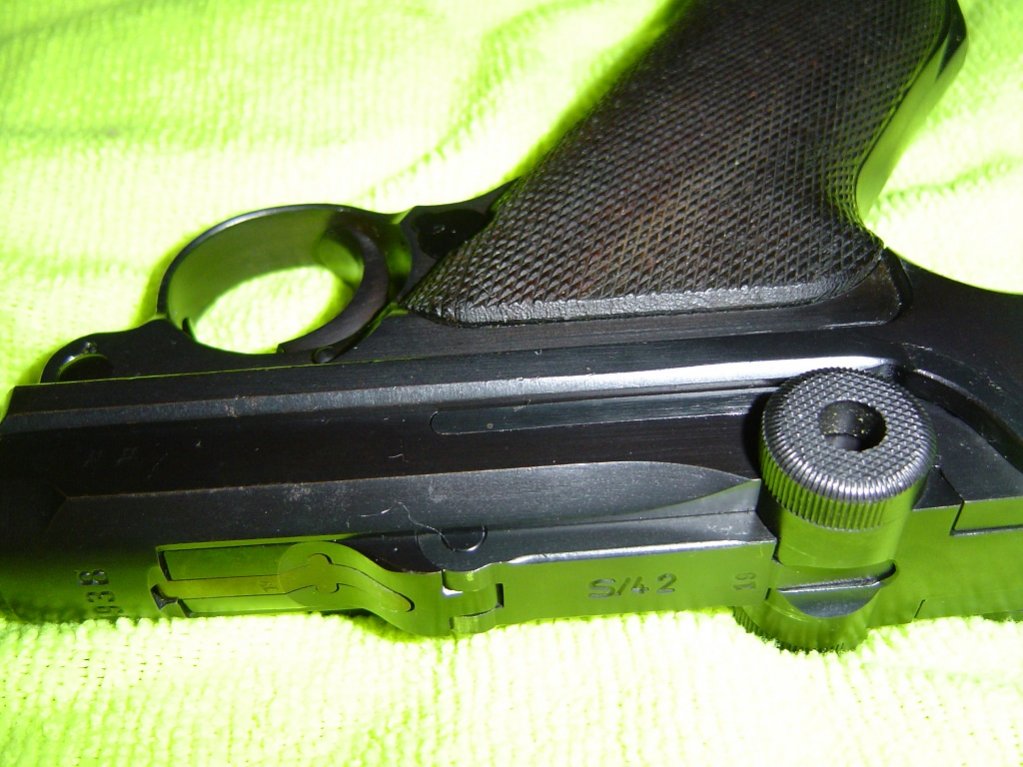

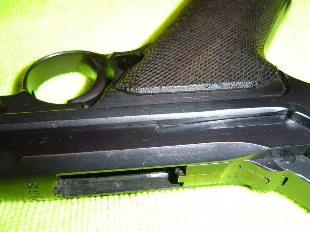

Ejector with closed action

Ejector with open action

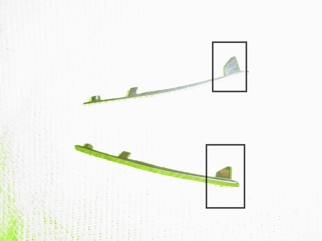

I agree the extractor looks alright. I think the culprit may be the ejector.
I suspect the inside leg to be broken or very worn out.
I've marked where I think the problem is.

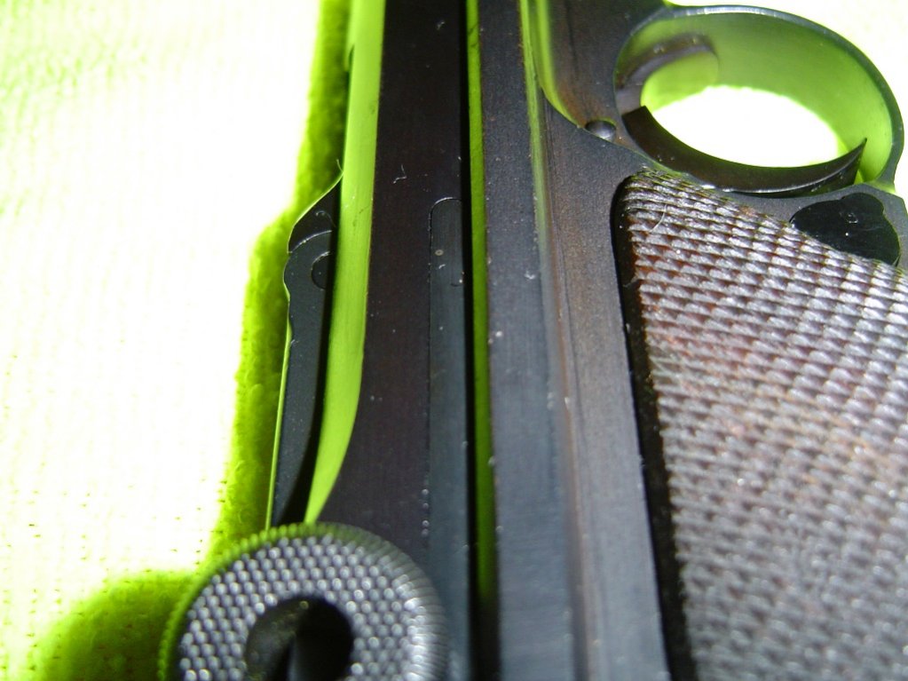

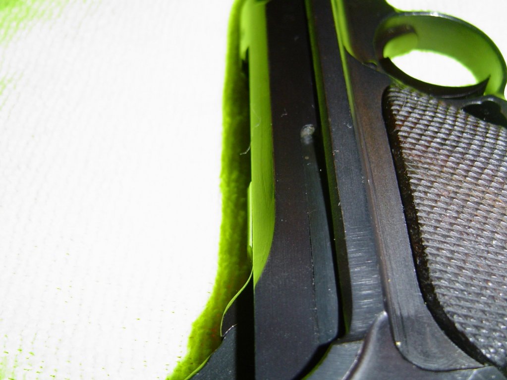

So I'll go step by step to troubleshoot,
Right Side Opened click here
Right Side Closed toggle click here
Extractor from inside click here

Your ejector seems to be alright.
The problem is somewhere else.
If possible get a new magazine. You will have to follow the tests DonVoigt recommended and then report back.
PS. The 2 ejectors in the picture are new. They are spares that I keep just in case.
