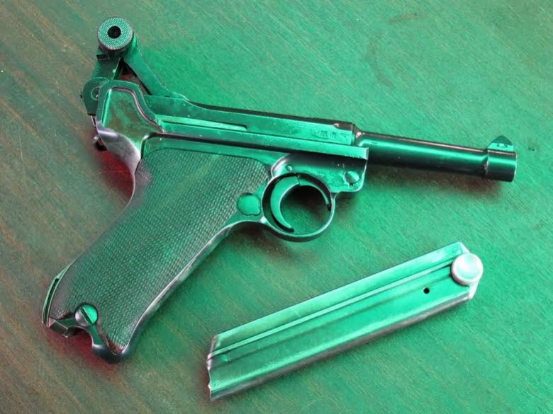

I posted some photos below
Best
Mario
S42 Photo Click Here
S42 Claw Click Here
S42 Seat Click Here
S42 Main Spring Click Here
Vlim 05-08-2016 09:17 AM
Can you show a photo of the other side of the pistol as well?
If the tip of the ejector spring (flat leaf spring on the right) is broken off, you will get the same result. The spring must have a triangular extension which contacts the front of the toggle (you will see that the front of the toggle 'bolt' has a linear groove in which the ejector spring 'rides'.

In Vlim's line of thinking I would also like to see a picture of your pistol taken just like this one:
Attachment 58736
Also would like to see another picture of the feed ramp but this time taken after cleaning.
mario17 05-08-2016 03:22 PM
Tx Vlim, and all
here is one I have, I will do like above with toggle up shortly.
Right Side with mag IN Click here
kurusu 05-08-2016 03:29 PM
Originally Posted by mario17 (Post 288210)
Tx Vlim, and all
Well, it seems you will need a new ejector.
With the action closed the ejector should be flush flat with the frame and not bent inward.

The ejector is one piece, it is itself the spring and has the right angle protrusion that strikes the cartridge.
kurusu 05-08-2016 04:38 PM
The most probable reason for the ejector being inwards with a close action is a broken tip in the breech end.
There are a few pictures in my next posts.
