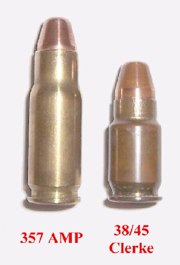

Have you tried the 124gr FMJ truncated cone Hornady bullets??? I used them in my 357 AMP and 38/45 Clerke cartridges...

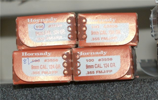

Unread 06-11-2013, 05:50 PM   #39
Originally Posted by Sieger View Post
Postino:
Yes, the Hornady 124 grain FMJFP bullet is one of my favorites for the 9mm Luger pistol!!!
This particular bullet ("called the Air Force Bullet") was developed for our military, some 30 years or so ago, back when they were considering the adoption of a 9 mm pistol.
In a Luger, if loaded to 28.7 mm of O.A.L., this one functions the action perfectly, and is highly accurate!
I am informed by the Sales Dept at Hornady that the 3556 FMJ-FP bullet in 100 count boxes has been discontinued -
Thank you for your inquiry. Unfortunately our SKU#3556 9mm 124gr FMJ-FP Bullet in the 100 count box has been discontinued. We suggest that you might look for SKU#35567B 9mm 124gr FMJ-FP Bullet in the 2900 count box.
Thank you again.
Hornady Sales Team
Phone 1-800-338-3220
I am wondering if there is enough interest in a 'group buy' for the 2900 count box...
Item Number 35567B
Ballistic Coefficient (G1) .160
Sectional Density .141
Quantity 2,900/Case
Price: $360.33
That works out to roughly $12.50 for 100 bullets...
You can still find odd lots of the 3556 bullets on GB, but not with any regularity...And the big dealers show the 2900 box as Out Of Stock...
