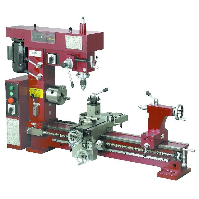

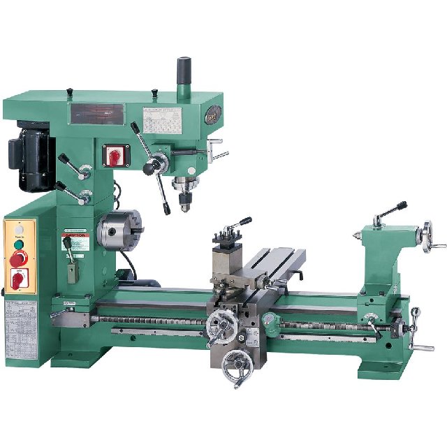

I believe the small discrepancy in the dial setting could be due to the feed screw being metric.
Or the threads being tight at one point and loose at another. Just another reason to buy American. Interestingly, the same 3in1 machine is sold by Harbor Freight, Grizzly, and Smithy with different nameplates and colors...
I have a short list of accessories I'd like to get for it from Grizzly; they import more accessories than the others...
Edit: Ha! Sears now sells the Grizzly 3in1 as well as Grizzly!!!
Here's the Harbor Freight [red] and Sears/Grizzly [green] 3in1 machines...
