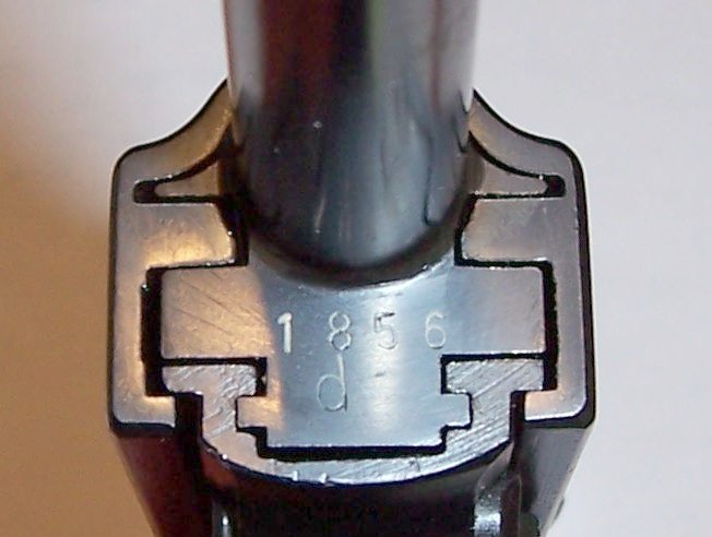

With the variance of only .009 it is initially difficult to imagine that the removal of a date or a crest (for example) could not be detected in this manner.
I would tend to agree. Even if a date stamp was only .010" deep, it would still likely be outside the specs if it was removed...but remember to measure off the stamp itself, as the edges of the stamp will raise up...

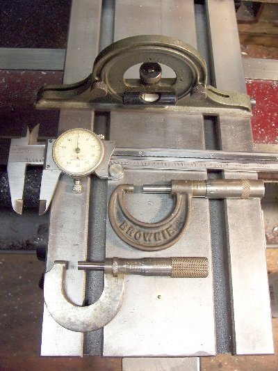

BTW...Since some of us are cops, truckdrivers, accountants, and gourmet chefs...Here's a pic of a couple tools I use...my dial caliper (also called a dial vernier), two 1" micrometers, and a machinists spirit level (degree gradations are on other side)...The Brownie mic was my dads; the silver one I got at a flea market basically for pocket change...The mics are dusty and somewhat "patina'ed" from not being used for...decades...because of the dial vernier/caliper...The machinists level I got off eBay; I use it for installing barrels and front sights...
The micrometers work just like a "C" clamp; you hold the anvil against the work and twist the barrel down until the spindle hits the other side of the work...and slide it back and forth just putting very slight pressure against the work......
The dial caliper you can just push the jaws against the work and read the dial...and then release the jaws...

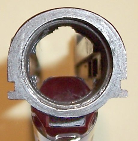

OK: I went back and re-measured all five of mine...This time I made sure I was *not* measuring across a date, or a number on the lug, or across a dent or ding...and I got several different measurements...so the letters/numbers and any dings or dents will affect the accuracy of the measurements...
I also made sure I was as close as perpendicular to the horizontal plane as possible...I noticed that if I went just a bit off 90º that the measurement would change...
The receivers are "fatter" on the sides than on the top/bottom...So the least measurement will be 90º from horizontal...or straight up & down...That's the one we want...
