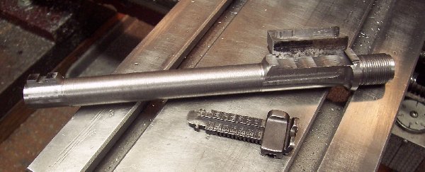

Got some work done on the rear sight base today...Cut the reverse dovetails; made sure it would be a tight fit; and hogged out the sight cavity...

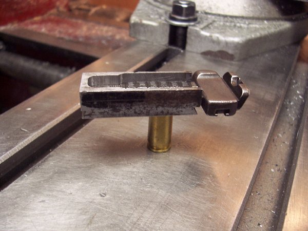

Unread 02-17-2009, 06:35 PM   #22
...and cut the slot for the C96 Mauser rear sight axle with a keyway cutter...Fits real good!
Need to locate the axle pivot holes and then mill the "slope" for the slider...I was thinking of shortening the C96 sight, but I think I'll leave it as is...If I have to, I'll mill a crescent in the bottom of the leaf to fit snug over the receiver (instead of notching the receiver)...
Heh...A 1000 meter Luger sight...

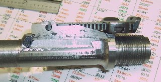

Unread 02-18-2009, 05:09 PM   #23
Got the rear sight base fit today; also fit the C96 rear sight to it...
Not too bad...I think I can guarantee some fistfights at the next ESACA gun show...

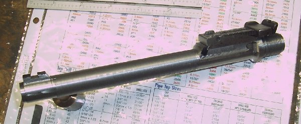

Unread 02-19-2009, 02:30 PM   #28
I am very interested in how you intend to cut the remainder of the front barrel band... and then then merge it with the small end of the barrel taper... take plenty of photos please including the actual cutting operation...
Kind of hard to do...while cutting...oily hands, concentration, paranoia...
But I shortened the front sight base a little; cut back the front of the rear sight base; turned the threaded portion back to specs & finish reamed the chamber; and finally cut the taper...The taper came out very good...

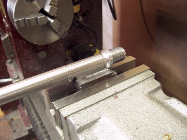

Unread 02-20-2009, 03:00 PM   #33
...???...Did I miss something???...
Posts come and go...
Oh, well...If anyone has any constructive criticism, please post away!!!
I roughed out a front sight blank today...It's installed, but I need to get some new belts for the lathe...The 5 year old 3/8" belts are delaminating...(I was wondering what that strange thumping noise was)...
I'll see if I can find some today and then re-mount my rotary indexing head again and finish milling the barrel flange to size; the same with the front barrel band; and then start in on the front sight...

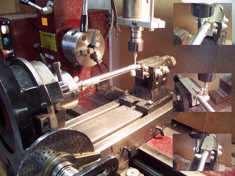

Unread 02-21-2009, 01:36 PM   #35
Originally Posted by Jack Lawman View Post
I do have one question... How do you index the barrel so when you screw it on the frame the sights are not canted?
Jack -
I left the flange a bit oversize. The most a Luger barrel can be off is .050"...(20 threads per inch = .050" x 20). I read in another thread here that 1/8 of a turn is about right for torqueing the barrel down. So the most the barrel can be off is 7/8 of a turn... or .044"...
My flange is at .170"...Rick W quoted me .135" for the flange on his artillery barrel...So I have .035" to play with...I'll screw the barrel on and torque it down three times, then figure out how much I need to thin the flange from there...(It's easier to do than describe)...
I'll take pics...Right now, I'm still milling the front sight to size...I've mounted my barrel in my rotary indexing head and milled the front sight band and flange down, 4�º at a time...and milled the front & sides of the front sight flat with the barrel base...
This barrel is easier than most I've done...It has a convenient flat (rear sight base) for spirit leveling...that's what I'll use to level the barrel in the receiver.

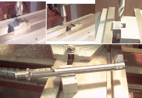

Unread 02-21-2009, 04:38 PM   #36
Lots of setups and just flat work in this project, takes a lot of time and planning.
I've been on vacation this week...
I liked the comment on the spirit level; a little something for me to ponder..
I found a nice little [3"] aluminum one at Home Depot...
Got the front sight roughed out...more...It won't look exactly like a Luger front sight; no way I can do micro-machining like that...which is why I mounted my sight before machining...
So, I roughed it to shape, milled the sides at an angle, made a crude arc to the leading edge...I made the height the same as the rear sight leaf top...It's too tall, but I'll have to think a bit as to how high to make it...

Got a couple of little things finished...Cut a couple scallops in the rear sight base sides to mimic the LP08 base; re-cut the front sight ramp (I had used 60�º instead of the 40�º called for in the blueprints; I settled for 45�º); cut the muzzle back; re-cut the sight arc...
...It's getting there...
