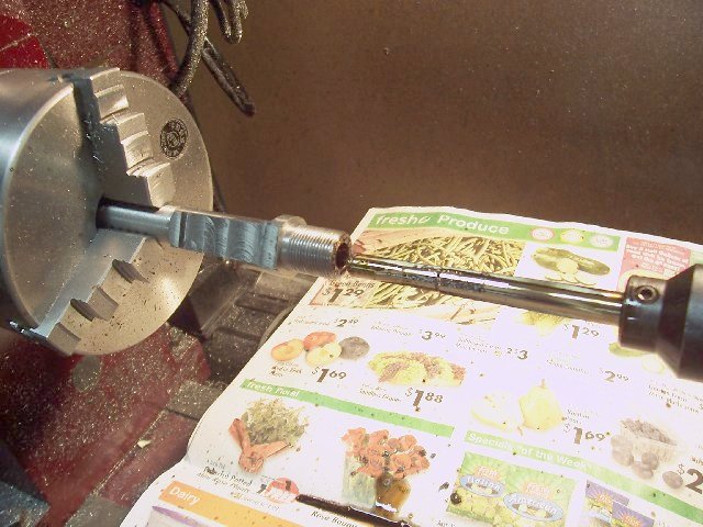

Written October 2014 by Rich B. 'sheepherder'/'postino') Hello! I'm re-barreling a commercial Luger with what I hope will look like an artillery barrel...I've done barrels before (pic of Lahti below) and have already started on a Luger Artillery barrel... I can pull the approximate dimensions from pics here and elsewhere, but a "print" would be helpful...Is there one available anywhere online??? Thank You! ![]() Last edited by sheepherder; 10-23-2014 at 11:35 PM. |

Quite well, thank you!
![]() Slow...I can only work on my day off, and Sunday...slow...like molasses in...now... ![]() |

I'm looking at John's Blueprint CD (Thank You, Sir!) and I find it puzzling that DWM (and the other P-08 contractors) used 20tpi for their 18mm barrel thread (and 55�º for the thread angle instead of 60�º)...
20tpi isn't a metric size; John's print clearly shows that the thread pitch is 1.270mm...which works out to 0.04999985in...for comparison, 20tpi is 0.050in...Too close to be coincidence... And it's not just Germany...The Swedish/Finnish Lahti shown in the first post also uses an 18mm x 20tpi thread... Does anyone know why the Europeans would use an inch thread pitch??? The closest Metric thread pitch is 1.25mm...Which is quite common...and works out to 0.04921245in...Close, but no cigar... On an unrelated note, while digging through my parts boxes from the '80's, I noticed that I have one of my home-made 150mm barrels lying around...It's been shot, and I can see some marks from the breech block, but I have no idea why it's still here...the two Lugers I owned back in the mid-'90's both had 150mm barrels on them when I sold them... I guess it's true...A mind is a terrible thing to waste... ![]() Last edited by sheepherder; 02-16-2009 at 10:49 AM. Reason: duh |

The DWM factory, part of Ludwig Loewe & Cie., were involved in standardization processes, a bit of a Loewe hobby, so to say. Ludwig Loewe himself spent many days in the USA, studying the American production methods and introducing the processes in Germany. This was the forerunner of the later German DIN standardization norm. In other words: German industrial standardization is based upon American production methods. |

Actually, the 55�º thread pattern is the British Whitworth form originally proposed in 1841 and subsequently adopted as the British Standard Whitworth. It was the best standard in Europe at the time and, as noted, used by several/most manufacturers. The American Unified Course standard uses the 60�º thread angle. Even the Luger grip screws are Whitworth pattern.

![]() I got some more done today, along with finishing my taxes...As per popular request, here's more pics... First pic is cutting the rear sight dovetail; second pic is cutting the front sight dovetail; third is rough cutting the 9mm Parabellum chamber (I use Clymer finish chambering reamer w/high Sulphur content cutting oil; feed in 1/32" at a time, back out & blow chips away)... |

...fourth pic showing some of the chips while chambering; fifth pic shows a re-sized 9mm shell in the new chamber; sixth pic is what we have now...
The rear sight base has been contoured at rear; rear sight base is ~1/10" longer than Luger because I'll be using a shortened Mauser C96 tangent rear sight. Front sight dovetail is 5/16"; smallest I could find, which means my front sight will be fabricated in place. Muzzle and breech have been turned down slightly. Breech (where thread is) is still about 1/8" longer than needed, and thread diameter is still a bit oversize. Chamber will be cut deeper and headspace reamed in when breech is cut to length and barrel is fit to receiver. I'll start on the front sight blank and rear sight base next. |
