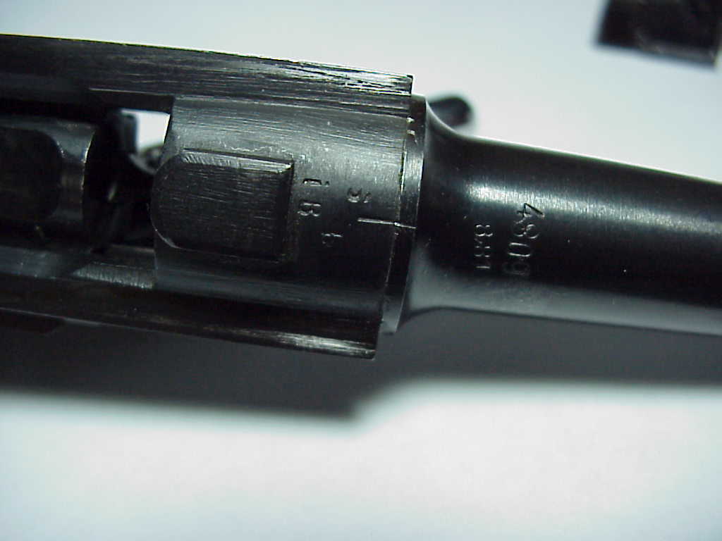

Thanks Doug. After seeing your photo I can clearly see how eagle-eyed John was able to tell my magazine had been remarked.
How does the barrel on your P.08 look? Does it match the rest of the pistol, or is it a slightly different color like on mine?
Mike

Posts: 68
Thanked 2 Times in 1 Post
Hi Mike, The bbl. is like yours, a little shinier than the rest of the pistol. Doug

Thanks Doug. With two similiar samples the question now is: Do both of us have refinished barrels, or is this typical wear for our w block 1939 Mausers?
Any ideas or thoughts from the forum experts?

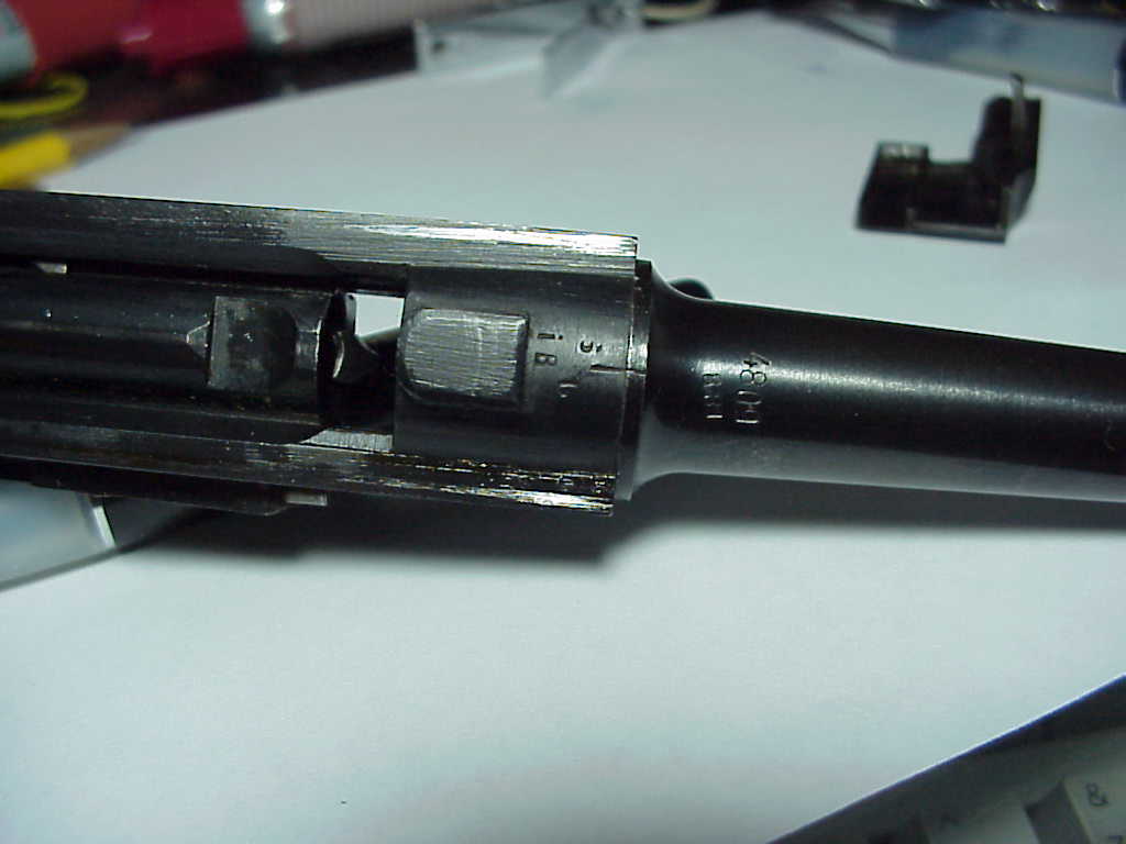

Hopefully here is a picture from mine. Doug

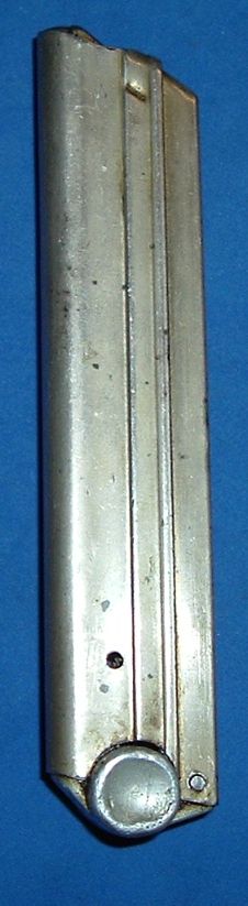

Frank,
How would you classify this one. Is this a Type 1? There are no stamps other than on the base.

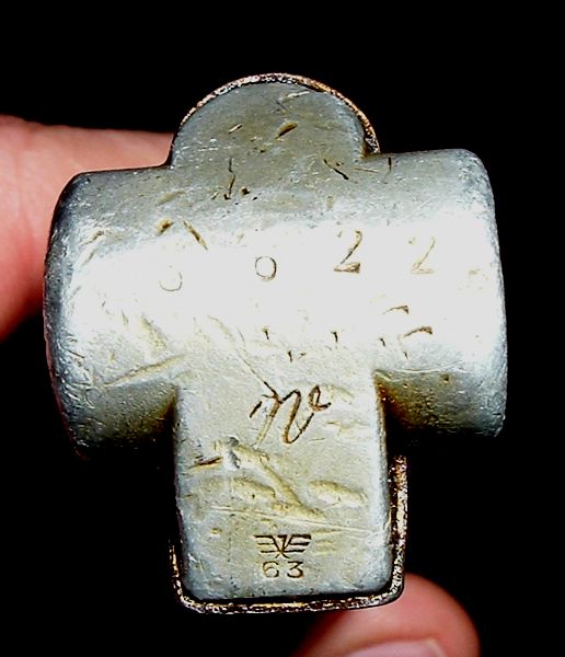

Mag Base. Notice that the script of the "w" is different from the other mags in this thread.

Mike, this one is for a 1937 S42 Luger. It looks like a Type 1, but it probably is a Type 1 tube and the bottom was changed out. It should be a Type 2 body!

That "w" above looks like a modified "n" to me...

Looks like an Erfurt tube with the squared crimp (instead of half round).

grapppa, the suffix letter is a "w"!! the 1937 magazines had this suffix, sometimes reported as a "nv".
