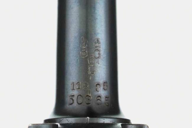

Unread 01-05-2008, 01:38 PM   #26
Some "halo" photos previously posted on the forums :
Unread 01-05-2008, 01:44 PM   #27
Dwight,
Regarding your comment of :
" GERMANY export marks are stamped after blue. "
This discussion thread ran over on Jan Still's gun boards. Some folks tended to think that on some AE's, the Germany stamping is done before bluing...both M1900 and M1906 AE were in the discussion...
I think the "Germany" should display halo (i.e. like you said, stamped after bluing...). But maybe both conditions are right and one needs to look for signs of a rework on a gun with a no-halo Germany stamp or look for signs of original finish on such a gun.

Unread 01-05-2008, 02:22 PM   #28
Pete,
Thanks for posting the pics. I recall the gunboards discussion, it was pretty inconclusive. My point to Alfred was to stress that that there are many exceptions to the expected observation of halo--the GERMANY stamp is one of the more striking--and that absence of expected halo, or presence of halo where it is not expected, while requiring a closer look, sometimes is authentically noted.

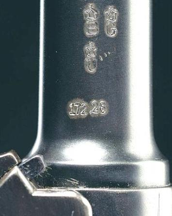

Unread 01-05-2008, 02:33 PM   #30
Some other halos photos posted over on Jan Still's gun boards in the past :

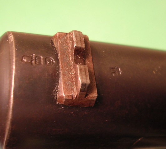

Unread 01-05-2008, 07:10 PM   #34
Two more show & tell photos :
A M1908 Navy Luger...that Joe Salter had for sale some time back :
And this next photo is for you, Vern...
BUG proofs on a Borchardt pistol that show strong halo...gun was obviously refinished and the mechanic thought to "add" halos back on...looks like with some micro-sand-blasting tool...
(Ron Wood and other guys that know Borchardts have stated in the past that you should never see halo on the BUG proofs on Borchardts...)
Gun was on a previous RIA auction.

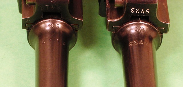

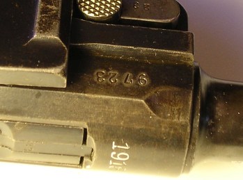

Unread 01-06-2008, 09:38 AM   #36
Heinz
Heinz's Avatar
Location: Greenville SC
Posts: 1,004
Thanks: 377
Alfred, the presence or absence of a halo depends on the model of pistol and the manufacturing process followed at the time. A halo will appear on Imperial Lugers in some places where it does not appear on later Lugers. A careful study of what is expected can be very useful in determining the originality of a finish.
Here is a halo around a Germany export marking on a 1920 alphabet Luger
[The following two images compare a 1918 Imperial P08 to a reblued 1915 Imperial P08. This example is somewhat extreme but immediately shows the differences:
A shot of the reciever halo on the 1918. This is a stamping done after the parts were blued.
The 1914 Mauser was stamped on top of the barrel prior to polishing and bluing; no halo is present, but it is not expected:
Halos may be observed on unblued parts. It is the mechanical polishing that removes the metal distortion that causes a halo.
