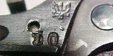

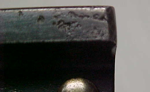

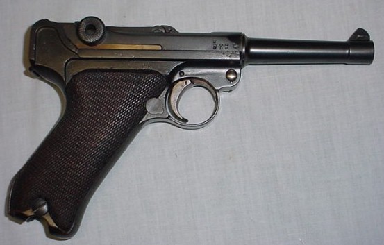

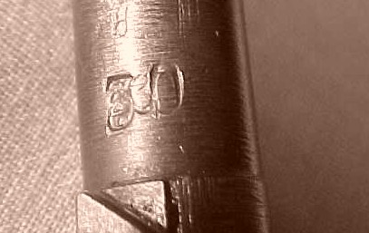

A friend was out on the range yesterday shooting his Desert Eagle when he noticed an old acquantance of his banging away with this 1916 Erfurt. In short order, the person shooting the Luger approached my friend to renew an old friendship. During the conversation, he asked him if he might know of anyone who would be interested in purchasing his Luger. Well fortunately for me, I was first on his list and he called me that night and told me the story. I was able to "borrow" the Luger and present it to the forum for evaluation. It is in really good condition in my opinion. The only one problem I see is the number stamped on the breechblock seems to be over-stamped. It appears as though there was a "30" then it was stamped with a "10" or possibly or some other number. Can anyone shed any light on this situation? The only other problem I see is there are two magazine, both of which are incorrect. One is a black widow fxo and the other is an aluminum bottom with an eagle 63 proof. If I do purchase this Luger, I would like to swap either one of these for a NICE Erfurt magazine. If any other comments are in order, please don't hesitate to make them. Thanks again for the all the help in the past, Mike.

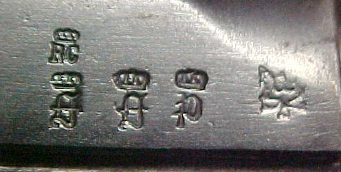

Shouldn't it have a cut for an Artillery rear sight? Odd that it does not, yet has RC markings and Erfurt proofs. Wonder if this one slipped by? The number on the breach block bothers me. I think it broke the original and someone tried to fix the problem. I would say value to be $5-600, it will bring that much broken up for parts.

That is my delima. Is it just a shooter with the double strike. He wants me make him an offer. I like the Luger, and I am truly disappointed with the flaw, but I am not sure of the severity of the flaw. I noticed the "crowed RC" proof. Could this have been done as an arsenal repair procedure?

Still (Imperial Lugers p.61) notes that "almost all" 1916 Erfurt have the rear sight receiver cut, but also notes that the dimensional tables were not amended until November of that year. This gun (no suffix) was made within the first 10,000 examples of an estimated 80,000-pistol run that year, so the lack of a sight cut is not particularly worrisome, unless someone comes up with statistics for early guns in that range with the cut.
The c/RC Revisions-Commission stamp means only that some part was sufficiently out-of-tolerance to go to a higher authority for acceptance. It does not indicate a rework of any sort.

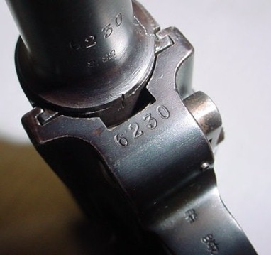

There is no accounting for the overstamp on the breechblock. It might be useful to photograph it in different lighting conditions--direction, hi contrast vs. low, etc., to see if anything more can be drawn from it. It occurs to me to wonder, what is the firing pin serial number?
It appears that the front of the frame rails--both sides--are somewhat pitted. It is hard to tell from the phtots, are the pits blued to the bottom?
I wouldn't read anything into the magazine selection with this Luger. Its been 90 years, through the ownership of no-one can know how many people, and there is no accounting of what owner came up with what magazines to go along with it, whenever.

Here are a few more pictures with a different camera set in a different mode. The firing pin is restamped as well, but not as badly as the breechblock. It appears that the blueing is all the way to the bottom of the pitting, but it is really hard to tell. I have a picture of that as well. Thanks again for another very informative reply.
