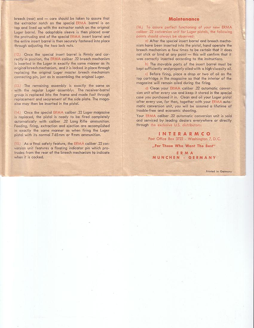

I was wondering if anyone has ever installed one of the Erma Werke .22 conversion units by Interarmco (or any other brand) in a Luger. I've got one of these units in a box but have never tried to install it. Does anyone have any comments on how they shoot? Any suggestions on installation?

Hello Brent B.
This is a scan of the instruction manual of one of my ERMA WERKE .22 Cal. conversion units that came from INTERARMCO in the green cardboard box.
Ed Roane
http://forum.lugerforum.com/lfupload...0001_copy3.jpg

Sorry, I somehow got the pages out of order.

Ed: I really appreciate the instructions. I was late getting into the office this morning and just saw your posts. I'm printing them out and will give it a go later today when I get my work done. Thank you so very much.

Brent, One thing that the instructions may not say, is to press in the trigger bar (sear) when inserting your toggle assy, so that you are not working against a cocking firing pin. TH
