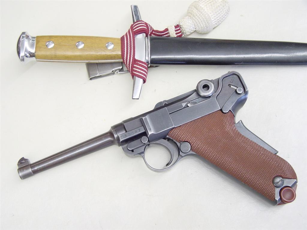

Simo,
Here is another photo showing a pretty honest, authentic M1929 Swiss luger as well...this seller is in DE :
http://www.collector-arms.de/produkt_images/43000.jpg
