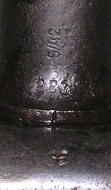

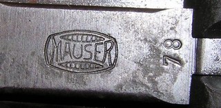

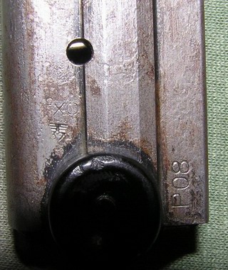

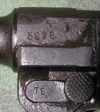

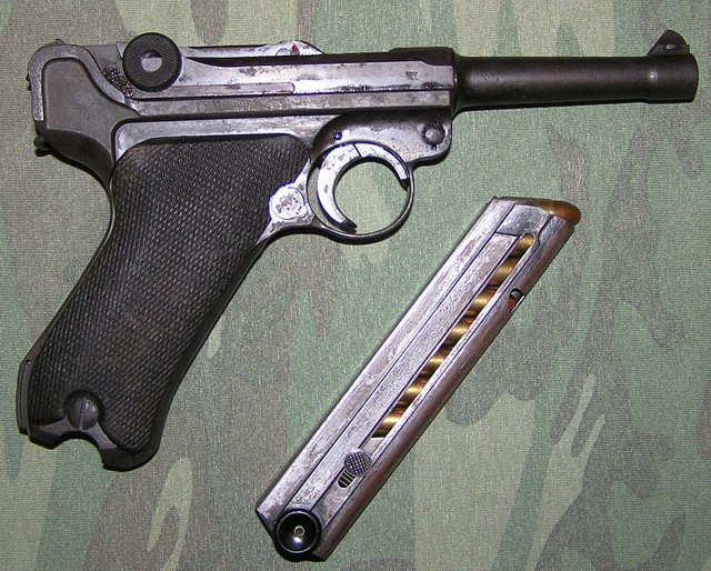

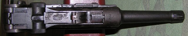

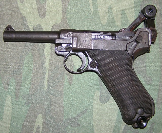

After reading forum topics I think my Luger is Police model made by Mauser, what did you think about mismatched number 69 (last two digits everywhere is 78)? What can be the reason? This pistol comes to our family from Berlin at 1946 and only few weeks ago become mine.

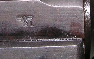

Kolos, you are correct, it's a Mauser Banner Police first issue in the x suffix. The S/42 stamping on the bottom of the barrel probably indicates that the barrel is a Mauser replacement part. That may account for no serial number on the barrel bottom. I also cannot find any information on the Nazi eagle proof on the left side of the reciever. As to the trigger plate being a different number, many Germans when captured and told to hand over their weapons would remove the trigger plate and throw it away making the pistol usless until a replacement part was found. In this case the replacement part was from another Luger and not a new one from an armorer. I'm not an authority on police Lugers but I believe this info is correct.

Your pistol looks like it needs a good cleaning and there may be active areas of rust that should be addressed so the rust and pitting does not continue.
Author Jan C. Still in his book on the Third Reich Lugers on page 139 estimated (in 1988 when the book was printed) that there were approximately 1,115 lugers similar to yours made IN 1941 (i.e. Mauser Banner, 1941 dated, eagle/L proofs, sear safety).
