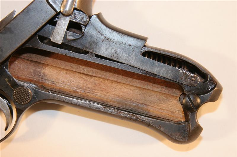

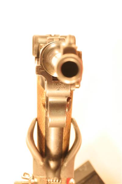

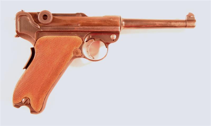

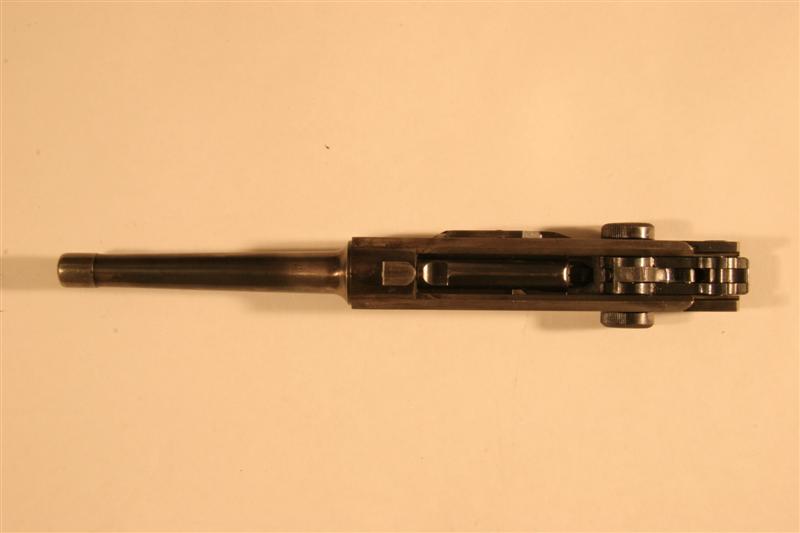

Luger Forum member, Steve Anderson, would like some information and thoughts about his DWM Alphabet luger.
Here is some basic info :
1. DWM Alphabet luger.
2. Serial number 2765i.
3. 7,65 mm caliber with 4-3/4" barrel.
4. Has "Germany" stamped on front of frame.

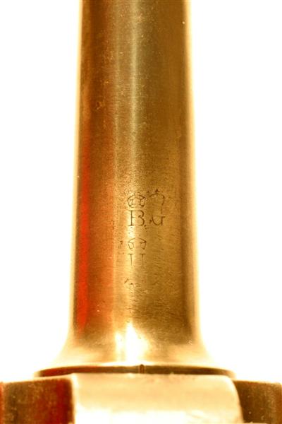

5. Has old BUG proofs on underside of barrel. Bullet bore stamping and serial number not visible on barrel.

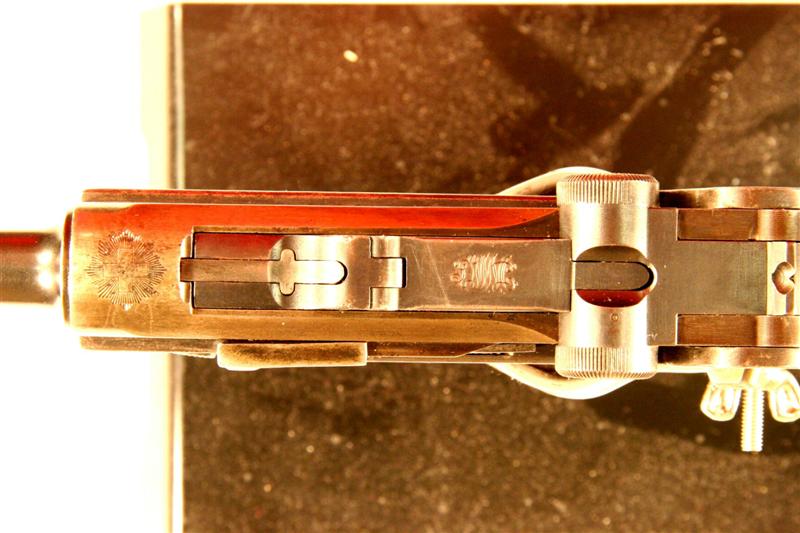

6. Has a Swiss cross/sunburst on chamber.
7. Has what appears to be a faint Crown/N proof on the left side of the receiver.
8. Does not have any little Swiss cross proofs or Bernerprobe proof marks, anywhere.
9. Falls in the middle of the Abercrombie & Fitch contract serials.

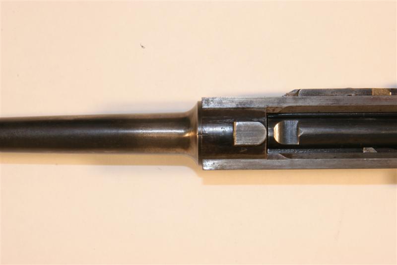

10. Barrel lug is not stamped "65".

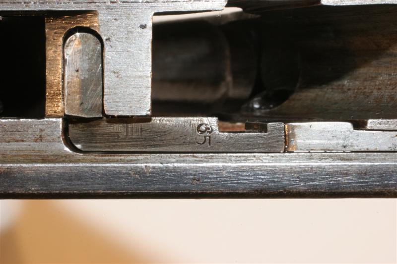

11. Other small parts numbered "65" in commercial style.
Others on Jan's Board have commented on the long frame/receiver and the fact that the grip safety is not "65" stamped along the left side.
Unread 10-06-2005, 07:56 PM   #2
Unread 10-06-2005, 09:19 PM   #3
drbuster
drbuster's Avatar
Posts: 1,432
Thanked 71 Times in 56 Posts
This Luger looks to me to be a mish-mash of parts. It has what looks like an early 1906 American Eagle frame (Germany stamped on front, flaming bomb proof in well), a commercial Swiss receiver and commercial barrel, and an un-numbered grip safety. It has a suffix on the front of the frame that looks like an "i", but I cant make out the dot on top. We all know about the post WW1 "i" series. It included DWM/Krieghoffs, all types of various Swiss commercials, and apparently just piece guns. I doubt that this Luger went to Switzerland as the grips and finish are too worn to be typical of those proud gun owners.

Does anyone remember the timeframe/year that the vertical C/N proof began in use...?
Unread 10-07-2005, 12:00 AM   #5
drbuster
drbuster's Avatar
Posts: 1,432
Pete, I believe, for the luger, it was some time in 1912. My 1908 commercial, serial #59055, has C/N proofs, and was made, I am told, in 1912.
Unread 10-07-2005, 12:14 AM   #6
The "lazy" C/N proof began in 1906. The vertical C/N began in 1920.
Unread 10-07-2005, 04:12 AM   #7
I thought the change in the German proof law from c/BUG to c/N was 1910? I understood that sometimes a skinny c/N was added to the c/BUG marks as a Nitro proof under the early law, on the side of the front toggle?
It will be interestng to know if the GERMANY mark overstamps the i suffix, also if the extractor says GELADEN or LOADED.
Unread 10-07-2005, 09:46 AM   #8
drbuster
drbuster's Avatar
Posts: 1,432
Ron, I don't know where one can look up authoritarian data on this subject, but I think you are kind of early. And I also recall that Dwight's comment is correct. I don't know if the conversion from BUG to N came gradually in a transition or all at once, but it probably happened between 1910-1912. I would bet the extractor says Geladen.
Unread 10-07-2005, 12:45 PM   #9
You guys are right. I tend to think in terms of model year and 1906 model Lugers are in the transition period, so some are BUG proofed and some are N proofed. Since the 1908 Commercial can also be found with either BUG or N proofs, obviously the change came after that date.
