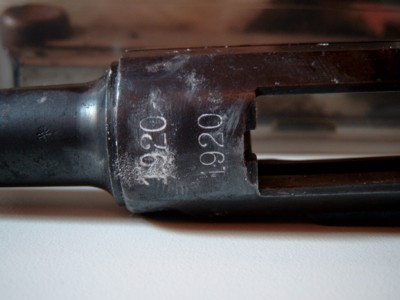

Hi Don
Here is a photo of the camber marks, they are as you see not identical ??.
Could it be, that this gun, first was a commercial gun, and after this, it went to the Police ??. I think that the mark under the "n" on front of the frame is a "b", same as on the barrel.
Regards Jes

Unread 10-05-2005, 09:46 AM   #19

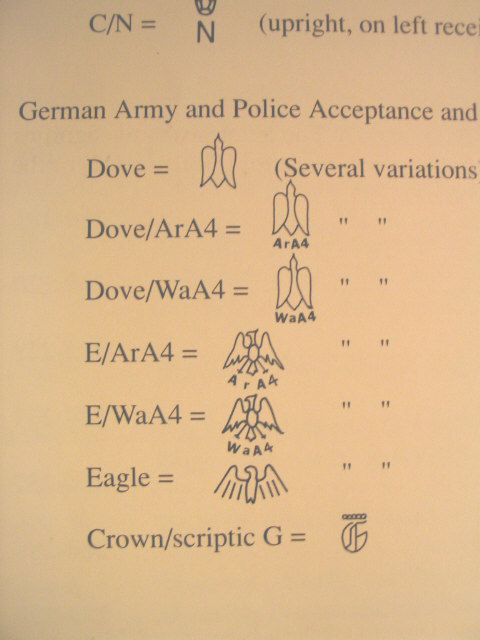

Jes , the lower 1920 is the year of manufacture. The upper is the Weimar property stamp.
The proofs/acceptance marks on the right side of the receiver should be a combination or grouping of the following.
Taken from Jan Still's Weimar Lugers.
