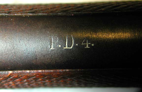

P. D. 4. on a 1920/1918 DWM #7758i, has sear safety but no mag safety.

P.D.4. is an unknown mark, possibly Polizei Direktion. I have P.D.18. and P.D.471. in my database. Here's a discussion about the latter: http://www.gunboards.com/luger/topic.asp?TOPIC_ID=1844

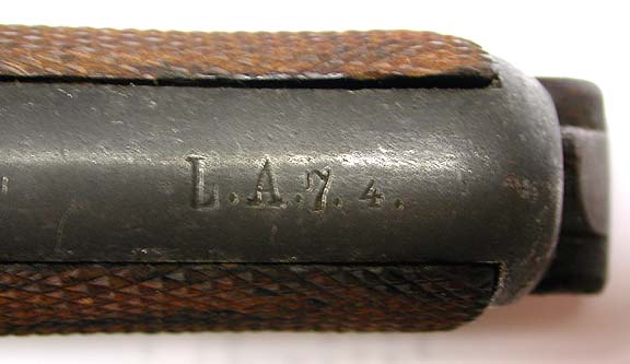

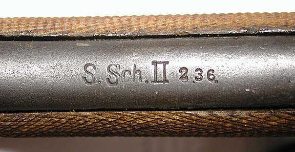

Here are pictures of the two marks mentioned in my previous post. I have also added two more for discussion! Unfortunately the last two are mixed number guns with the cannons having different SN's than the frames, so I don't know the dates they were made.
I believe this is Police Schleswig District 2 weapon #236. On a DWM frame.
I don't think that this one is a police mark. I believe it to be either Luftschiffer-Abteilung (Airship or balloon) number 7, weapon #4 or Field Artillery, Battery 7, weapon #4. This is on an Erfurt frame without a stock lug. Anyone have thoughts on this one?

The Gumbinnen and Schleswig marks show evidence of earlier marks that were ground off. The earlier marks may have been in conformance with the 1922 orders and contained numbers for the Hundertschaft/Berietschaft (riot squad) to which they were assigned. Presumably, at the same time the Berlin marking format was changed, the format for all other Prussian Schupo was simplified to eliminate this designation.
I really don't know what the L.A. mark is. I am confident that it is not a Landj�¤gerei mark because the Landj�¤gerei did not include anything other than the administrative district and the weapon number. Does the pistol have a sear or mag safety? Here's a link to a similar mark: http://forum.lugerforum.com/showthre...threadid=11894
I would appreciate knowing the serial numbers of the latter two (frame s/n for the Sch). If you prefer, you may email me at donmaus1@aol.com.
