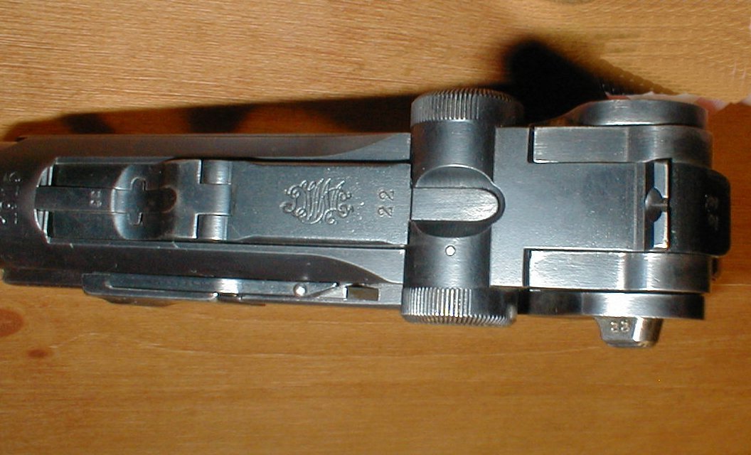

I just came into a pistol from a family member. I have been studying a little on the forum, great info, and I'm ready to dive into my first post.
After looking around for info I have determined so far that it is a 1915 DWM, proofmarked for the military. (three crowned icons and an eagle).
It is all matching number, short bbl, lanyard ring, stock lug, wood grips. and wood plug mags that don't match numbers.
The serial number is low 300s with an h suffix placing it in I figure about the 80 thousand range.
It has the hold open device. It locks back on an empty mag but will not unlock on a full mag. Is this normal? It functions properly if I release the toggle before inserting the new mag. I am used to browning style autos that will close on a new mag with a slight pull to the rear.
In the member gallery is a 1916 pistol with the text that 1916 was the first year that the safety would allow operation of the toggle while engaged. This 1915 pistol will allow operation of the toggle while the safety is engaged. All numbers match on the safety and sear, etc. I suppose the 80 thousand range on it could indicate late production in the year and the transition could have already been in progress before the start of 1916.
Whaddayathink ?

Sandman, welcome to the forum!
Most earlier guns were modified, so that is why your 1915 displays this.
Can you show us lots of pictures?

Your Luger SHOULD unlock the toggle when pulled back and released on a new loaded magazine... if it doesn't try a different mag, and make sure that both the gun and magazine have an appropriate amount of lubrication. It should operate smoothely...

Thanks for the help. Just knowing for sure that it should operate that way made me take a closer look. Previously I tried a reload with just a couple of rounds in the loaded mag. I functioned the pistol while watching for the moving parts and found the place where it indexes to the magazine. A tiny drop of oil and a Full reload mag later it functions as designed when operated by hand. Everything else operates smoothly and neatly.
Before I got it, the toggle had probably not been pulled for over twenty years. Not bad considering that. ( I am planning to gently detail clean it after I learn and am confident with the disassembly ).

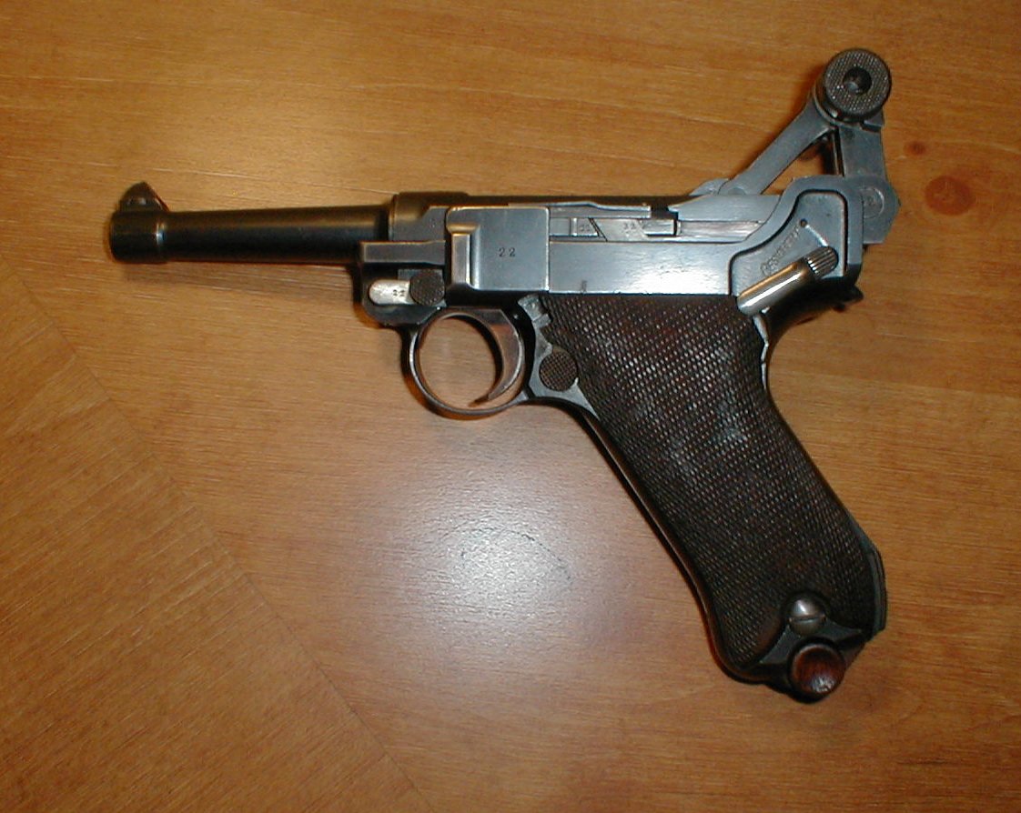

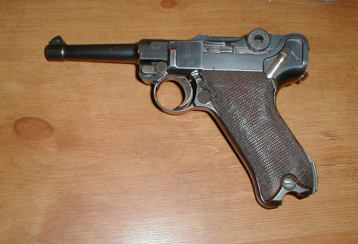

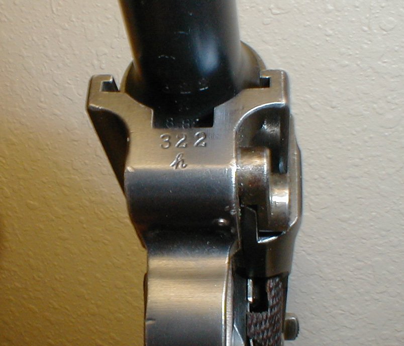

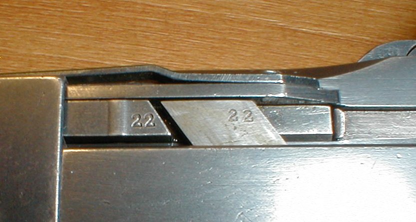

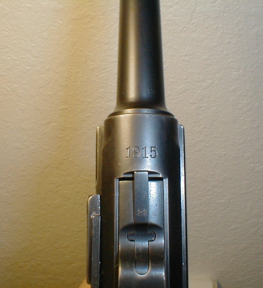

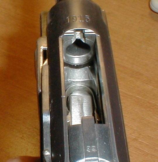

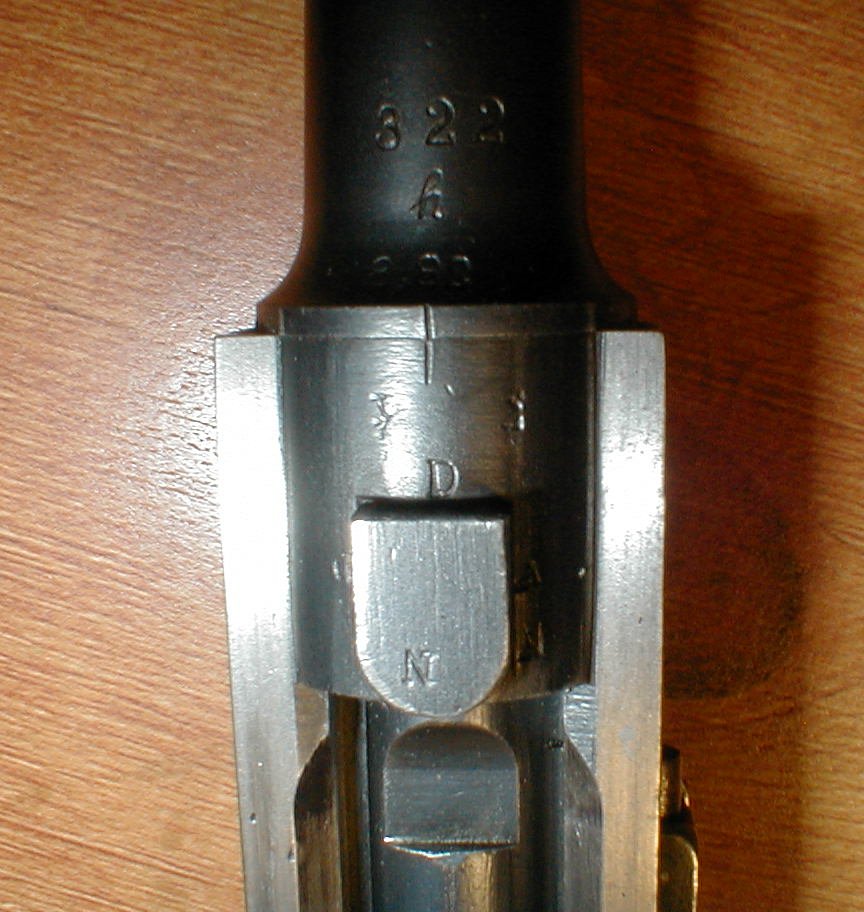

Here are some pictures that I did today.
I'd like to post an album, if I could get instructions.
Until then here are two and the URL's for the others I uploaded today.
This bore is excellent.
I thought the proofs might be the next most interesting.
The rest are available at these URL's if you paste them in the address of your browser.
http://forum.lugerforum.com/lfupload...bore_copy1.jpg
http://forum.lugerforum.com/lfupload/dwm15chamber.jpg
http://forum.lugerforum.com/lfupload/dwm15extr.jpg
http://forum.lugerforum.com/lfupload/dwm15front.jpg
http://forum.lugerforum.com/lfupload/dwm15left.jpg
http://forum.lugerforum.com/lfupload/dwm15lockbk.jpg
http://forum.lugerforum.com/lfupload/dwm15openchmbr.jpg
http://forum.lugerforum.com/lfupload/dwm15proofs.jpg
http://forum.lugerforum.com/lfupload/dwm15rear.jpg
http://forum.lugerforum.com/lfupload/dwm15rt.jpg
http://forum.lugerforum.com/lfupload/dwm15sfty.jpg
http://forum.lugerforum.com/lfupload/dwm15top.jpg

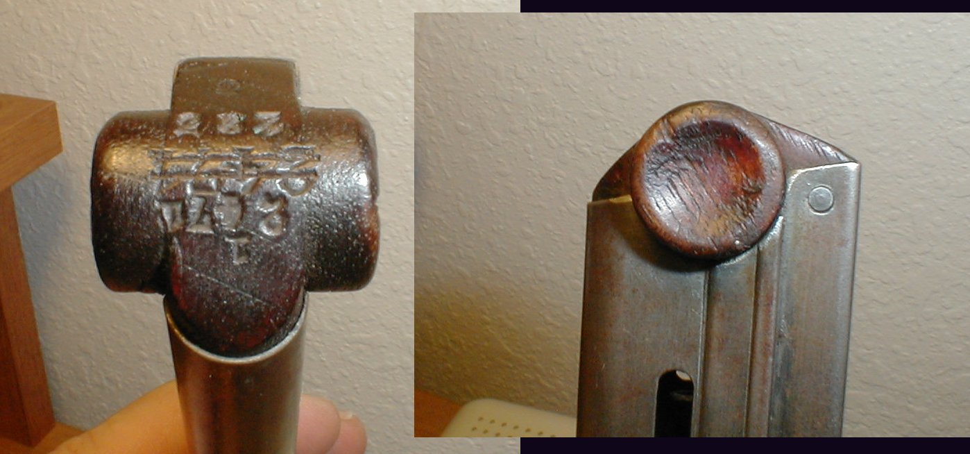

http://forum.lugerforum.com/lfupload/mag1_copy1.jpg
http://forum.lugerforum.com/lfupload/mag2_copy1.jpg
Have fun, and please comment,
Sandman

Your pistol was a Police pistol, as evidenced by the sear safety and the clipped magazine safety. Does it have any markings stamped on the front of the grip frame?

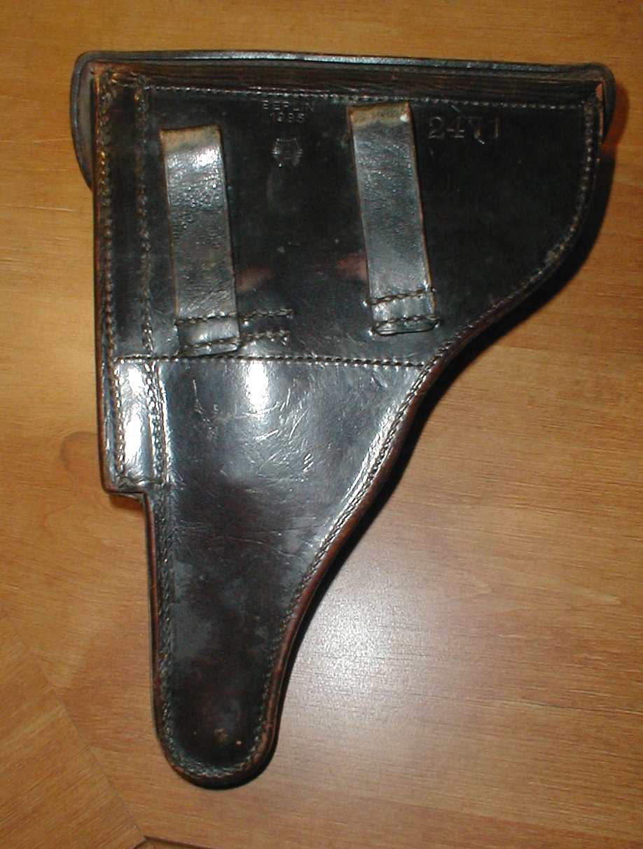

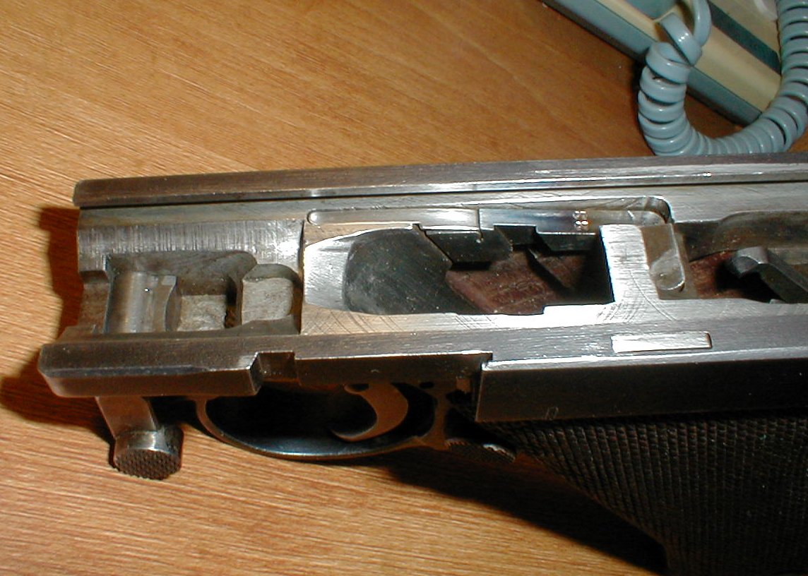

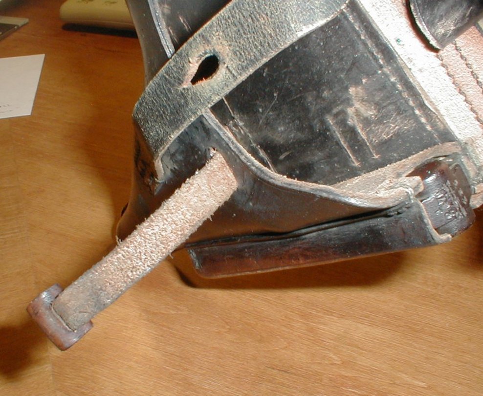

Thanks Hugh, today's pics will answer your question about the frontstrap markings.

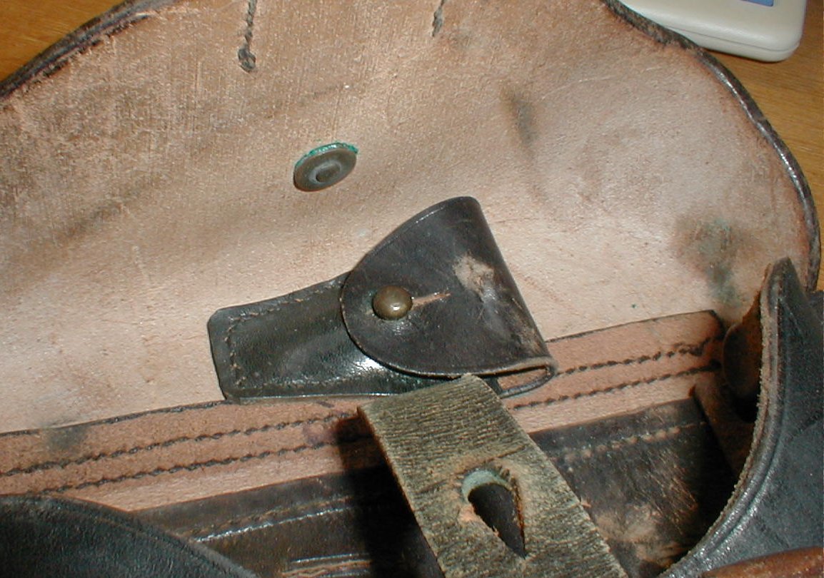

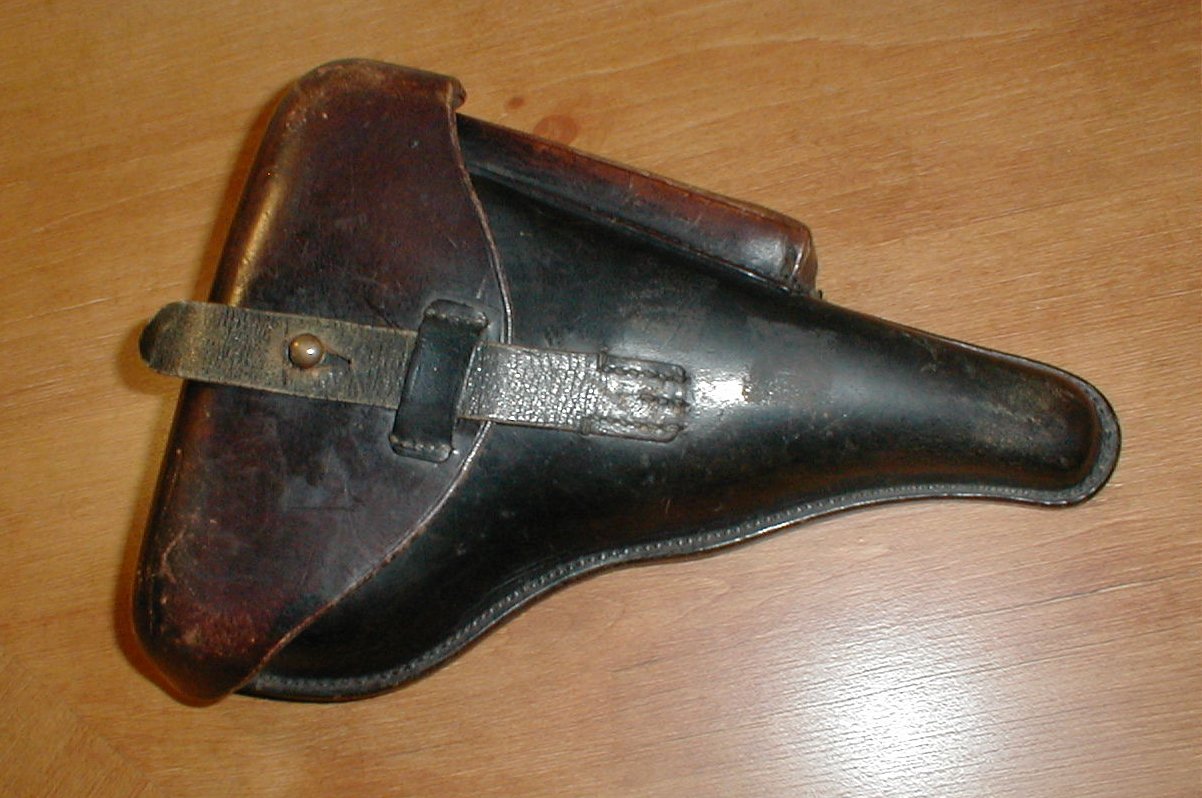

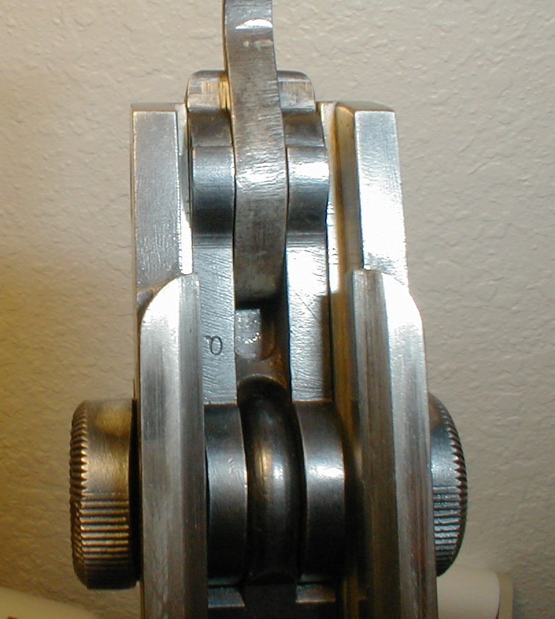

Something else to ponder...

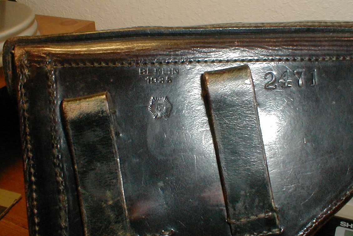

Here are some others, including the holster I got with the pistol.
http://forum.lugerforum.com/lfupload/dwm15undrtog.jpg
http://forum.lugerforum.com/lfupload/dwm15undrchmbr.jpg

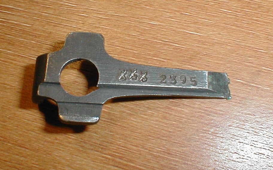

http://forum.lugerforum.com/lfupload/sndmnlugerkey.jpg
http://forum.lugerforum.com/lfupload/sndmn35hlstr1.jpg
http://forum.lugerforum.com/lfupload/sndmn35hlstr2.jpg
http://forum.lugerforum.com/lfupload/sndmn35hlstr3.jpg
http://forum.lugerforum.com/lfupload/sndmn35hlstr4.jpg
http://forum.lugerforum.com/lfupload/sndmn35hlstr5.jpg

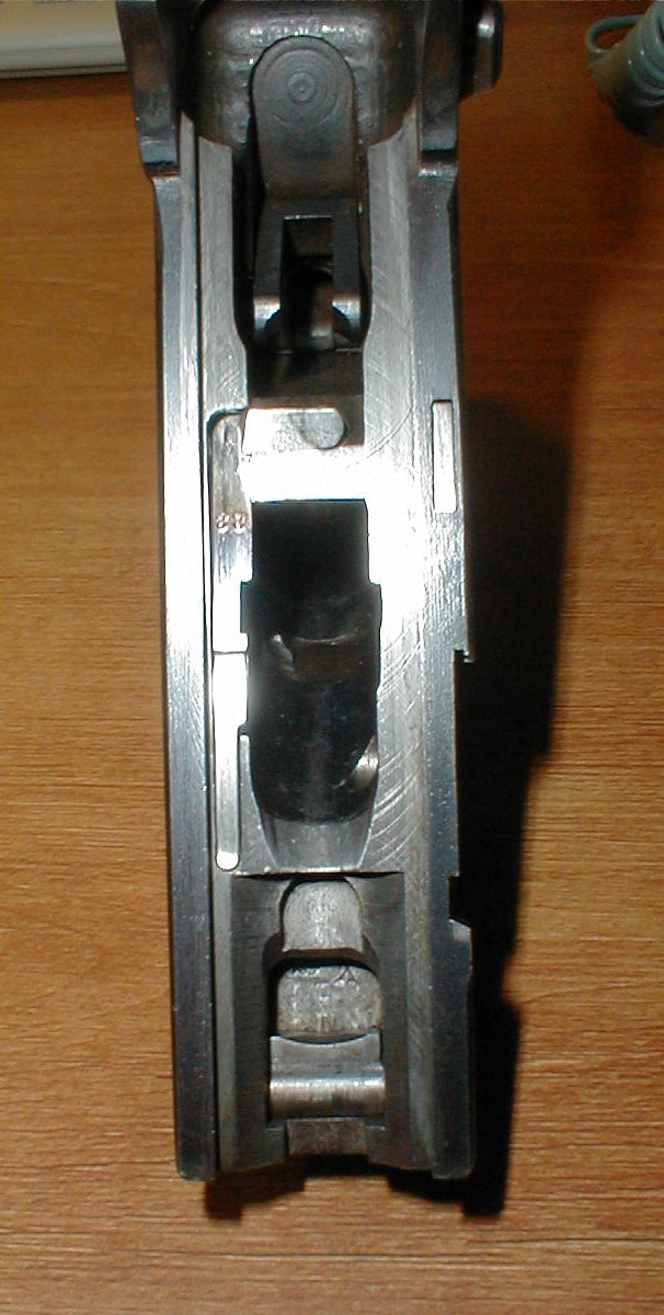

http://forum.lugerforum.com/lfupload/dwm15inrcvr.jpg
http://forum.lugerforum.com/lfupload/dwm15inrcvr2.jpg
Also what do you mean by "clipped magazine safety"?
Sandman

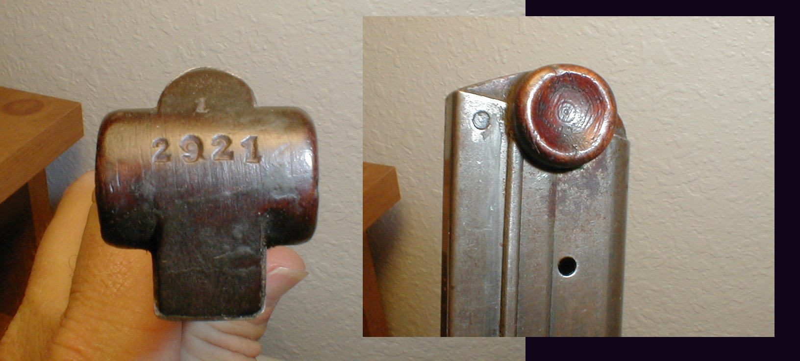

Just out of curiosity would this gun be legal with a buttstock??
I also noticed today that the mag I have, that was renumbered, matches the number on the holster.

The gun would not be legal with a buttstock.
When modified for police use, a "magazine safety" was installed. This device blocks the trigger when the magazine is removed thus preventing an accidental discharge of a weapon presumed empty. The device was cumbersome and really quite a nuisance, so it was either removed or the part that blocked the trigger was clipped off. You have a "clipped" magazine safety.

The marking on your Luger indicates that it was the property of the Wiesbaden Police, District 2, weapon # 336.

Thanks for alerting me to this thread. You have a very nice police rig with a proper (albeit not matching) black Schupo police holster.
