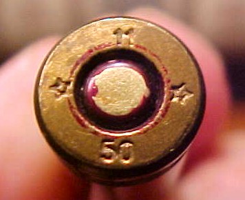

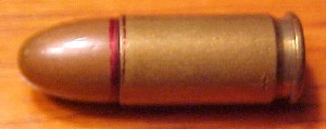

While you guys are chating about Luger rounds: I have been wondering for quite some time about a few 9mm bullets I have had for years. I am posting a couple of pictures. Please take a look and tell me if this is a common a round military round or what ever it is Thanks, Mike

I bought some of this ammo from Interarms, in Alexandria VA, back in 1971. I shot it through my P-38 with no problem.
I was told that it was Canadian military ammo. Whether or not this is true, I really couldn't tell you.
What I can tell you is that it is corrosive!!!
Please make sure you clean your pistol's barrel with soap and water immediately after shooting it, or you will have a nice surprise awaiting you!!
Sieger
