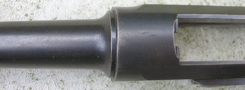

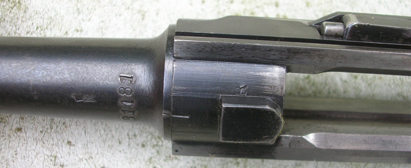

Hoyt,

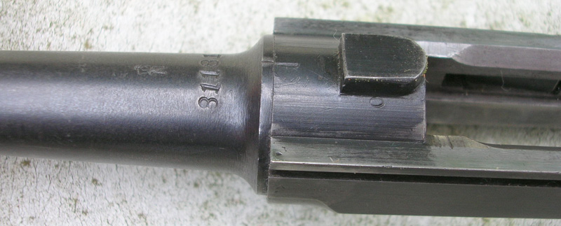

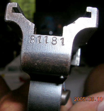

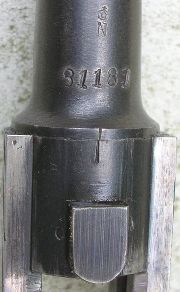

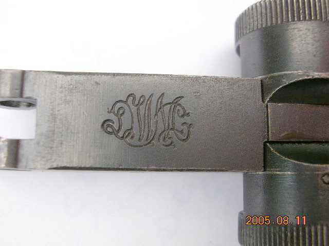

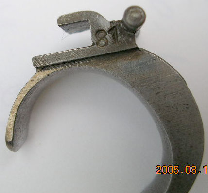

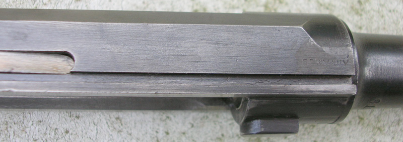

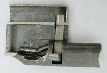

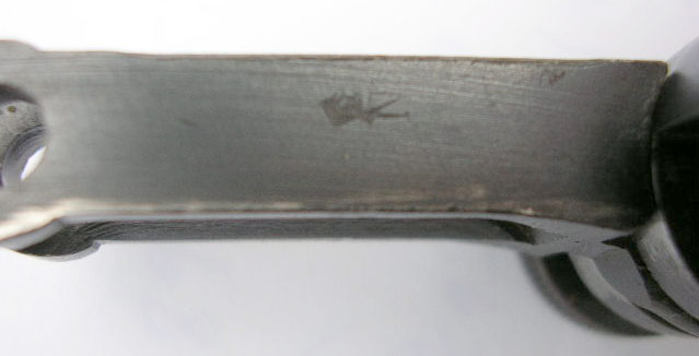

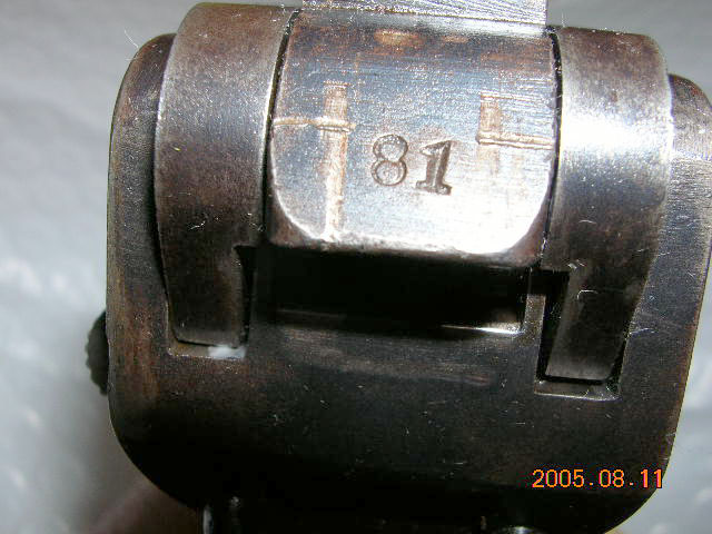

Thanks very much for this extensive, detailed photo study. The multiple-number stampings on some of the parts is cause for serious reflection.
Unread 08-19-2005, 02:33 PM   #5

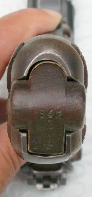

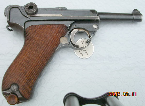

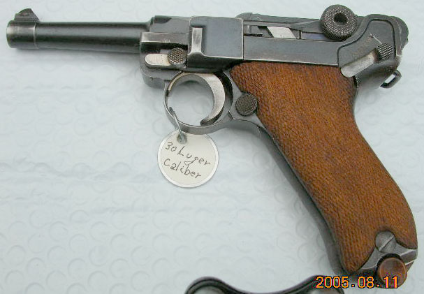

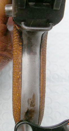

I beleive that this is a reworked military gun that was eventuallly imported into the USA... The misalignment of the witness marks means the barrel was removed at some point and either replaced or reinstalled... It also looks like the stock lug was ground off at some point. As was any chamber marking... the size and impression of the number stamps seems to be inconsistent.
The gun appears to be improperly assembled in the top photos because the upper assembly is in the rear position... likely that the mainspring hooks have not been engaged before closing the takedown lever...
Once properly assembled, it will be a fine shooter... or if you want to make it pretty, send it off to Ted Green (THOR) for a beauty shop treatment...

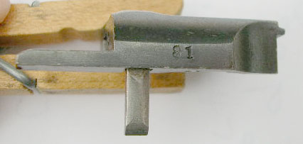

Thank you so much for down-sizing my pics and putting them into a logical order of sequence. The pictures were shot starting with the little parts and tiny markings and ending with the assembled pistol. I especially appreciate your inverting one image to see the number 81 properly rather than upside down.

You are quite correct that the pistol was not assembled properly. There is my starting thread on this matter at:

Hoyt,

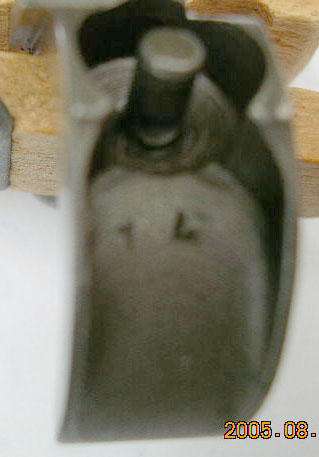

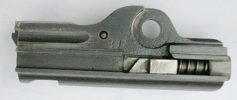

Yes, particularly the trigger and breechblock which have two sets of numbers.
The question, ultimately, is, how much of DWM's postwar commercial production was done from newly-produced parts, and how much from recycled or from-the-shelf military parts stock?

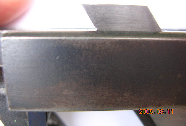

The front of the frame with the serial number looks like it has been faced off a bit, like a previous serial number was removed before assembly. It will be interesting to see the same area once the frame and receiver have been properly assembled, to see if the front of the breechblock sticks out a bit from the frame.
It appears that John S's comment about a ground stock lug may be a good one.

Dwight, I can take one or more close-ups of the rear of the grip where the stock lug usually is. The blueing is totally gone. As in NONE anywhere. Those pics will probably be in the 64 to 88 KB range, so I should be able to post them myself as images in another message in this thread. They may be posted Saturday or Sunday. Insha'Allah [ God Willing ]. ( I worked in Dhahran, Saudi Arabia for three years after I retired from NASA in Huntsville, Alabama. )

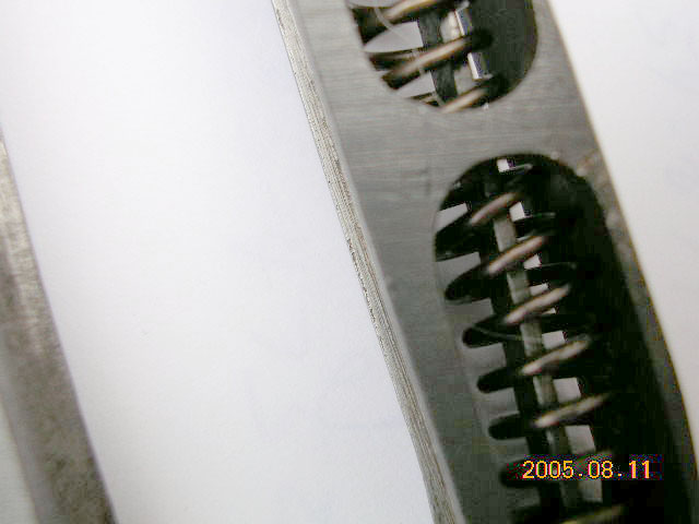

I am now at the point of trying to get the recoil spring assembly installed. I have two questions:
1. The hook on the upper end of the recoil spring guide bar should *face* which way - toward the muzzle OR toward the rear?
2. How do you guys get the recoil spring assembly *compressed* enough to get her back into the proper position?
At present I am using a small needle-nose pliers and a drill bit small enough in diameter to go through the hole in bottom end of the guide bar.
I have read that this is a [bad wordbad word of a job to get back into proper position. I can now confirm that.
All suggestions on a feasible solution to my present problem will be appreciated.

Take a look at and copy Thor's instructions in the Technical Information Section.
Thor was kind enough to provide explicit instructions on how to replace the mainspring. Following them makes the job easier. I've now been able to replace the guide and mainspring in about 15 minutes. Thank you Thor!
