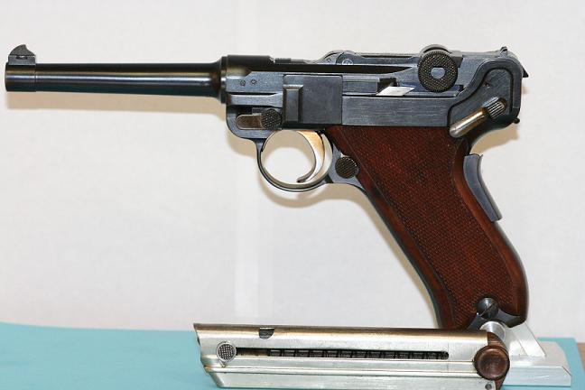

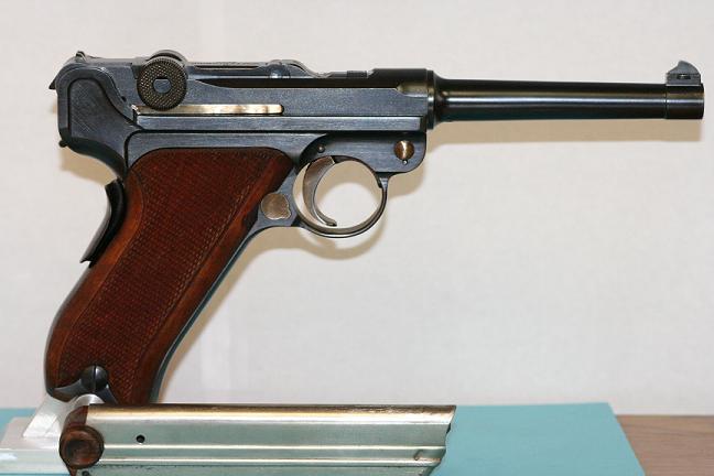

Just acquired the subject Swiss (my first Swiss) and was wondering how many of these are known in 9mm. I got it from Ralph Shattuck and forgot to ask. One of his notes indicates only two were known in the early '90s. Ralph did tell me only 100 were ever manufactured.
With all the collective knowledge on the Forum, I thought someone might be able to enlighten me.

Hi Chuck,
It would be really helpfu if you could take detailed, in-focus, close-up photos of the witness marks of your barrel/receiver (near the lug) and of the barrel's serial number.
If you cannot post them, send me your photos and I can get them posted for you.

Hi Chuck,
Your report of a M1906/24 W+F Bern luger in 9mm is a surprise, but then, again, not one.
I have noticed 1-2 '24 Bern's on Ralph Shattuck's tables at the past few Reno gun shows that were un-questionably reblued lugers and the origin of the barrels was a question; at least in my mind.
I would guess such a '24 Bern in 9 mm has had a barrel replacement since it left the factory in CH.
I have 6-7 books dedicated to Swiss lugers and none mentions the existence of a '24 Bern in 9 mm. I would challenged the claim that there are 100 such lugers in 9 mm...reportedly made to you by Ralph. If 100 '24 Berns in 9mm were factory made...why did the authors that did extensive research not find evidence of such pieces...???
Author V. Bobba metions two possible 9mm lugers in the M1906 DWM Swiss cross/shield variety. Authors Reinhart/Rhyn in their book "Faustfeuerwaffen II" shows one of these cross/shields on pages 78-79. Shattuck is correct in citing 2 examples in 9 mm...but these are M1906 DWM Swiss cross/shields and not '24 Bern lugers.
These authors and the others do not ever mention a '24 Bern in 9mm that left the factory that way. As you may not know, exacting factory records were left at the Bern factory from 1900 through 1947; through which many of these authors scoured during their research for their books.
There were some transitional/prototype lugers made after the '24 production run that have features of both '24 Berns and '29 Berns. Those are documented to run from # 33090 through 33093 and more recently have been extended by a magazine article in Italy beyond # 33093. At least # 33092 is photographed in Datig's old book "Monograph IV - The Swiss Variations" as being in 9 mm.
Again, there is no previously published evidence of a true '24 Bern in 9mm that left the Swiss factory that way.
Regarding the M1929 Bern lugers; more and more 9mm specimens have been showing up at USA gun shows (I saw 4 on one table at the big Tulsa show a year or so ago...)...none in gun fairs in Europen during the same tiem frame. Although a few 9mm M1929's left the factory that way and are well documented...it is a sad conclusion that Waffenwafrik-USA is busy refitting M1929 Swiss lugers with 9 mm barrels. Maybe now these mechanics have moved on to '24 Berns.
Look forward to seeing your photos...

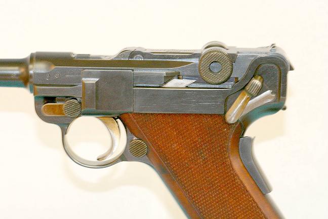

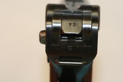

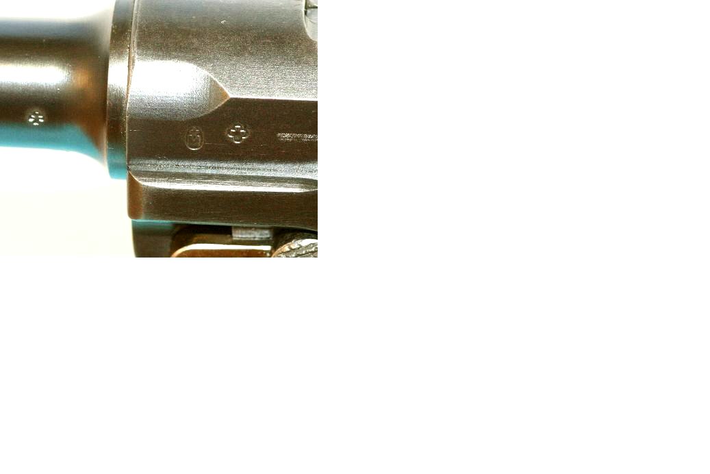

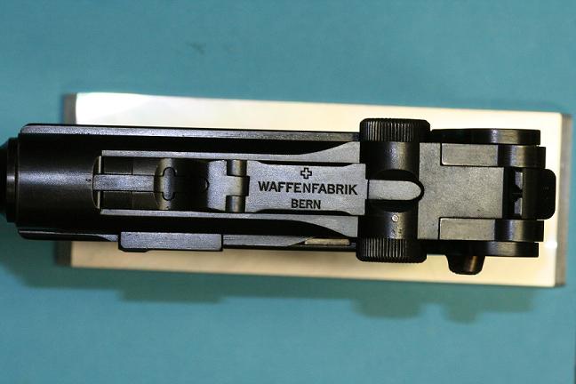

Unread 08-23-2005, 03:39 PM   #4
Chuckc
Join Date: Oct 2004
Location: Cave Creek, AZ
Posts: 68

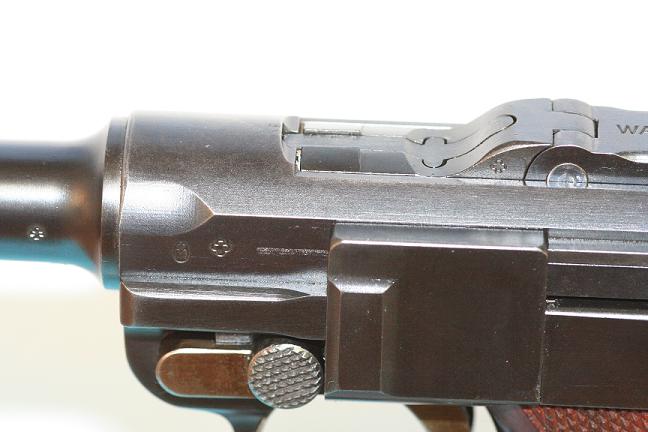

http://forum.lugerforum.com/lfupload...rn_9mm_003.jpg
http://forum.lugerforum.com/lfupload...rn_9mm_005.jpg
http://forum.lugerforum.com/lfupload...rn_9mm_002.jpg
http://forum.lugerforum.com/lfupload...rn_9mm_004.jpg
http://forum.lugerforum.com/lfupload...rn_9mm_007.jpg
http://forum.lugerforum.com/lfupload...rn_9mm_006.jpg
http://forum.lugerforum.com/lfupload...rn_9mm_013.jpg
I finally got some decent pictures and it took a while to figure out how to make them small enough to upload. I hope the pictures turn out. I was told the luger is pictured V. Bobba's book on page 145. I don't have this book yet/
Art in metal and wood
Chuckc is offline   Reply With Quote
Unread 08-23-2005, 05:16 PM   #5
Thanks: 1,120

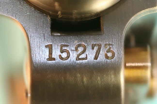

First of all, the designation â??06/24 Swissâ? is totally erroneous and I wish people would stop using it. The Swiss began tooling-up/producing their own Luger in 1917, with the first issue beginning in 1918. Since this Luger is of the 1906 pattern, the proper designation should be â??1906 Waffenfabrik Bernâ?, or â??Mod. 06 W+Fâ?, the official designation by the Swiss.
Your Luger is a VERY early production 1906 W+F. The serial numbering of these Lugers picked up sequentially after the DWM production with #15216, so your Luger would be the 58th produced by the Swiss. I find it very unlikely that at the beginning of production the Swiss would suddenly toss in a 9mm example. As Pete has pointed out, serious authors on Swiss Lugers have not indicated that there was such a variant produced. Since you do not have Bobbaâ??s book, I will tell you that your Luger is not shown on page 145, or any other page.
Other than the 9mm caliber of your Luger, all other aspects appear to be totally correct for an original Mod. 06 W+F, including the peculiar â??steppedâ? breechblock. I leave the determination of the authenticity of this piece to you.

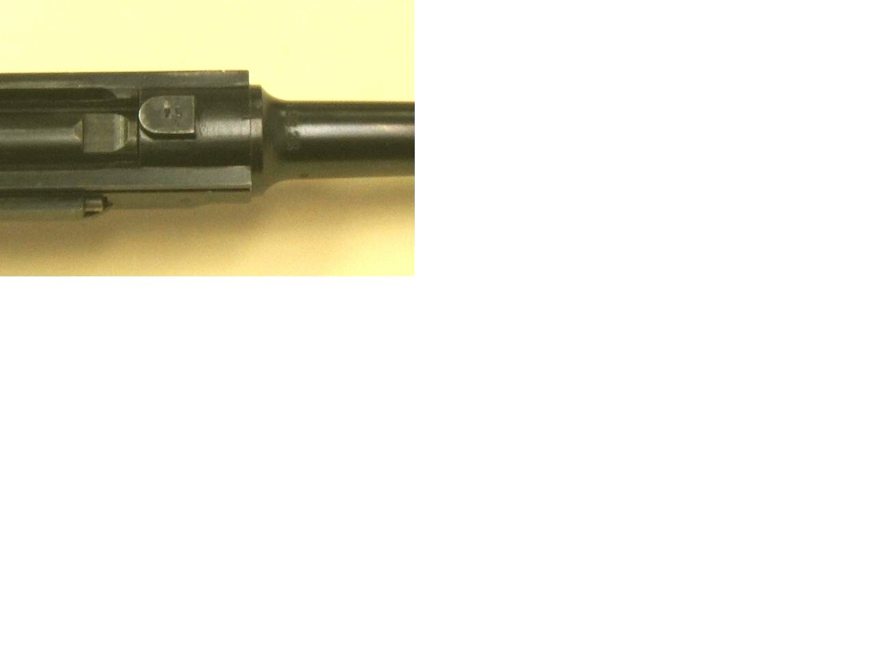

Unread 08-23-2005, 09:56 PM   #6
Hi Chuck,

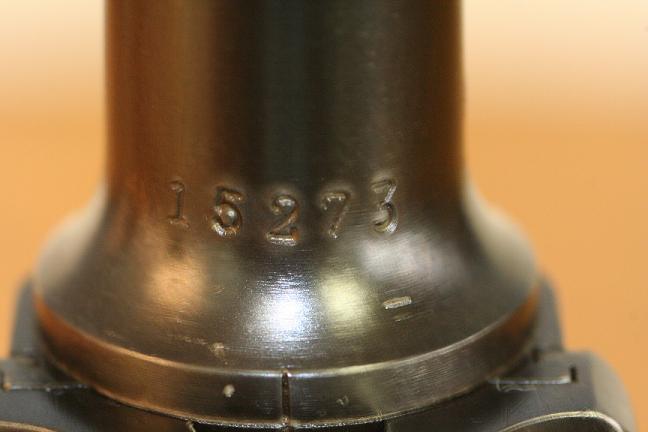

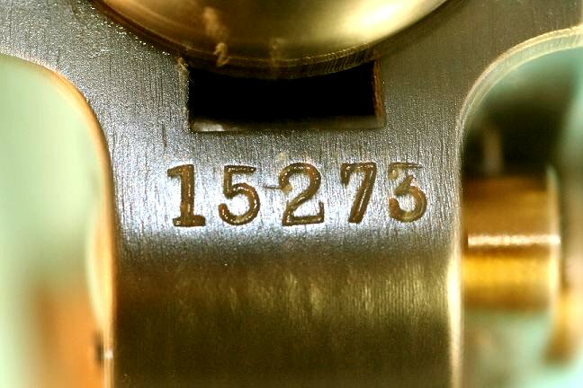

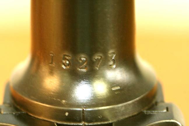

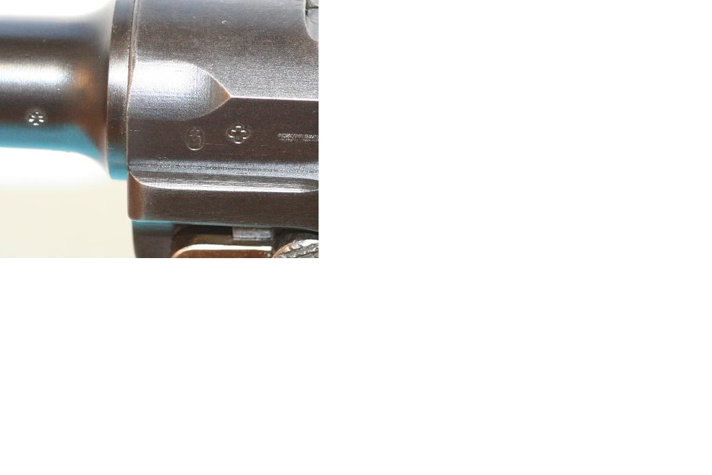

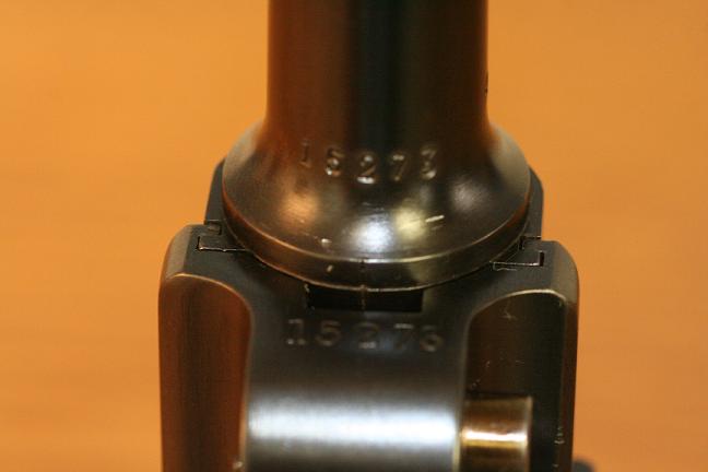

Is there a chance you can take four (4) really good, detailed, close-up and in-focus photos of :
1. The serial number on the barrel.
2. The serial number on the front of the frame directly above the trigger guard.
3. A photo of the underside of the receiver near the lug...where there should be a witness mark between the shoulder of the barrel and where is screws into the receiver.
4. The small Swiss cross on the left side of the barrel.
If you want to send me big jpegs, I would be happy to resize them for you and post them...send to pebbink@pacbell.net

Unread 08-24-2005, 01:24 PM   #7
Chuckc
Join Date: Oct 2004
Posts: 68

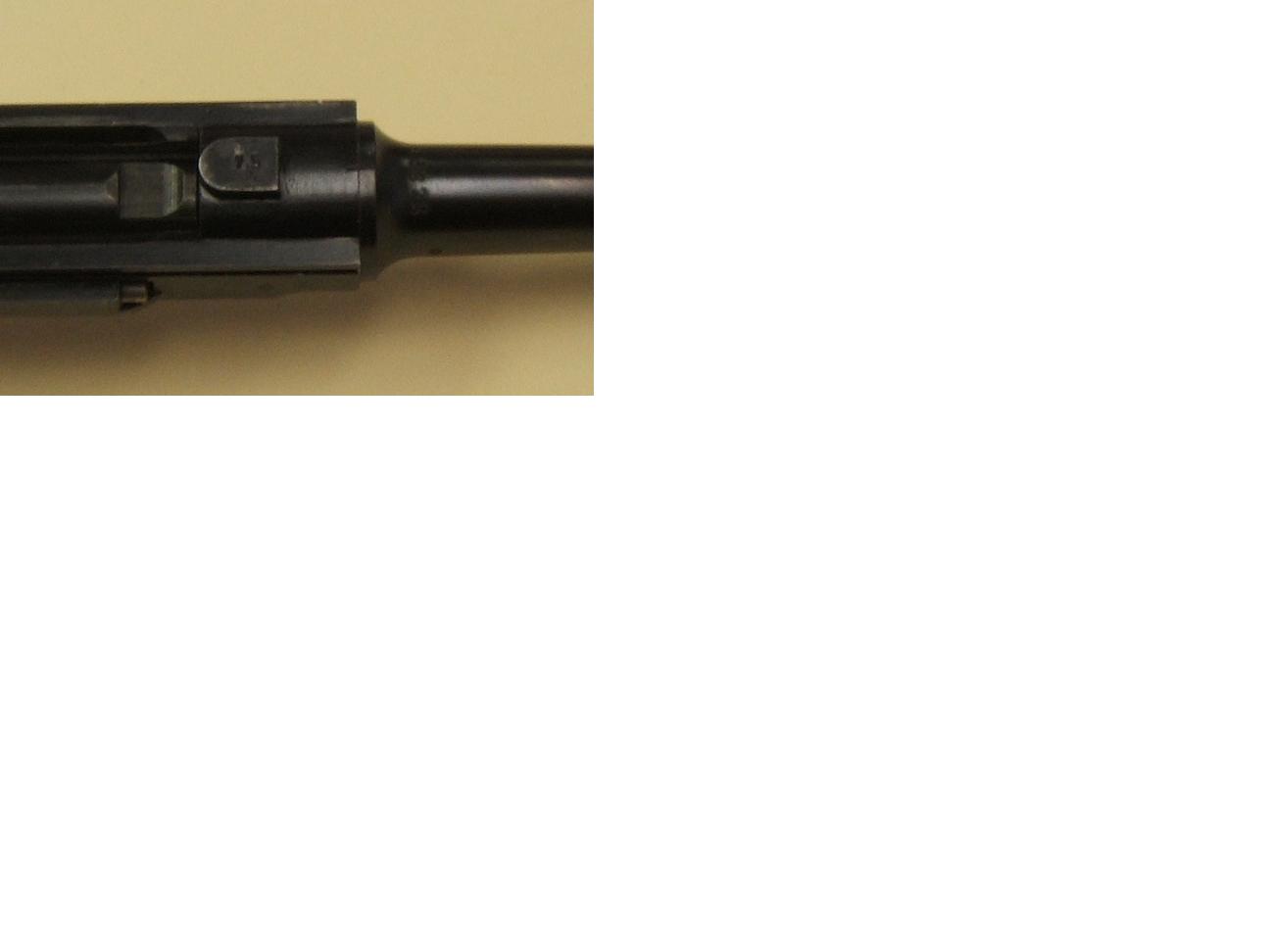

http://forum.lugerforum.com/lfupload...n_bbl_mark.jpg
http://forum.lugerforum.com/lfupload/1906_bern_012.jpg
http://forum.lugerforum.com/lfupload/1906_bern_011.jpg
http://forum.lugerforum.com/lfupload/1906_bern_014.jpg
The picture of the witness mark ? is poor as I lost my expensive camera. But there is nothing on the bottom of the receiver except the 75. No other marks are visable. I hope these pictures present what you ahve requested.

I called and asked for my money back on this piece. I was told it was authentic and was given two references to prove it was authentic. I was told with these references, it was worth a lot more than I had paid for it. And the money had already been sent to the person consigning it.
One reference has been commented on in this thread. To make matters worse I also purchased a 1914 Navy a short while before this Swiss. I submitted the Navy to another forum for evaluation. Check out the gunboards.com/luger forum and look at the new collectors submissions.
Between these two purchases, I am out a lot of money. I noticed an obvious lack of comments from members on this forum. You must all be laughing your behinds off at my stupidity. As I said on the other forum, any of you have a bridge you would like to sell? Or maybe a mint 45 cal test luger in serial number 1?

Unread 08-25-2005, 07:16 PM   #13
Thanks: 1,120
Nobody is laughing on either forum. We have all paid our dues for a Luger education, some of us quite expensively.
Your last set of photos was the final clincher. Since the receiver lug does not match the pistol, it would follow that the barrel is also an add-on.
By placing your Lugers on these forums you have contributed to the education of others, and we can only hope that, armed with the information you have received, your reward will come in the form of a refund from the seller.
Unread 08-25-2005, 08:09 PM   #14
I did not like how the "75" (or is it a "73"...?) on the barrel lug appears to be up-side-down, I did not like the different font of the barrel serial numbers and how those barrel numbers were stamped crooked. I cannot see any patina/oxidation along the gun's surface as well...
