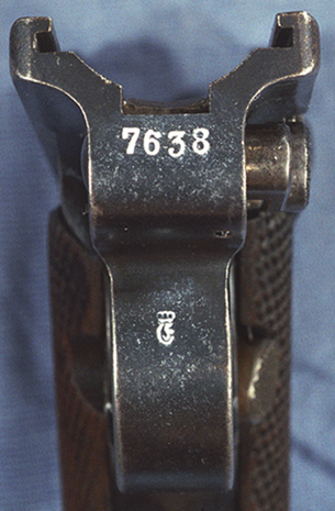

I am thinking of getting what is purported to be a 1918 Erfurt but I have some concerns. The gun is clean and appears to have all matching serial numbers except the trigger and it appears to be one of the earlier narrower type. The gun is virtually 100% blued in the places it is supposed to be blued and straw colored on the parts that are supposed to be straw. The two things that cause me some concern is the almost perfect blue job combined with the fact that is says Erfurt on the slide when the proof marks on the receiver match those shown in the "Technical Information" section, in "Proof2" as number 15, not number 16. (See photo) This would indicate a DWM Luger. Has anyone seen the mismatch of markings as shown in the enclosed photo or is this what is meant by "Minor Varients noted."?

"...is this what is meant by 'Minor Varients noted.'?"
This is what meant by "re-blued parts gun."
Seriously, though...the identification sheet is deficient in one respect which is important to you right now. The crucial difference in receiver marks is the difference in the proof eagle, which I have illustrated here:
An Erfurt-manufactured frame will have an inspector's mark on the front of the trigger guard:
If you go to this link http://forum.lugerforum.com/showthre...ghlight=Erfurt you will see a profile which clearly shows the panoply of marks one expects to see on an Erfurt Luger.
Let lus know what you determine.

Dwight, I tried to add a photo to my original post but I must have done something wrong. I will try again with a smaller file with a size less than 1100x1100. Hopefully you will be able to see the proof marks then. Also, the only mark on the front of the trigger guard is a small script "h".

What you have pictured here is definitely a DWM receiver holding an Erfurt toggle train. An additonal characteristic, which is just out of your photo, is the front edge of the top of the receiver. All Erfurt receivers after 1914 were cut with a flattened area for an Artilley rear sight; DWM did not follow this practice.
On the frame, if the script letter is right under the serial number, it is part of the number itself--the letter suffix. If there is not a crown/letter directly on the front of the trigger guard it is not an Erfurt frame.
I suspect that you understand this, but if you are looking for a collection-quality Luger this is not the one.
