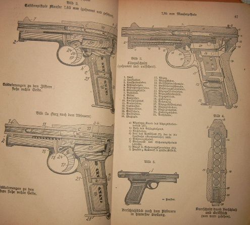

on the icture is a Mauser Armorers manual from 1928 Hauptmann Schmitt:
the same G.van Vlimmeren has:
http://forum.lugerforum.com/lfupload/simg0001.jpg
http://forum.lugerforum.com/lfupload/simg0002.jpg
and a 20 page original Pistol manual for the 6,35 and 7,65mm pistol
"Mauser - Selbstlade - Pistole" Kaliber 7,65 mm (und 6,35mm neues Modell)
http://forum.lugerforum.com/lfupload/simg0004.jpg
http://forum.lugerforum.com/lfupload/simg0003.jpg
very interesting with that systems Mauser Pocket pistol is that they are the only specimen keeping theyr slide open by firing the last round in 6.32 mm
no other pistol in that small caliber does have that feature as far I know ? !
Another interesting detail is that the slide is closed automaticly by inserting another magazine.
They have a magazine safety that allows not to be decocked without a magazine.
pisto is offline   Reply With Quote
